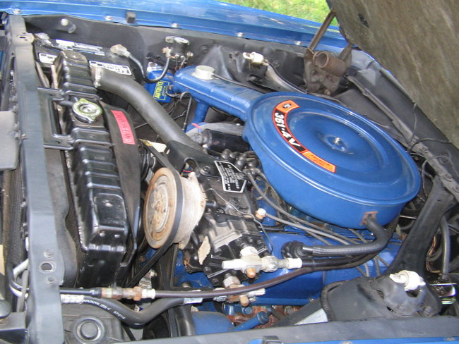

Hello everyone, so I went to crank up my car today after just getting back from basic training, put new gas in with some seafoam, and went to crank it. Had to of course jump it with my jump box and it will stay running only if I keep my foot on the gas the minute I let off it sounds like an automatic gun going off and shuts off if I leave it running without pressing gas it will crank then shuts off. Is it just fuel starved, carburetor need adjustment, I don't know.
Tuesday, June 16th, 2020 AT 12:04 PM
19 Replies

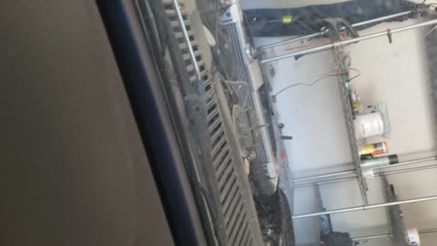

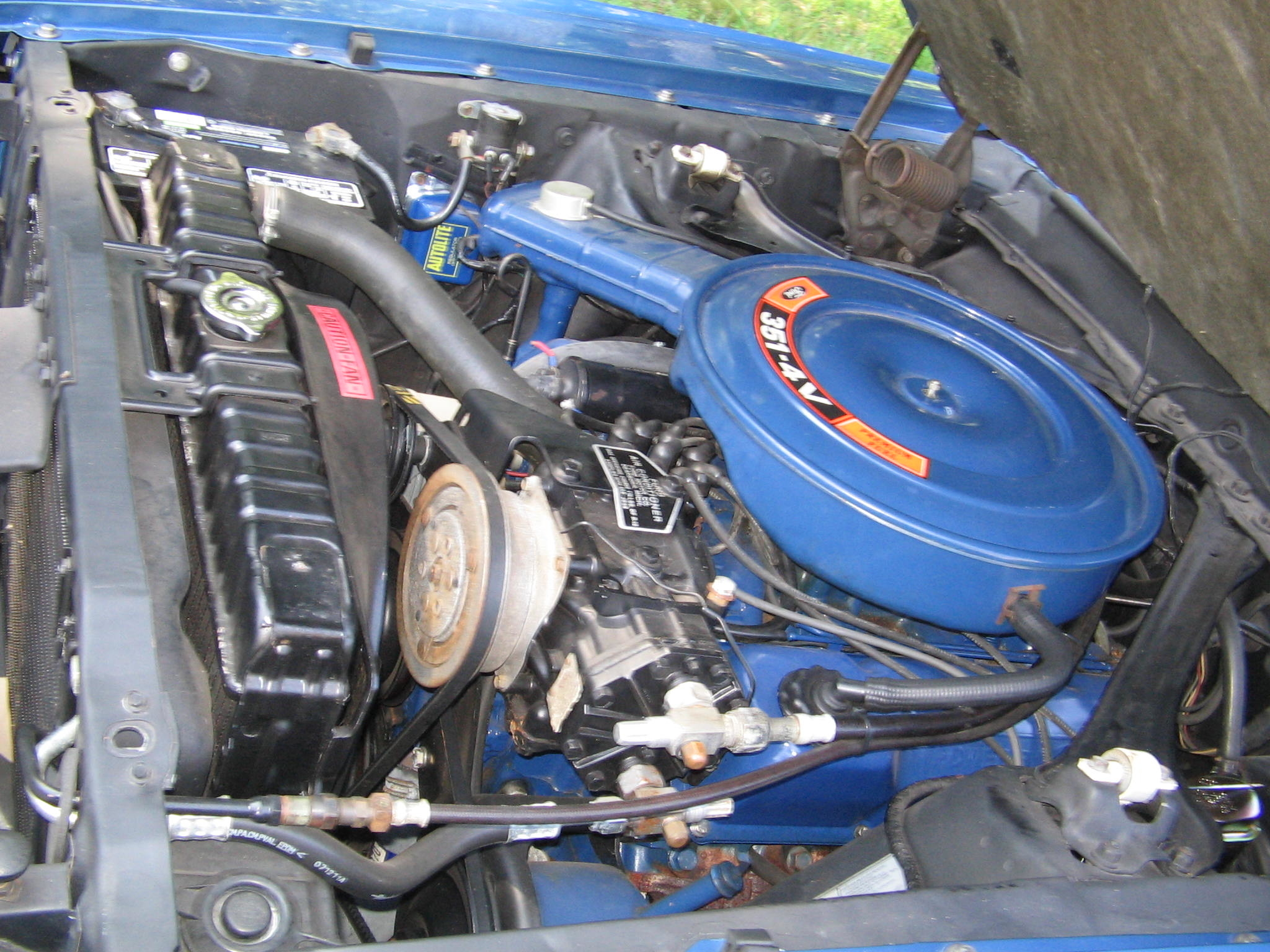

I think you are on the right path that is most likely an air/fuel ratio issue however, if this engine is cold, it looks like the choke is wide open. Is that true or am not not seeing this correctly?
If the choke is wide open when the engine is cold then it is going to stall out. My father in law has a 1956 Lincoln and his starts and stalls just like this when the choke is hung open.
Before you adjust anything, see if you can release the choke and it shuts and then start the engine and do not use the accelerator and just see if it idles. If it doesn't then hold it with the accelerator so that it doesn't stall until it heats up and once it is warm if it keeps running then we need to adjust the carb and choke for cold operation.

Finally got around to trying that today. After I did that it ran longer and I I thought it was fixed but shut off again. Then went back to doing the same thing. If I press the gas with the car off a few times it cranks right up and runs for a little while and shuts off. It runs noticeably longer the more I pump so I believe it to most likely be a fuel problem because of that but you are the expert. Just where my mind is at you know.

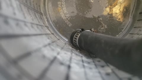

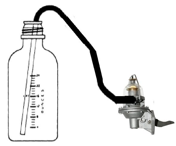

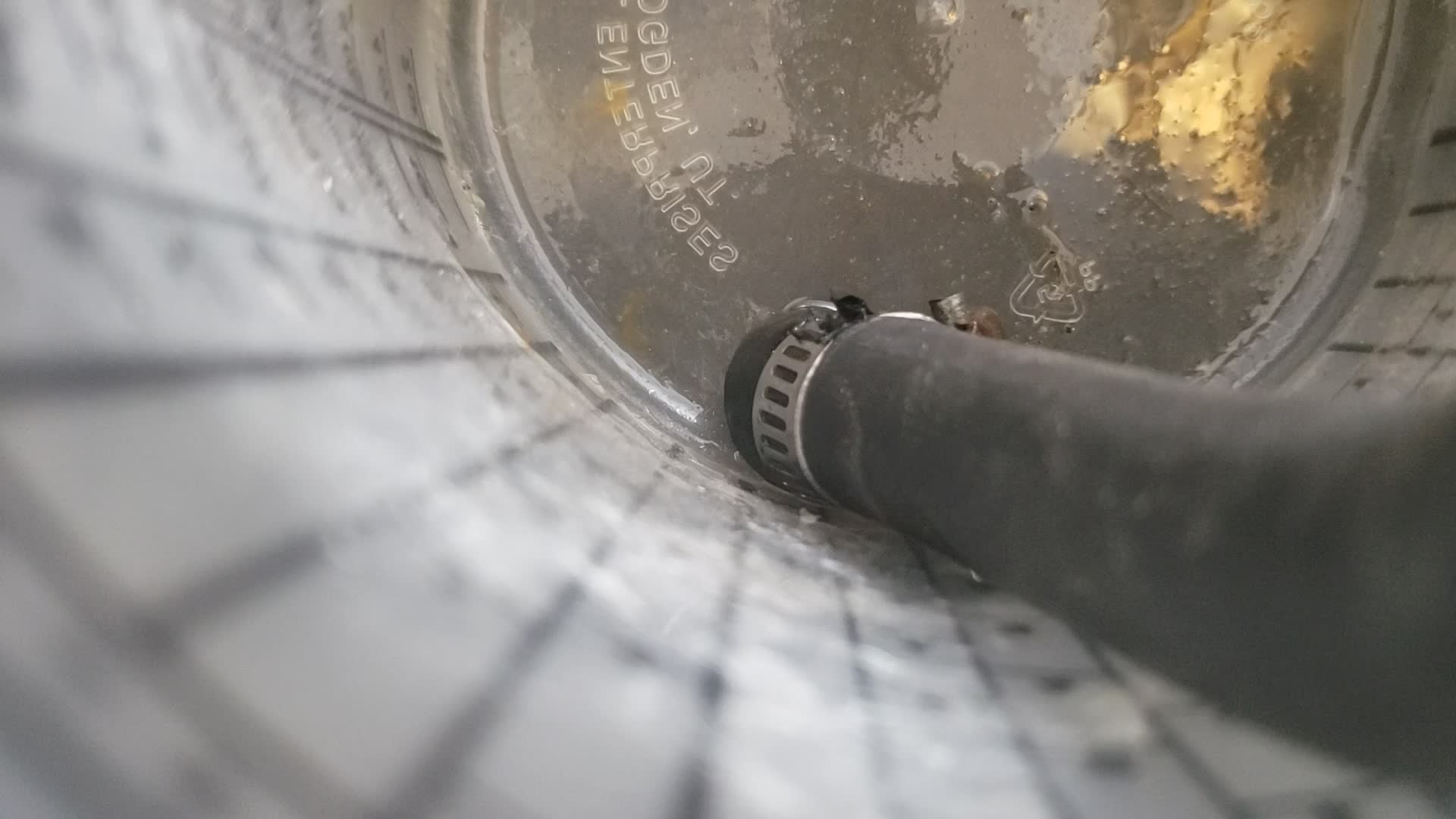

Next thing to test might be the fuel pump output.
Take the fuel input line off of the carburetor, and put it into a jar (or something that will hold a half gallon and also be see-through).
Turn on the fuel pump for 30 seconds while monitoring your jar as not to overfill it.
Shut it off after the 30 seconds has passed (or if it gets too full!)
Without any specs for the electric pump, a mechanical pump should generate at least a pint of fuel in the 30 seconds.
If your electric pump is not pumping, at minimum, the same as a mechanical pump would do, you may have a pump problem.
My pic shows the test process, the pic is showing a mechanical pump (pic I had on hand).

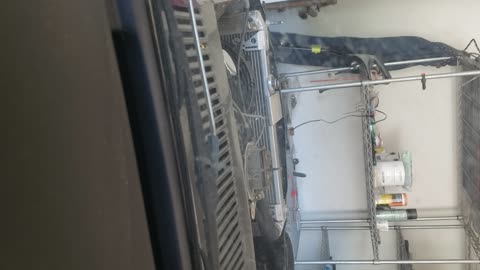

I honestly couldn't remember if you said 15 or 30 seconds so I did 15 and recorded it. It did 8 fl oz in 15 seconds so 16 in 30 which is a pint. I've attached a video as well.

Fuel video.

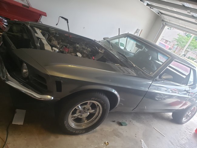

So when you told me to test the pump I continued to pump some more by accident and somehow the wire for the electric choke came off and it stayed in the position it was in the entire time which was about 2 inches from being closed. If it was completely closed it wouldn't stay running and wide open same issue. So I adjusted the screws again like you suggested and also took a piece of metal wire to all the jets just in case and it ran again. Currently in the process of converting from electric to manual choke like you suggested in your link.
