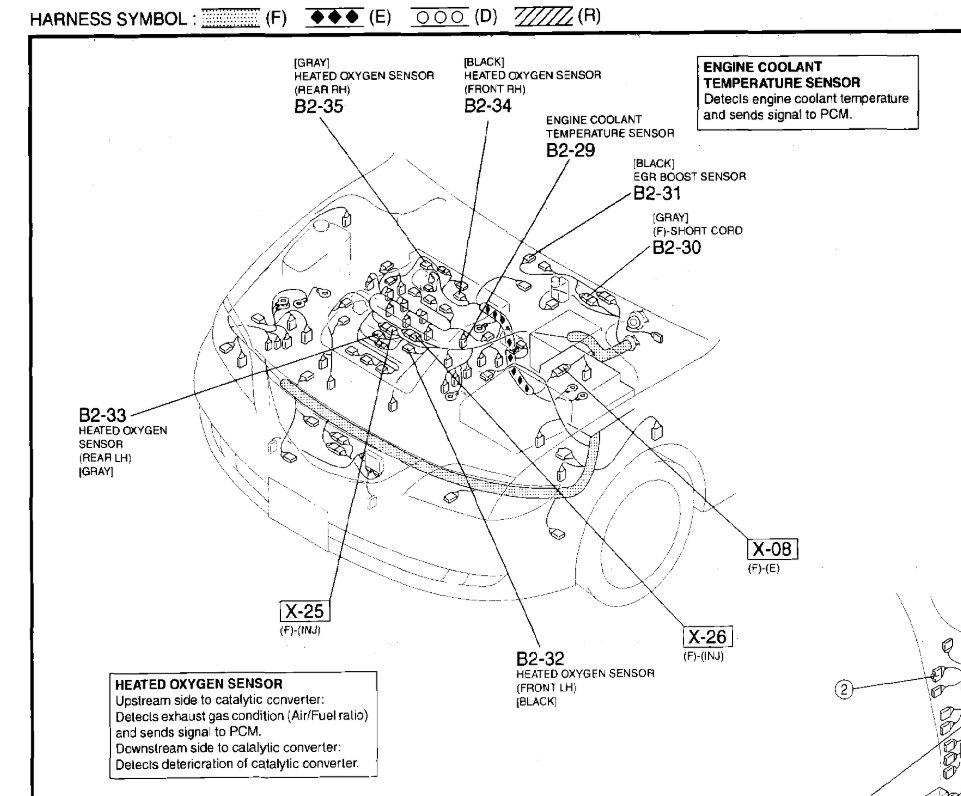

It sounds like the coolant temperature sensor is shorting out when cold which is common. here is a guide to help you change it and the location of the sensor for your car below:

I will check it out. Why would the portable heater have any effect on this?
Monday, February 4th, 2019 AT 3:26 PM
KEN L
  • MASTER CERTIFIED MECHANIC
  • 55,127 POSTS
It raises the temperature of the area which helps the sensor unshort.
