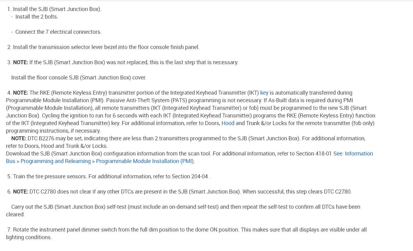

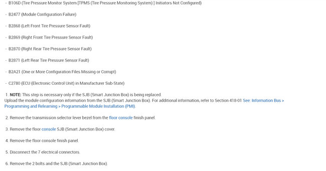

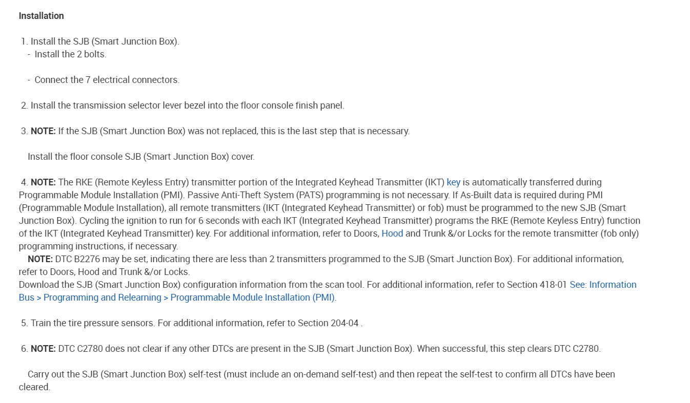

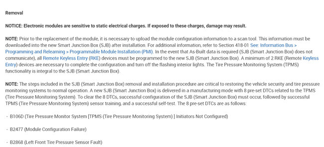

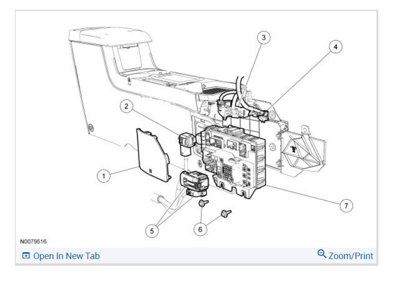

So, fuse #25 goes to the battery saver relay, which is interrogated into the smart junction box, which sounds like has gone out, which will cause the battery draw and the engine not to start. We should do a CAN scan which will tell us for sure, you can get a CAN scanner (Controller Area Network) from Amazon from about $32.00.

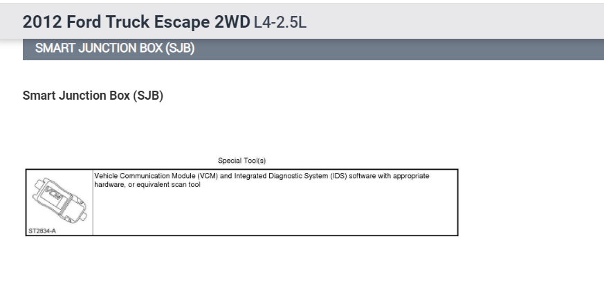

I have included how to change the SJB out in the images below in case you need them. Check out the images (below). Please let us know what happens.

Yep, just disturbing the SJB can make it go bad. You can see if the engine runs on starting fluid to help narrow down the problem in the meantime. Let me know what happens.

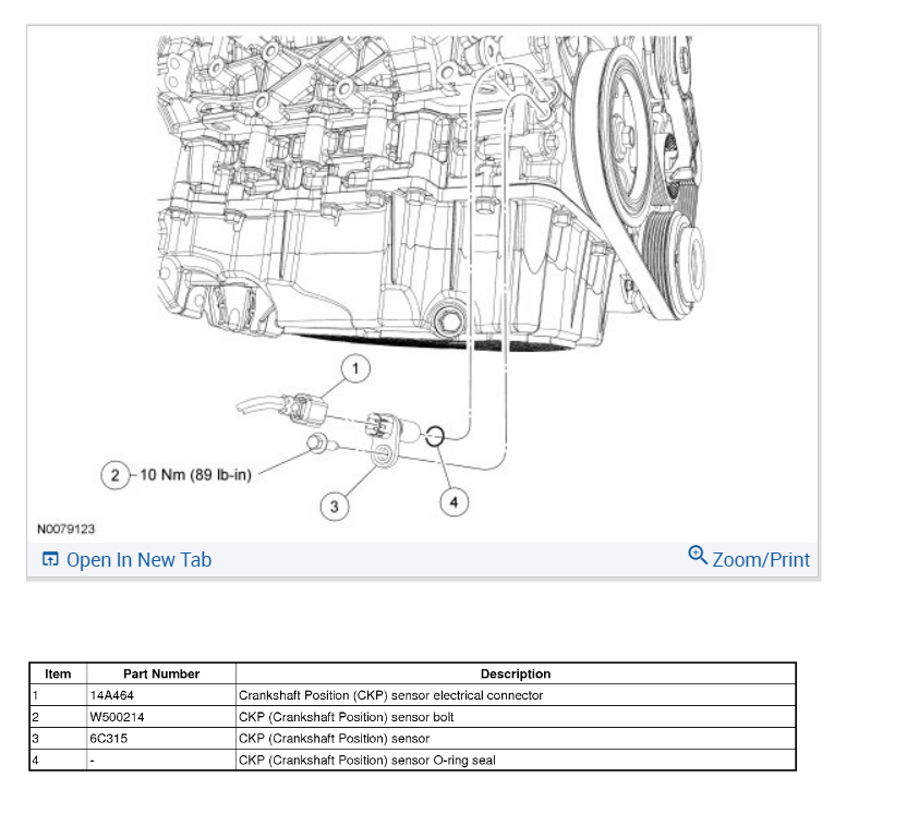

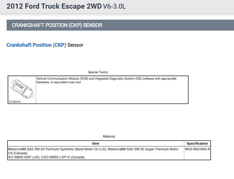

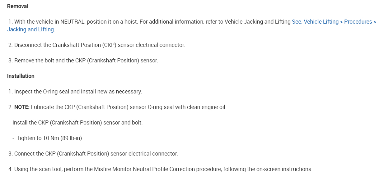

Does the check engine light come on with the key on? You used a CAN scanner? Usually with a no spark situation with no codes means the crankshaft angle sensor has gone bad.
This video shows the job being done on a similar car with instructions for your car in the images below in case you need it.

I swapped the crank sensor but there is still no spark unfortunately.

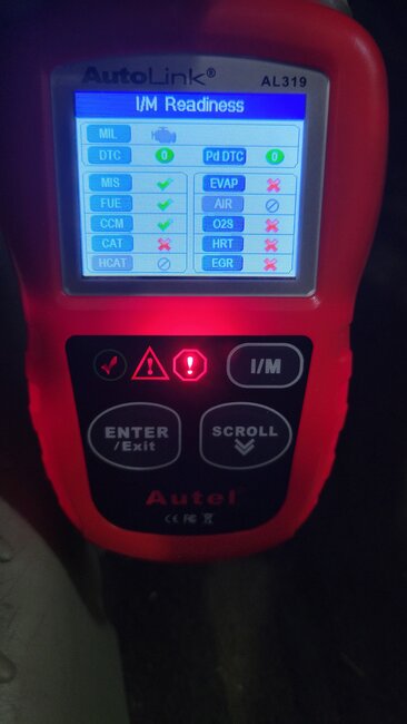

Sorry I missed one of your questions Ken. Yes, the check engine light comes on when the key is in the prestart position. Nothing in the cluster is out of the ordinary as far as the "dummy lights". The CAN scan never gives me any error codes, but the I/M test gives me the display screen I have attached.

Okay, these are monitors which the car must be driven through a few hot and cold cycles of the engine to set so they shouldn't be an issue. Sometimes the CAN scan will not pick up a bad SJB issue.
