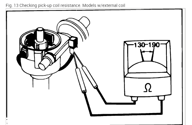

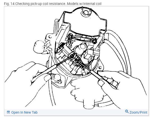

Additionally, if you have power to the coil and distributor, that leaves the pick-up coil. Have you checked it? If not, take a look at the pics below. They explain how to test resistance in the pick-up coil. There are two different designs. Pickup coil resistance should be 130-190 ohms. Check this and let me know the results.

I have an external coil, which screws do I touch to test continuity? The one on the outside with both probes by the vacuum diaphragm? Or the two internal screws holding the pickup coil to Distributor?
John
Wednesday, February 15th, 2023 AT 12:58 PM
  • 110,194 POSTS
In this case, you need to touch both of the wires with the test leads. (One wire with one test lead and the opposite wire with the other). You are checking to see how much resistance is occurring within the coil. Do it at the connector if possible.

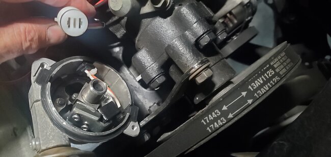

I did it at this connector.
.529 k ohms so 529?
Wednesday, February 15th, 2023 AT 7:25 PM
JBANDCO7
  • 7 POSTS
Plug connector.
Wednesday, February 15th, 2023 AT 7:26 PM
  • 110,194 POSTS

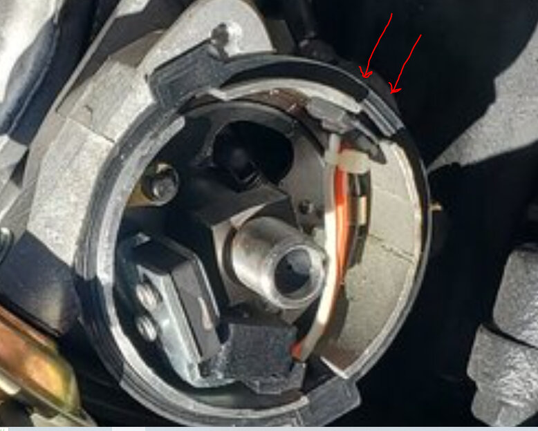

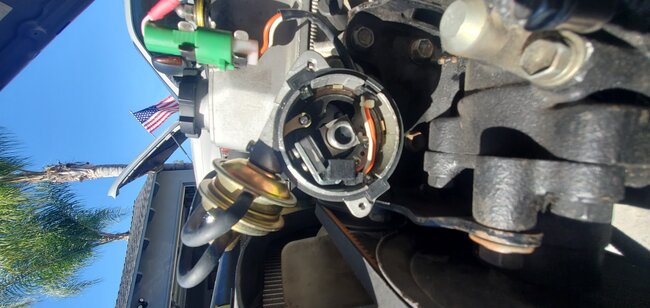

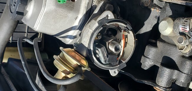

That is excessive. I looked at your pic. Are you checking the harness connector or the one that leads to the pickup coil?
Wednesday, February 15th, 2023 AT 8:54 PM
JBANDCO7
  • 7 POSTS
I'm checking the female plug end which is connected to the pickup coil.
John
-1
Thursday, February 16th, 2023 AT 4:39 AM
  • 110,194 POSTS
Okay, I just wanted to make sure it was the PU-coil being checked. If that is the resistance you are getting, according to the manual, it has failed and needs to be replaced. The manual indicates it should be between 130 and 190 Ohms. You are well over 500.
