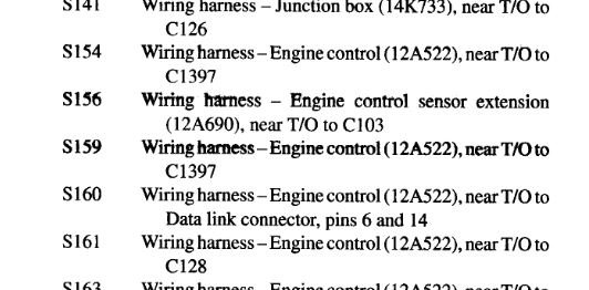

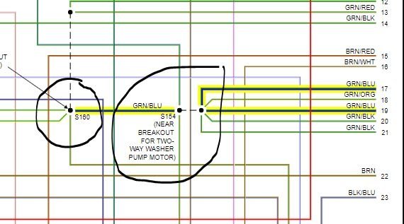

Are you still getting an RPM signal? If so, then we have to check if there is a problem with where all coils are spliced together. If you look at pic 1, it shows the splices. Pic 2 explains location. If there is no signal (RPM), replace the crankshaft position sensor.
If you have the RPM signal, check the splice. If it is good and the crank and cam sensors are good, there could be an issue with the powertrain control module (PCM).
