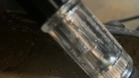

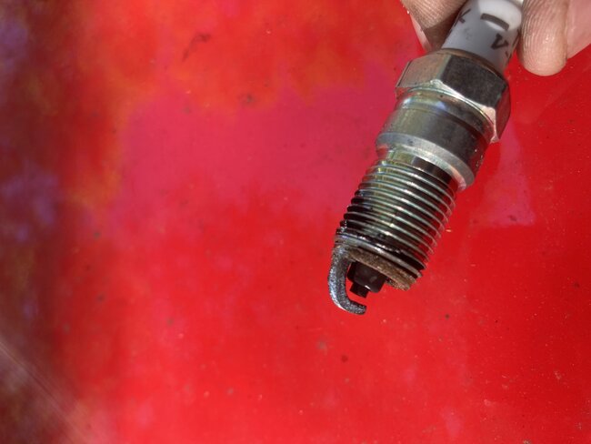

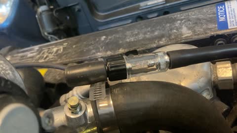

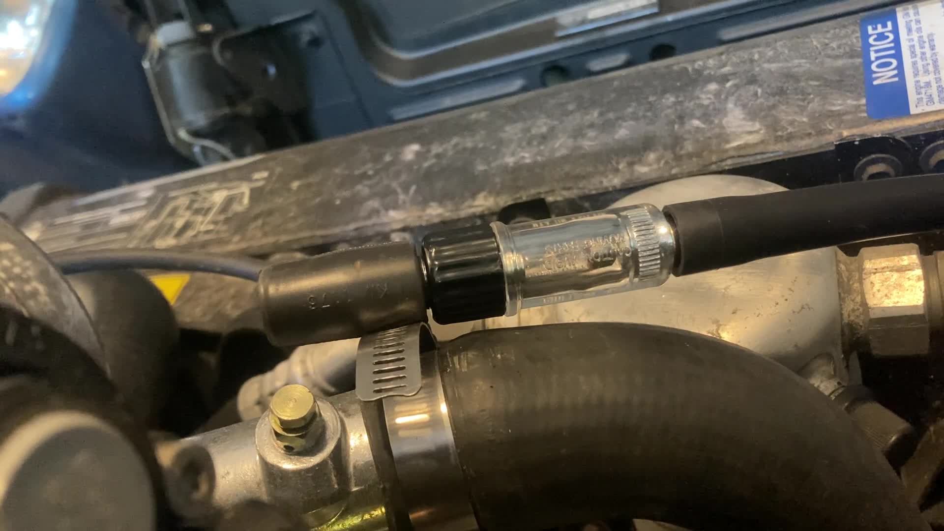

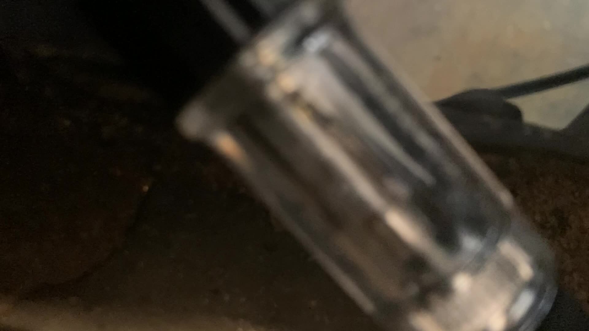

After I sprayed the starter fluid, it briefly seemed to start. Here are some videos of checking the spark at the coil and plug 2, along with a picture of a brand-new spark plug. The horizontal video is the Coil. I'll charge up the battery and check with starting fluid again.

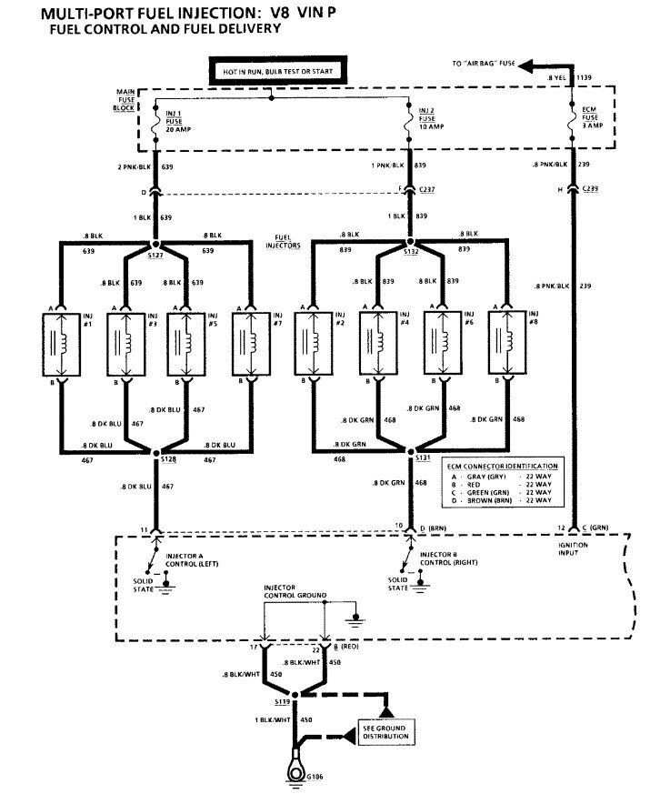

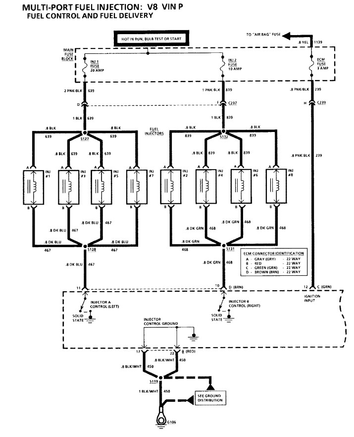

That spark should be fine. As it seemed to start on spray I would go after the fuel system. You have 45 PSU at the test port so either the injectors are not firing, or they are clogged. I would go to the fuse box with a test light and verify that you have power to both injector 1 and 2 fuses, then go to an injector on each bank and unplug one and see if you have power on the black wire. If you do then take a mechanics stethoscope and use it to listen to the injector, you should be able to hear a defined click as it triggers. If it sounds muffled or nothing at all the injectors need to be cleaned at least. That can be done by removing them and soaking the tips in a carb cleaner. Then test again. Or if you don't want to fight with them, just get a set of matched injectors and install them.

I ordered an injector cleaning tool from Amazon and discovered that only 2 of the 8 had power, indicating that I probably need new injectors. Since I wasn't obtaining fuel pressure before, I cleaned out the varnished fuel in the fuel tank and bought a new fuel pump.

If the lack of power was at the connector I would check the harness, corrosion in a connection could stop power out to the injectors.

I tested the injectors out of the car with 12v via a battery using the tool and only 2 would pulse and spray fluid. So, you’re saying to check for voltage on each connector for the injectors on crank/key? I should get new injectors also, correct?

Okay, if you tried them out of the car and they failed I would replace them. I would also check the power feed to each one just to be sure that it was the injectors failing and not that there is a problem now from that failure. I have seen shorted injectors cause a driver circuit failure due to the higher current from the shorted parts.

Fuel injectors were the issue got it running. Thanks Steve.
