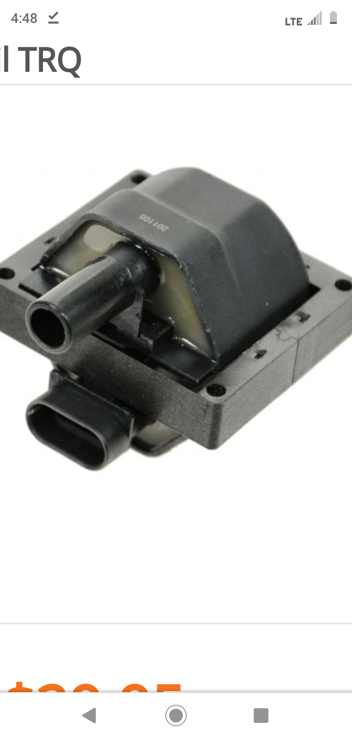

I have the same problem but my injectors are firing but no spark. New distributor new coil and module.

Same truck like SIMPERFI84. I did a upgrade camshaft with all new sensors I have 12v and ground to all connections, but from the coil to a ground or light tester no spark.

Okay, test for power to the positive side of the coil. If you have power, then use the test light on the negative. You should have power there as well. Then have someone crank the motor. With the test light on the negative side. The light should flash with the engine cranking.

On the connection to the coil I have 12v on with the key on hot and the negative side too.

Okay, crank the engine and see if the test light flashes.
