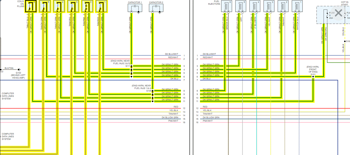

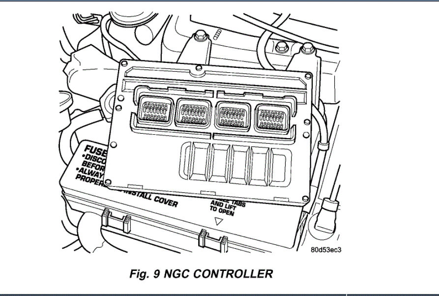

I checked both wires on each coil connector and they are both getting 13 volts. Is that normal?
Saturday, August 29th, 2020 AT 12:23 PM
LOREN STOVER
  • 130 POSTS
I checked positive wire coming from the coil on the plug and it showed 13 volts. I also checked the ground wire on the plug coming from the PCM and it also shows 13 volts. Is that normal? On all coils while the car is running number one two a number four coils are not firing in those cylinders, but when I switch them around they start firing.
Saturday, August 29th, 2020 AT 3:35 PM
  • 52,797 POSTS
Okay, it has power. The ECM is what grounds the wire back it based on the input from the crank sensor.
When you crank it, does the RPM go up on the tachometer? That will tell me if the crank sensor is sending a signal.

I attached the diagram of the coils to the ECM. You need to the wiring to the ECM to be sure there is voltage to the connector.

Sorry I'm not tech literate when it comes to circuits and stuff like that. But if I have voltage coming to the ground wire on all of the coils from the PCM which is 13 volts what does that mean?

  • 52,797 POSTS
No, the voltage goes to the ECM from the coils. If there is voltage there then the ECM is the issue.
Sunday, August 30th, 2020 AT 10:45 AM
LOREN STOVER
  • 130 POSTS
Let me see if I'm getting this right. So if there is voltage at the connector to the PCM then the PCM is the issue, correct? Because all of my coils have the same voltage on both wires and still 3 coils are not working.
Sunday, August 30th, 2020 AT 10:51 AM
  • 52,797 POSTS
Correct. The ECM inside circuitry is what controls the grounds for those 3 coils.

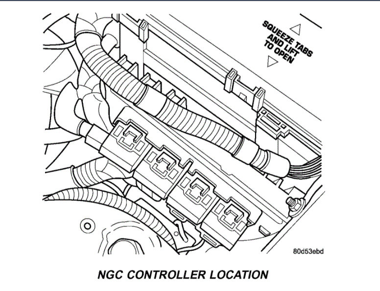

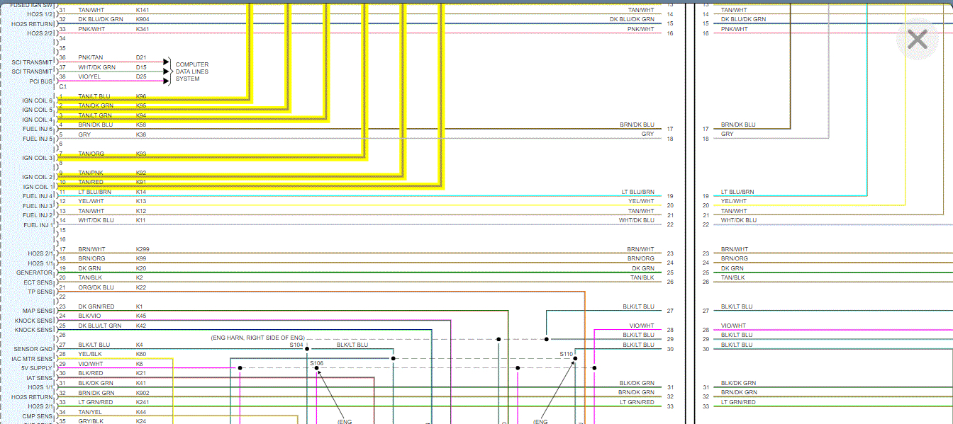

Okay. One more thing; is there a diagram of the plug I need to look at? Because all my wires are discolored from age.
Sunday, August 30th, 2020 AT 11:02 AM
LOREN STOVER
  • 130 POSTS
Sorry, I meant connector at the PCM.
  • 52,797 POSTS
I attached the diagram back a few posts and I highlighted the wires and the connector numbers for you.

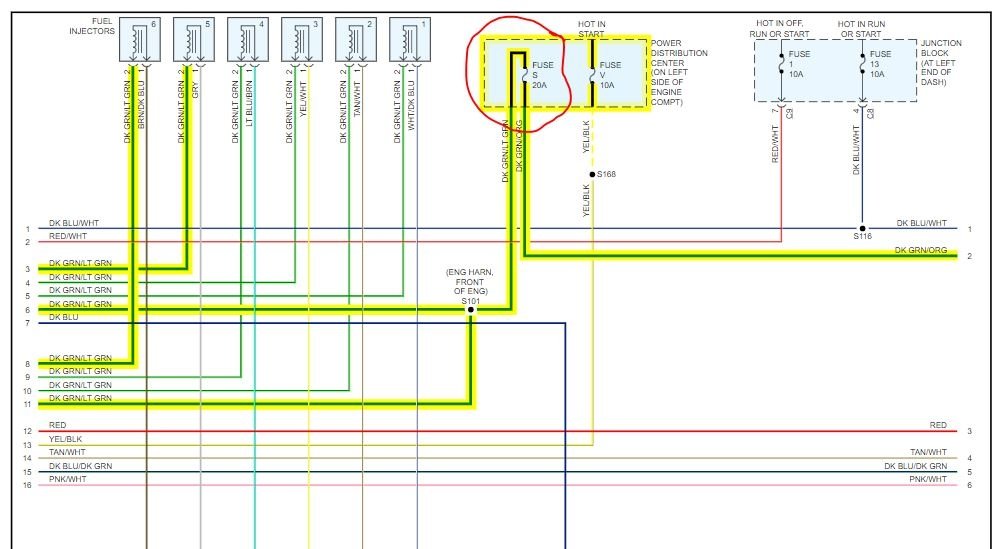

Do I need to unplug the connector to the coil before checking for voltage? I just realized that's where my voltage could come from on the ground wire.
Sunday, August 30th, 2020 AT 11:57 AM
  • 52,797 POSTS
No, leave it connected with the key on.
The voltage comes from the injector.

I checked all the power wires going to the coils and none of them have a 5 volt reference. What do I do next?
Tuesday, September 22nd, 2020 AT 12:37 PM
  • 52,797 POSTS
You need battery voltage to the coils, not 5 volts.
The power comes from Fuse S in the under hood fuse block. Check for power on both sides of the fuse.
