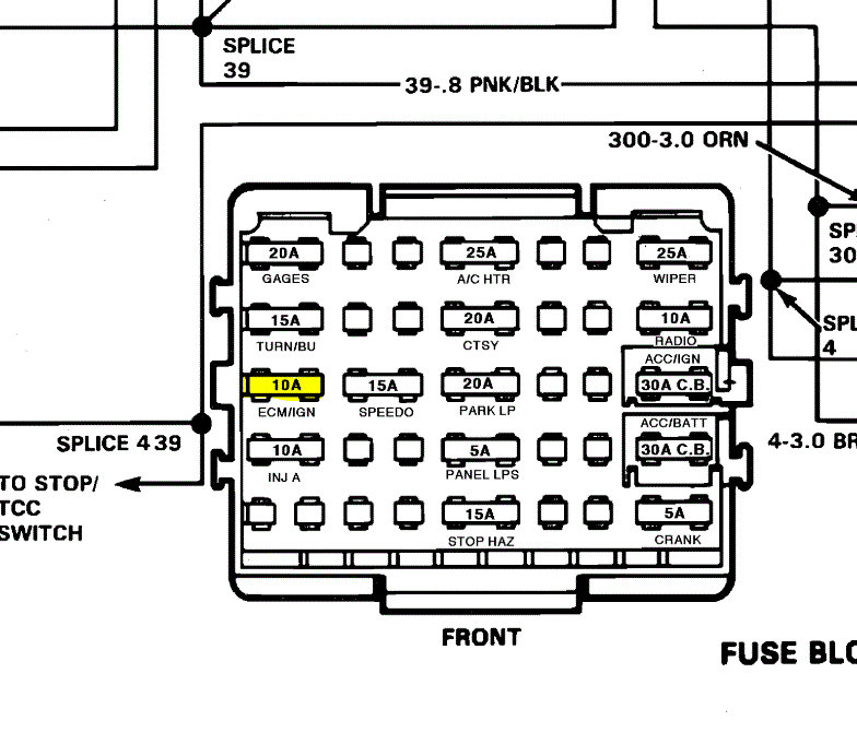

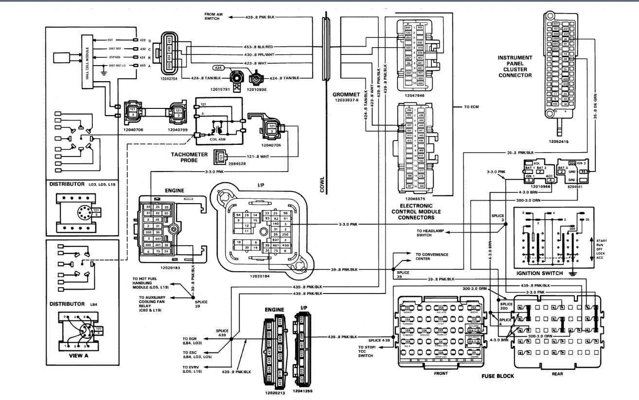

Also, I attached an OEM wiring schematic of the ignition switch below (pic 1). If you look at pic 2, I highlighted a fuse. Make sure it's good. If it is, make sure there is power to it.
Let me know what you find.

I thought that too, but it is indeed spinning. I also checked the fuses and all light up but what I did find is a manufacturer defect on my plug wires and all of them are arcing on the exhaust manifolds. So I'm going to replace them tomorrow and cross my fingers because I have literally replaced everything on the ignition side and everything but the actual fuel pump has been replaced on the fuel side.
Sunday, July 19th, 2020 AT 9:55 PM

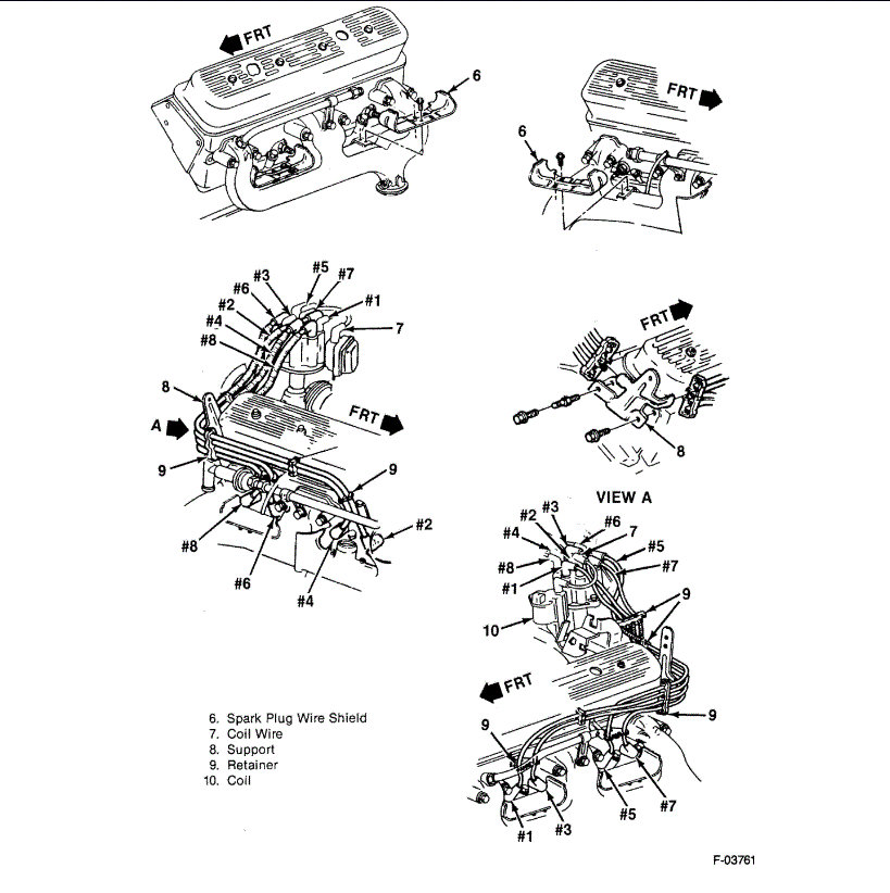

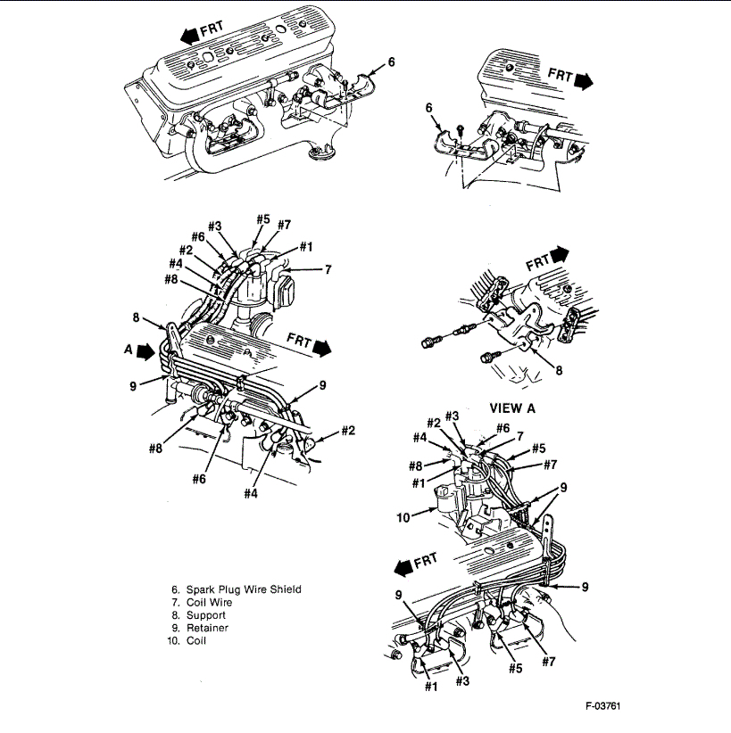

Let me know if that takes care of the problem. Also, I attached a pic below of the factory wire routing. I don't know if you need it, but thought I would add it in the event it would help.
Monday, July 20th, 2020 AT 2:17 PM

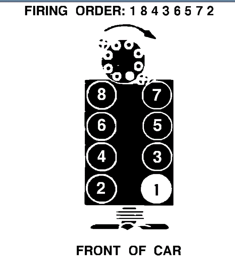

  • 110,194 POSTS
Wow, that doesn't sound good. Are you sure you didn't mix up the wires to the plugs? I attached a pic to help confirm that.
