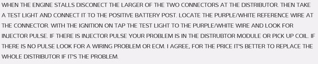

Fuel pressure should be 9-11 psi no lower. Scan for codes. If spark is not right injectors will not work. Check coolant sensor should be high resistance cold and goes to about 700 ohms when engine is heated up. Check resistance of pick up coil in dist. 400-1000 ohms. See pictures as well.
