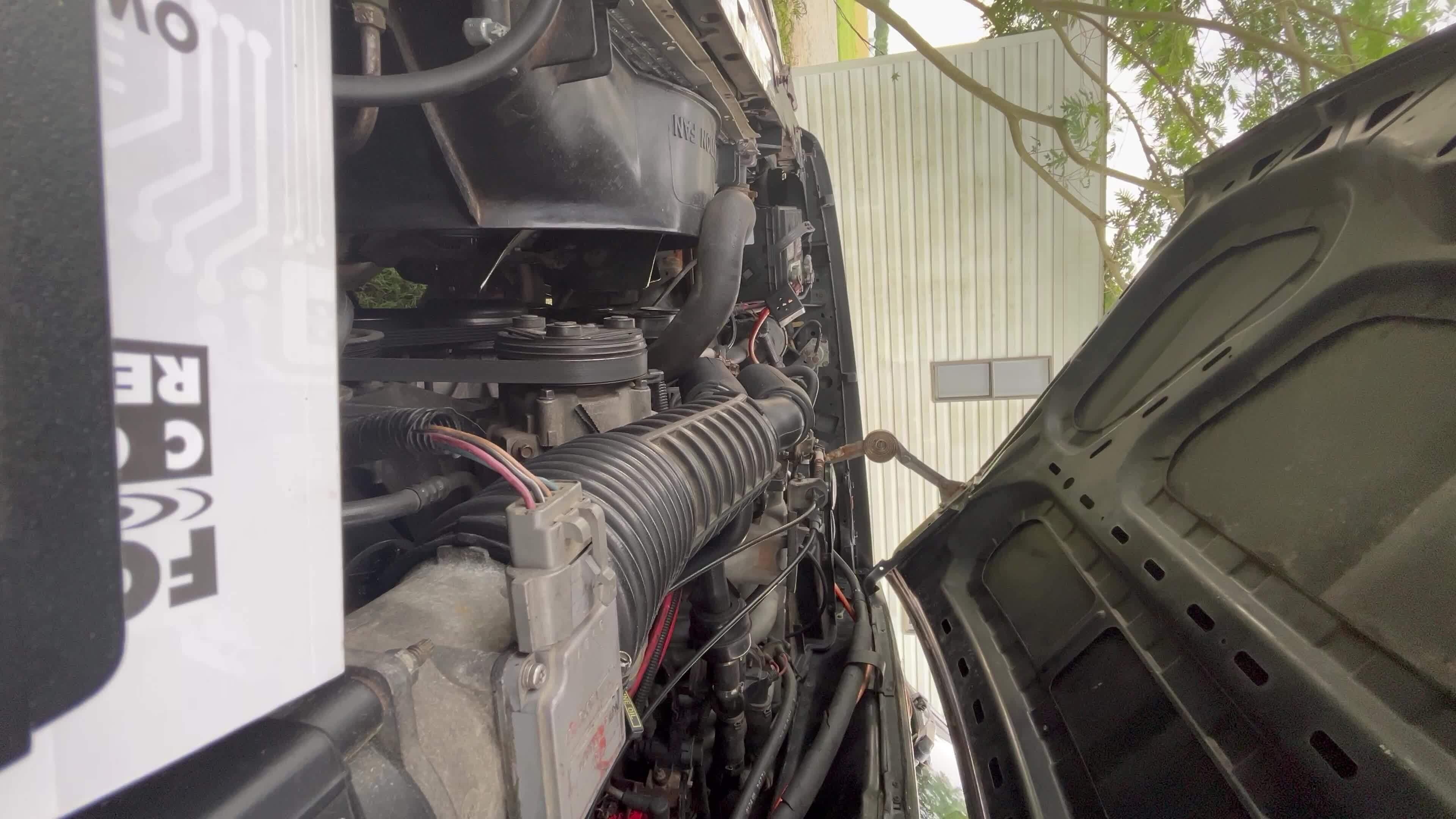

I have check the wiring everything looks good I have reset it, and it still does the same thing I scan it and there’s no code popping up it says it’s clear I just need to check the timing chain but I uploaded a video hope that helps. Thank you
May 14, 2025 at 7:34 PM
  • 54,503 POSTS

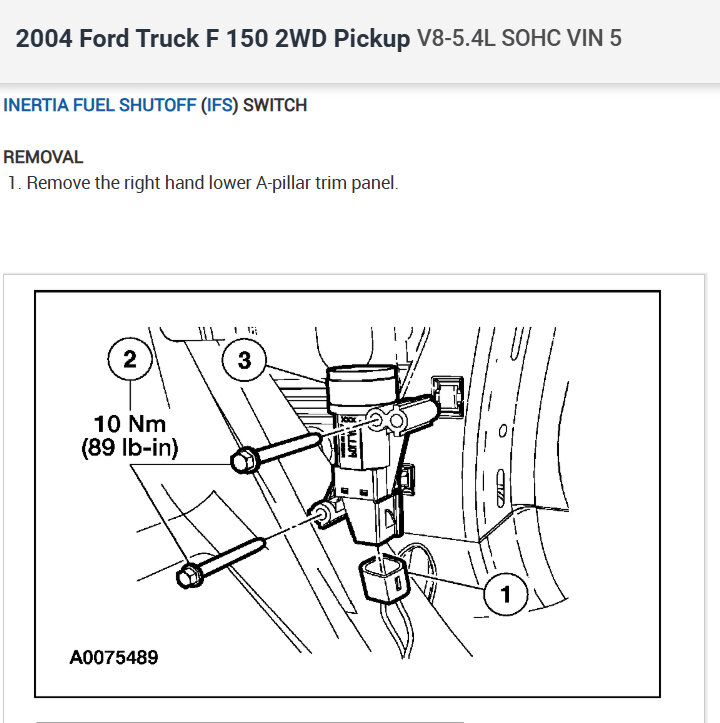

Thanks for the video, I can tell you the engine is in good shape and has good compression. I would make sure the ground wires at the bell housing are connected, also, check for spark like in the video and then use starting fluid to see if anything changes, also I would reset the inertia switch. Here is the location, push down on the button on top. Check out the images (below). Let us know how it goes.
