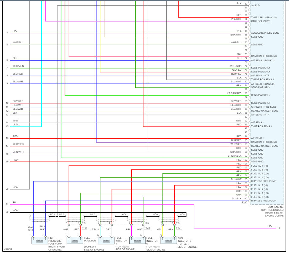

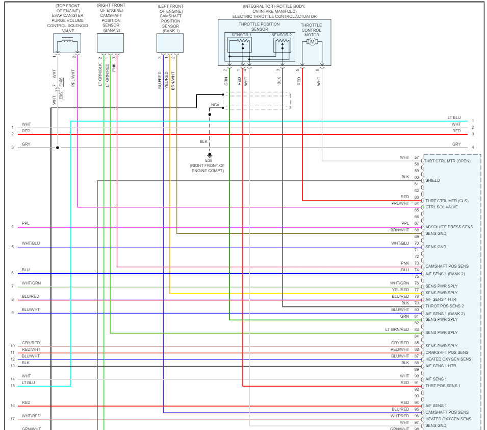

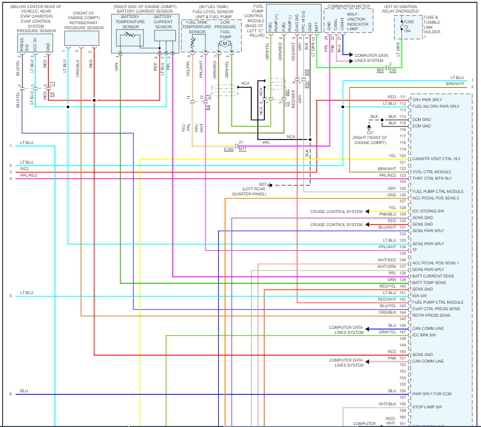

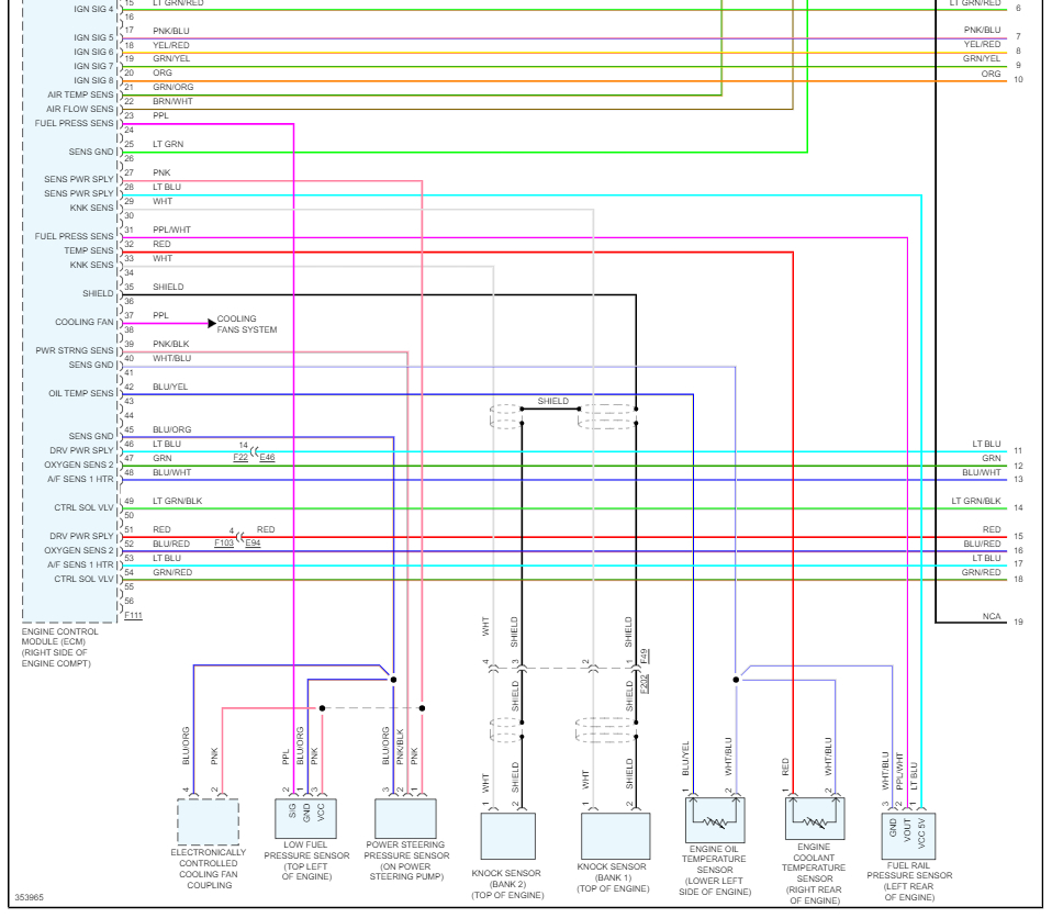

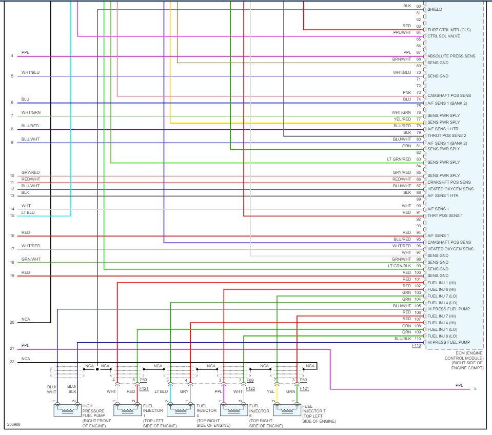

A new bit of information to add: the owners also replaced the crank sensor because of a p0335. This does not show up in the memory but that could also be from sitting for months. So, I thought to try tracing the problem beginning there, I have a diagram showing the 3 crank sensor wires going to pin #s 76, 86, and 98. However I do not have a pinout of the ECM side. Please let me know your thoughts and any advice.

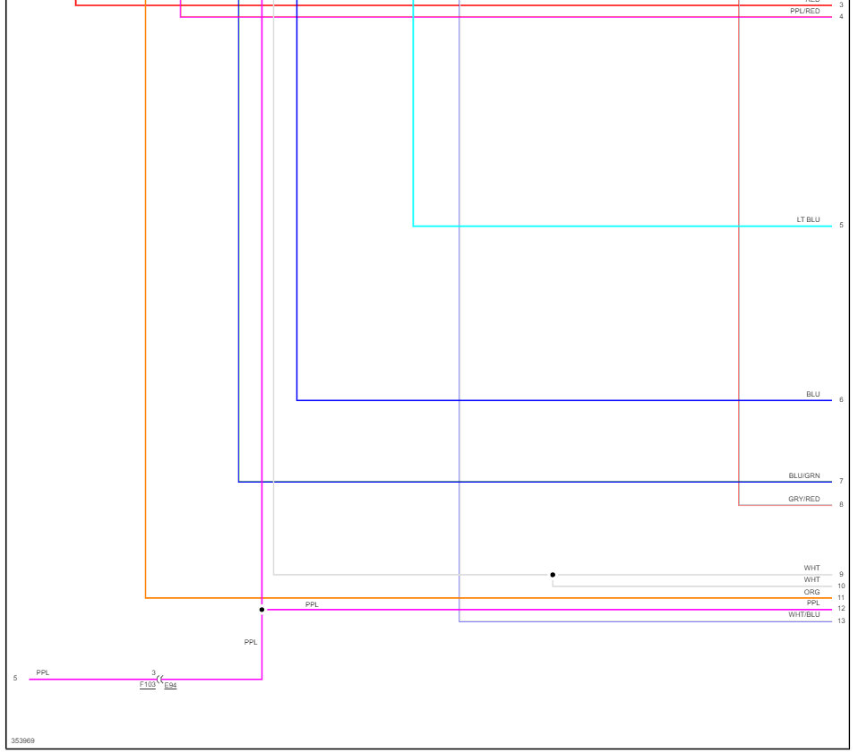

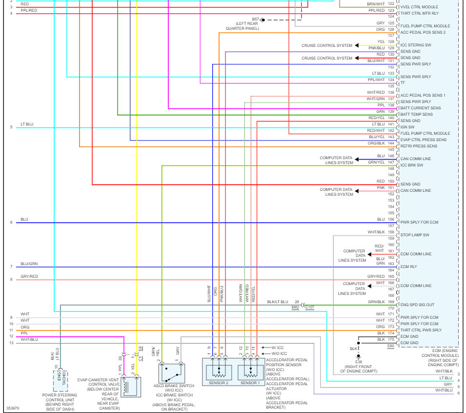

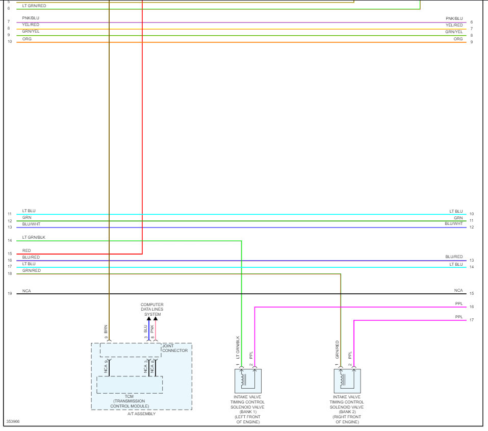

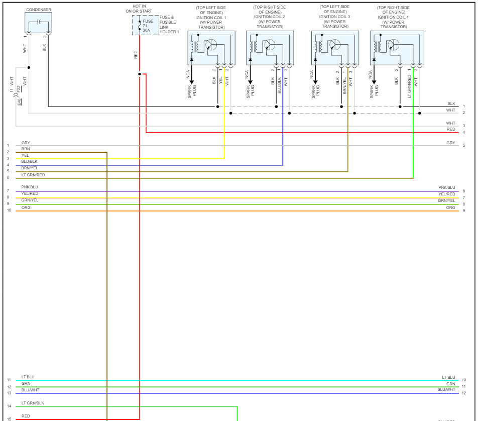

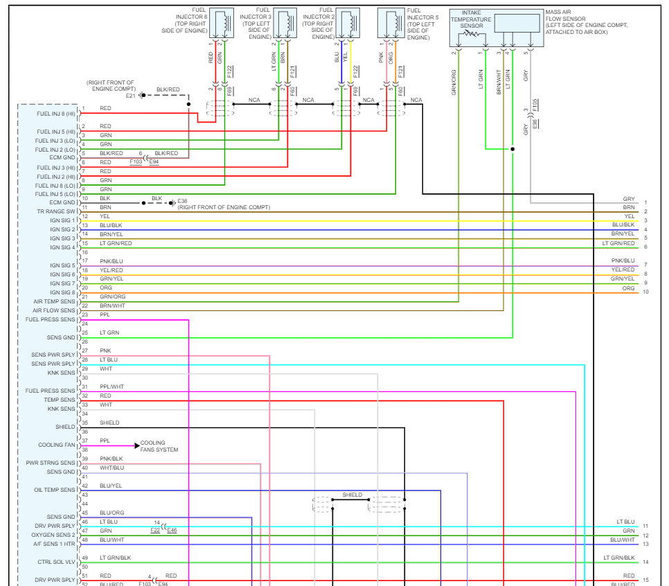

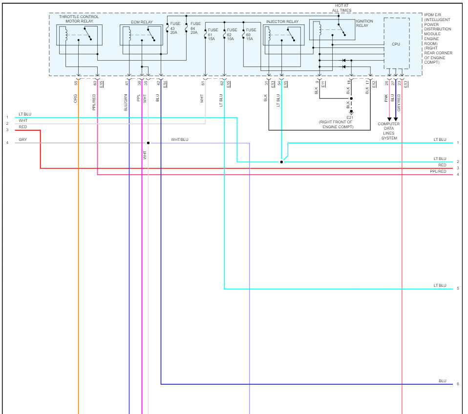

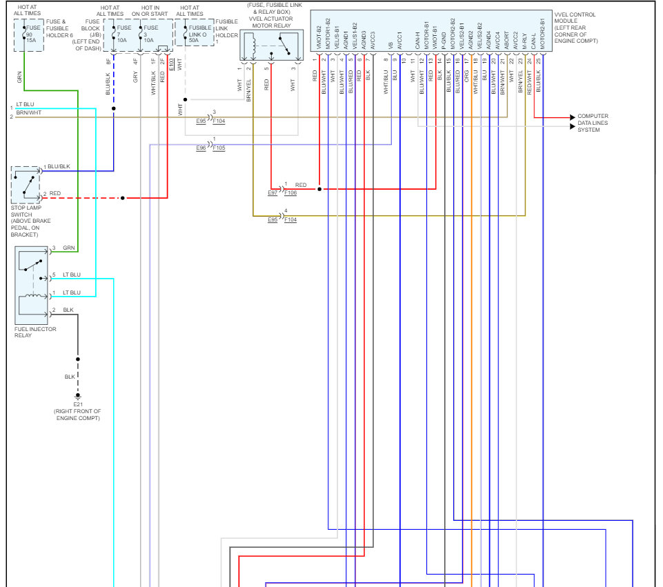

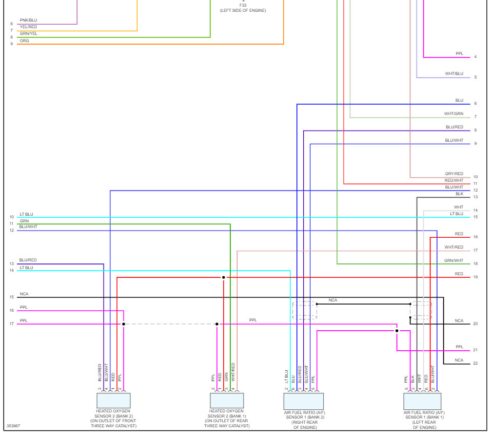

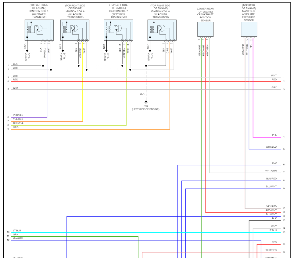

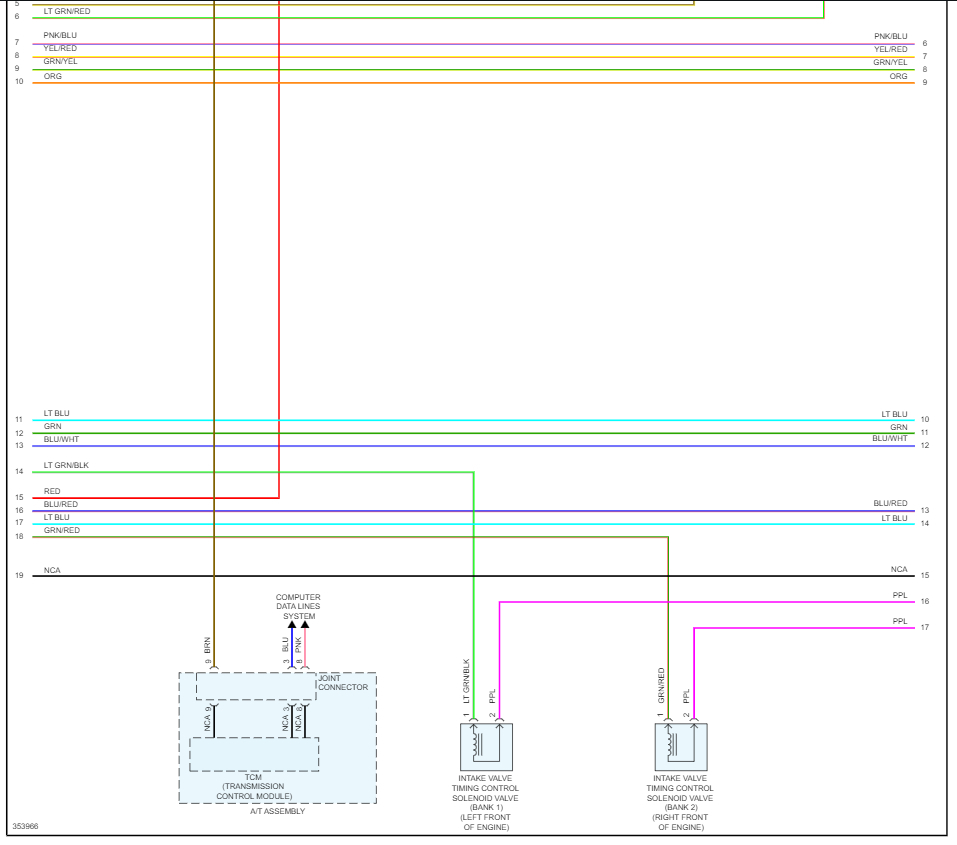

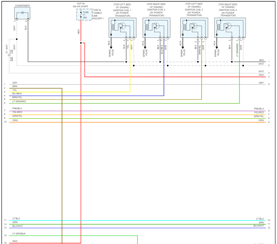

Here are the PCM wiring diagrams and a guide to help test the connections:
Check out the images (below). Please let us know how it goes.
Monday, July 24th, 2023 AT 11:40 AM

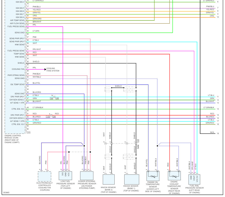

Hi, the car will not run on starting fluid. It definitely seems like a bad ground issue, because the battery will barely engage the starter at 12v. So, something is taking the most of the power. I probed the connector at the CKP sensor and got 5v, but OL reading at terminals 2 and 3. I got the same reading from the ECM connector side but maybe I was testing them incorrectly, so I'll try again tomorrow. Unfortunately, the distance between the CKP and ECM is too long for my meter. But I used the body as a ground to test resistance to the wires.
Another note: I saw no grounds in the wiring diagram for the CKP. Does this mean the 3 wires go straight to the ECM? Or does where each colored wire cross in the diagram indicate a connection path?
Once more: I tested the Camshaft position sensor, on top of the engine, and terminal 1 - 2 gave infinite resistance. Terminals 2 - 3 gave a resistance reading. Would this indicate a bad camshaft sensor? Sometimes the guides indicated the reading as "except 0 or infinite".

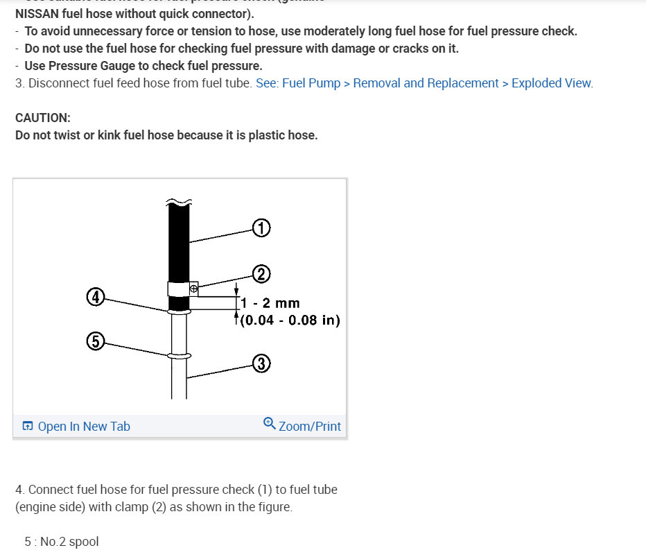

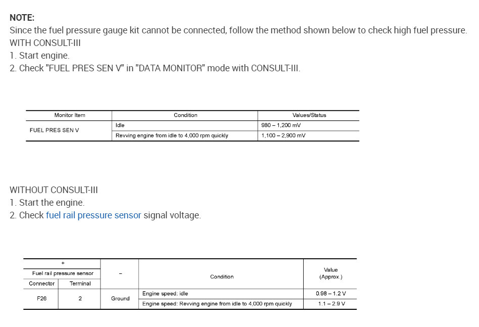

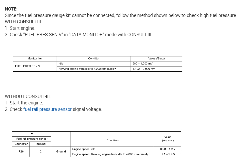

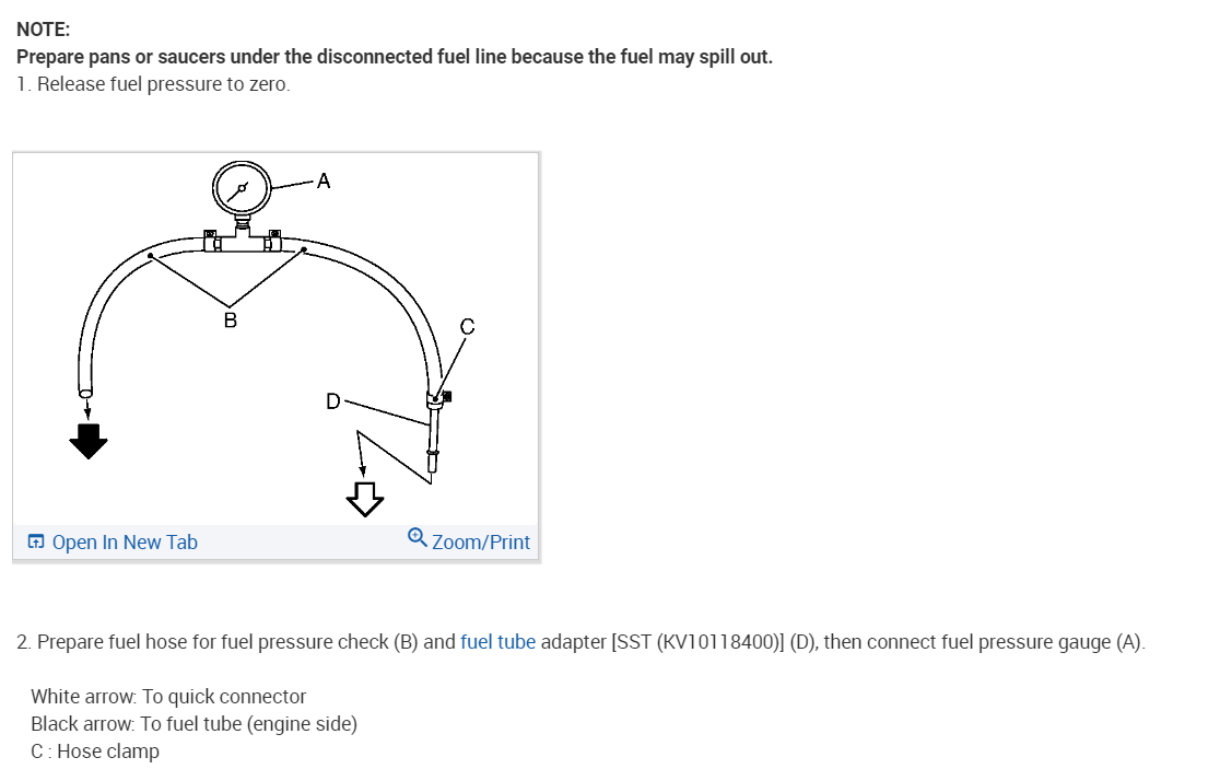

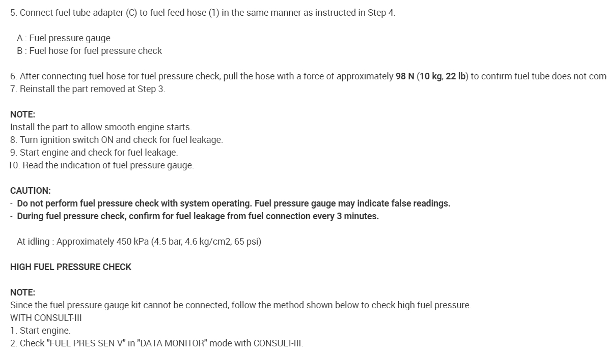

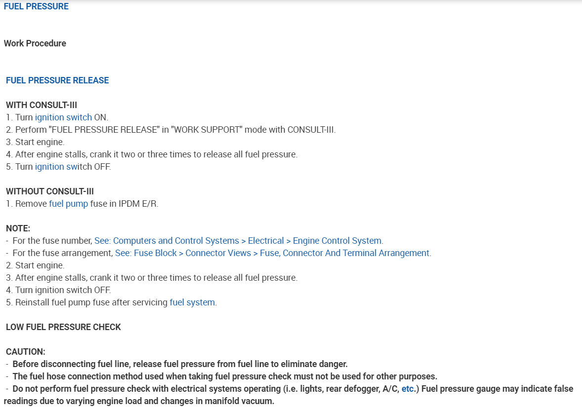

Yes, I would check the fuel pressure here are the specs and a guide to help walk you through the test.
Fuel Pressure (At Idling) .................... Approximately 450 kPa (4.5 bar, 4.6 kg/cm2, 65 psi)
Use can rent a fuel pressure gauge from the auto parts store for cheap. Please go over this guide and get back to us.
Tuesday, July 25th, 2023 AT 7:15 PM

Hey, I tried an IPDM and it didn't change anything. It looks like to me the ECU has an internal issue. I say this because the diagnostic procedure for P0335 says to check the circuit voltage for other sensors that share the same ground terminal (150 on the E80 connector), like the refrigerant pressure sensor, evap pressure sensor, cam sensor, battery current sensor, etc. And I am getting around 100mV for all of them when the specified voltage is much higher than this. I am back probing the connector with a fully charged battery and I cannot seem to wrap my head around it. I did see in the ABS module a stored C1130 code that immediately comes back every time I erase it. What do you think?
