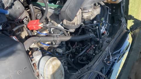

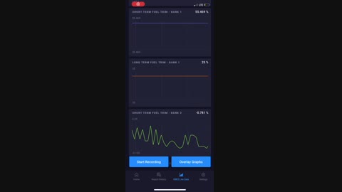

I got it to run but now bank 1 injectors are not spraying fuel, there is power to the harness, I can physically hear the injectors firing, bank 1 fuel injector fuse is good, I can disconnect the entire bank 1 injector harness and nothing changes but when I unplug the other side you can hear each one misfire. I’m not sure if this has anything to do with the tune my friend got or if this is some kind of computer issue but I’m lost

Good call, the left side of the engine is not firing, I would check the catalytic converter on that side it could be clogged. Also,, pull the spark plugs on that side to see if they are wet or dry. Thanks for the video it helps.

Do you have any codes? You could have a shorted fuel injector causing the PCM to increase the duration of the pulse which holds the injector on to long. Please go over this guide and get back to me.

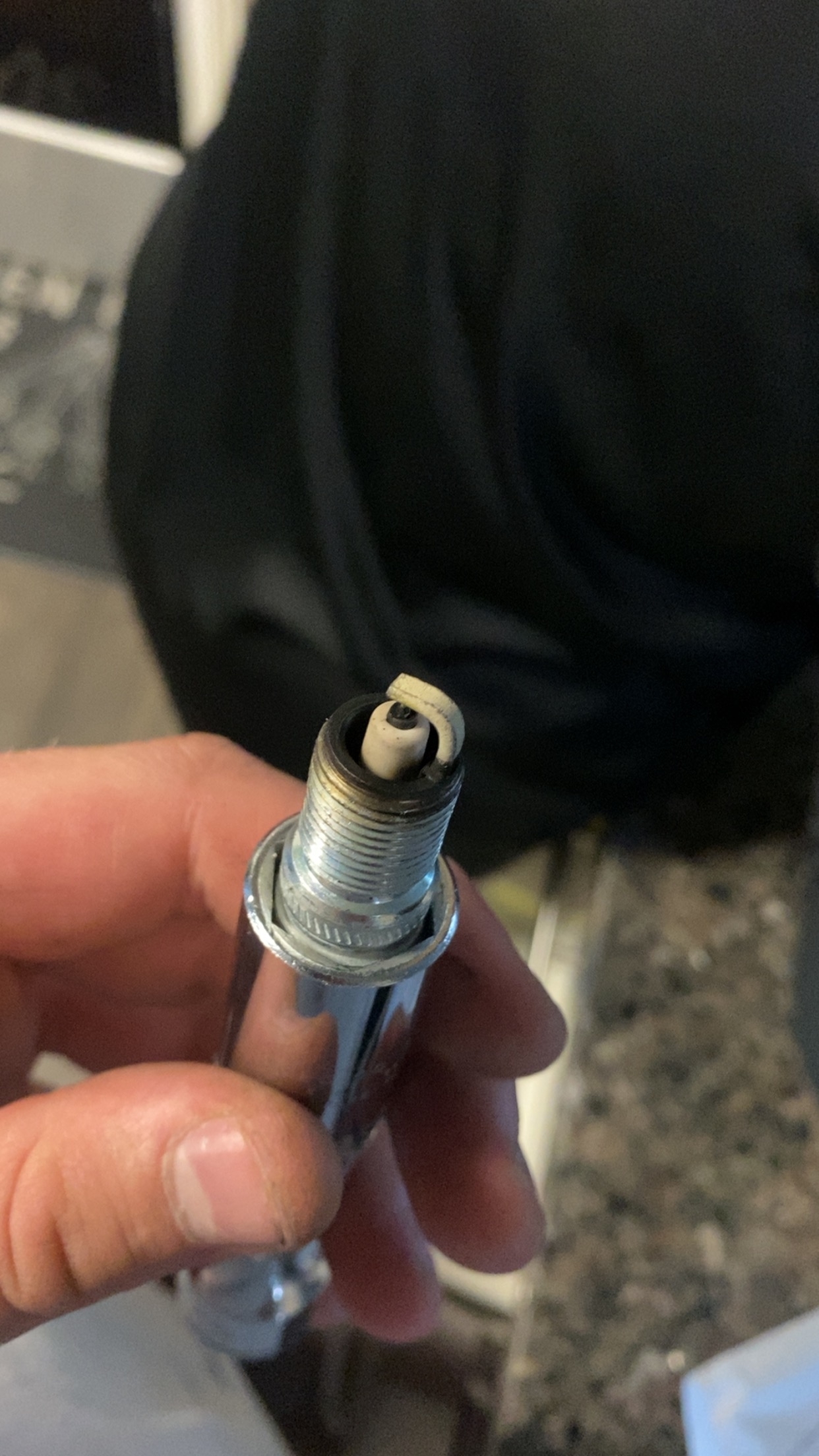

Also, plug the plugs and take a picture so I can see them please. if you want to upload s short video of the engine cranking over (not running) I can tell if the engine is in good shape or not.

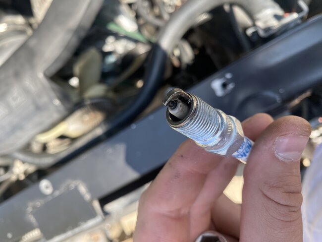

There are no codes because the tuner disabled any misfire codes for the aftermarket camshaft, we were told the computer would always throw a random misfire because of the cam. We know the engine is in good shape 200psi of compression each cylinder, spark in each cylinder, just having a fuel problem. (All the plugs look like that one, I guess the last set of plugs were fouled because of the original crank/no start we found the problem to be a damaged neutral safety switch then it started right up after that.)

This is what the passenger side plugs look like.

Okay, let's use a test light to check if the injectors on the drivers side are getting power and signal, this guide can help. Thanks for the video, pics
