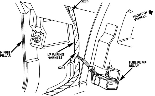

I changed the fuel pump about 2 months ago and had been driving the car and out to visit my daughter. When it was time to go the car would crank but not start and I do not hear the pump come on. Here is the fuel pump relay on the car.

It is located in the vehicle behind the left hand dash mat. See pic 1.
Also, check fuses and make sure they are good as well. Here is a link that shows how to test a relay:
