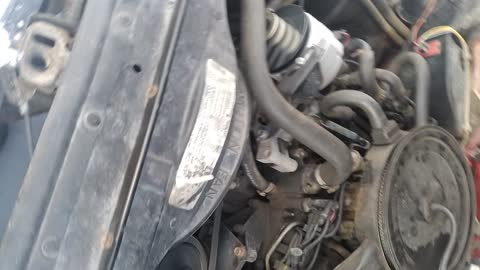

So here's trying to turn it on and keep it running.
Wednesday, April 5th, 2023 AT 6:52 PM
JESSEMACMAIDEN
  • 7 POSTS
Short drive around the block.
Wednesday, April 5th, 2023 AT 7:11 PM
  • 110,194 POSTS
I did hear it, but not the grinding. Listening to how it is starting, I would first start by checking for engine vacuum leaks.

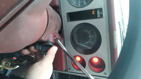

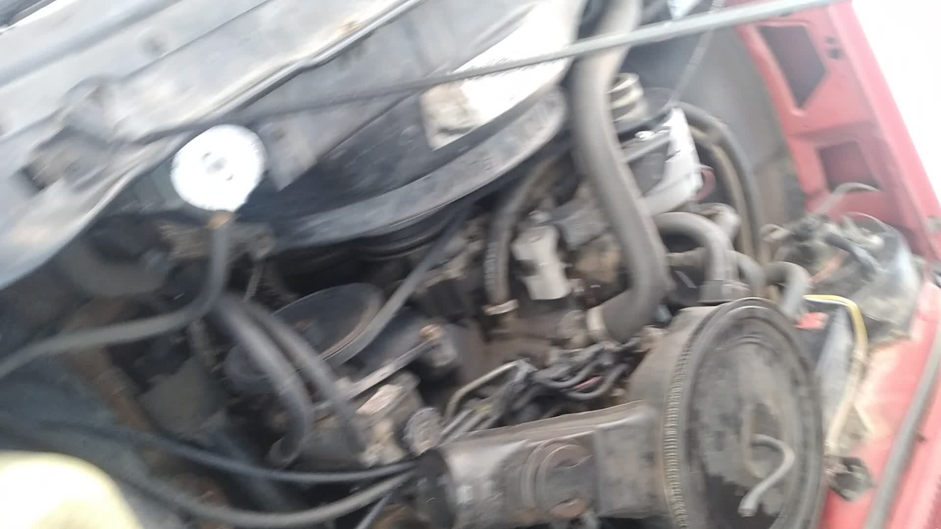

Here's initial start up.
Wednesday, April 5th, 2023 AT 7:29 PM
  • 110,194 POSTS
First, the Bendix on the starter is failing. That is why it will engage sometimes and not others.
Next, the air filter cover needs to be flipped. There is a heat riser on the truck that helps warm the air entering the carb. There should be a tube between the exhaust manifold and the air filter housing. In the housing is a vacuum-operated flap that stays closed until heated air isn't needed and then opens to draw fresh air in. Having the lid flipped eliminates that from helping.
Once the vehicle started, it sounded great. When you try starting this cold, do you press the throttle pedal to the floor one time and then try starting it?

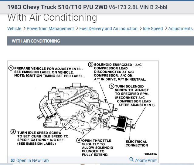

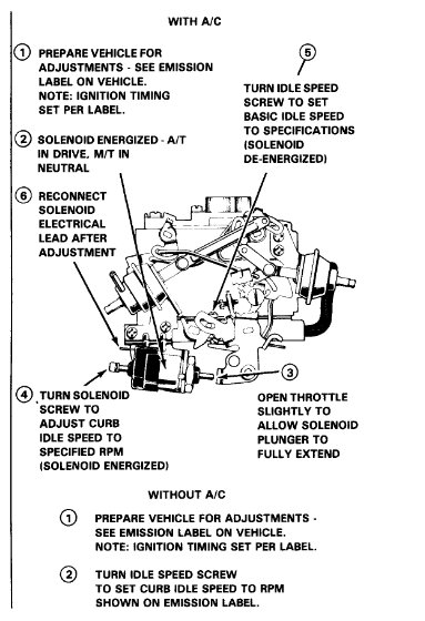

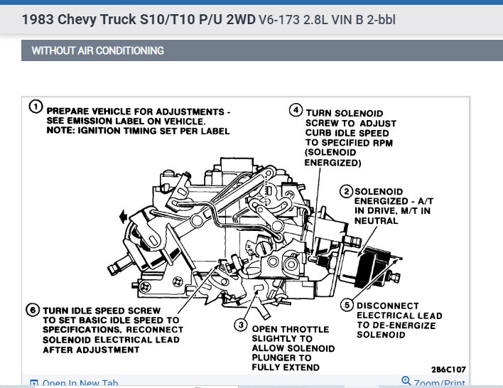

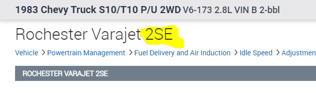

Were you able to see if there are any diagnostic trouble codes stored? See link above. Also, I reviewed the drive around the block again. Do you ever notice dark smoke from the exhaust or does the exhaust have an odd smell?
Keep in mind, there is an adjustment on the carb for idle speed. It shouldn't require adjustment, but anything is possible.
Below, I attached pics and directions for adjusting idle speed. Take note to the heading. I'm not sure if you have factory AC or not and there are differences.
Before you jump into idle speed, make sure the carb is tight on the intake. Check vacuum hoses for leaks specifically the PCV and brake booster. I attached directions above, so take a look. It is actually very helpful.
Do this first. If there is nothing found, then see if you are able to adjust the idle speed.
See pics below
