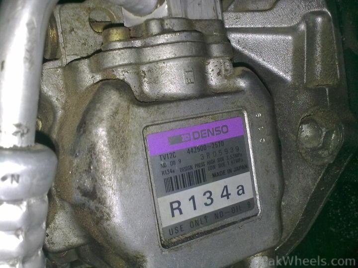

The compressor cycles on and off to regulate the pressure in the low side of the system. There are some newer variable-displacement compressor designs that do run continuously so the passengers do not feel the minor thump each time it engages. Those regulate low-side pressure by pumping a higher volume of vapor when that pressure is high. When the pressure rises, the "wobble plate" tilts more so the pistons it is driving take longer strokes. That increases volume, and that draws the pressure back down. Cycling off momentarily and reducing displacement are done to improve fuel mileage too as well as regulate low-side pressure.
Most commonly the AC condenser fan will cycle on and off with the compressor. With systems that use a variable-displacement compressor, since the goal is to reduce noise and vibrations, the fan will usually cycle off when it is not needed.

My compressor DENSO TV12C.

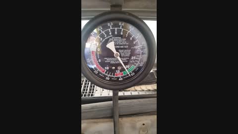

Hi. I have noticed two situations when the air conditioning compressor is activated. 1. Lower the engine rpm to idle. 2. The vacuum goes down from 20 to 16 (measured with a vacuum meter). Are these situations normal or is something wrong?

Is this condition normal when the a / c is activated? The low vacuum falls from 18 to 15 inches. As seen in the video.

T looks like the system could be overfilled dragging the engine down causing the vacuum to fall. It will go down a little when the AC is on which is normal. Here is a guide to help you check the pressures.

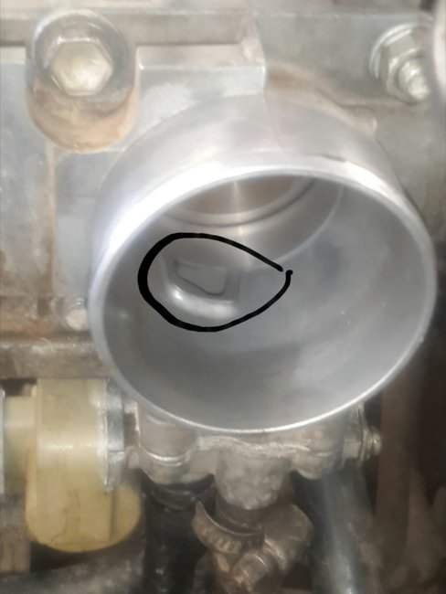

I have verified vacuum leaks in the entire vacuum circuit, I found nothing, everything is tight. Remove the hose that connects the air filter holder and the acceleration body, I could see a hole before the throttle butterfly. I tried placing the finger obstructing this hole and the following happens: Without air conditioning you feel a minimum suction that almost does not affect the reading of vacuum pressure in the meter. With the air conditioner turned on, the suction is greater through the hole, which results in the vacuum pressure drop in the meter. I checked and saw that this hole connects with the IAC valve, apparently this opens more letting more air pass to the collector.
