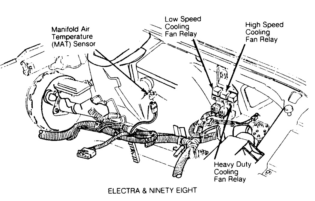

Hi Ken. Just a little more info if you have it available. Mounted to the fender liner under the hood drivers side are three relays on a bracket. The is another relay same part nr looks like mounted near the firewall on passenger side. Can I test them? And what do the control. Thanks again.
Wednesday, September 21st, 2016 AT 3:38 PM
HMAC300
  • 48,601 POSTS
We only show those three for buick and olds, but hel it may be yours as well they all control cooling fan theonly one on right firewall a/c compressor relay see pic
