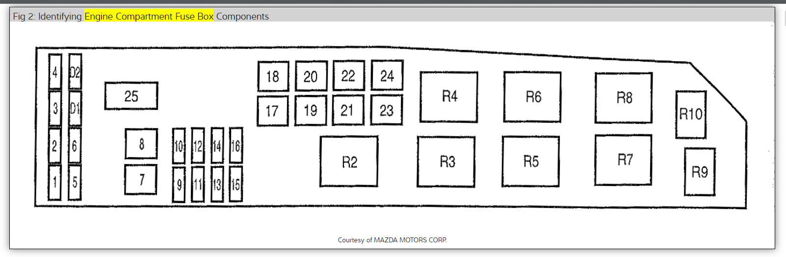

I have a cooling fan problem. I do not know exactly what it is but I can describe in detail what happens. The story starts when I changed my spark plugs to iridium coming from just a regular spark plug. And after that I immediately saw that when I turn on the ac, the passenger side fan is the only one that turns on. Although the driver side fan does turn on, it is only a couple of seconds after I turn on the ac and the passenger side fan gains full spinning power. After ignoring the problem for approximately two months as of this month, I started to change the fan motor on the driver side (used ;previously saved from old cooling fan-oem). I have also changed the connector of the car to the cooling fan. After I turn on the ac, I saw that the driver side had gained full spinning power while the passenger side fan started to enact the behavior of the old driver side fan, which only turns on for a couple of seconds then stops while driver side fan gains full spinning power. So far I also changed the old wiring of the passenger side fan, but still the same behavior. I hope someone could help as I do not want to buy a new cooling fan assembly. I have tried checking the fuses by exchanging them and I still do not have progress.

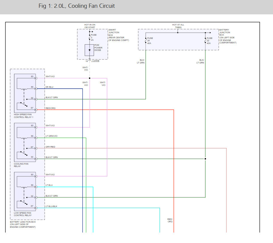

Lets check for power at the motors to see if they are working correctly. Here is a guide to help test for power and the cooling fan wiring diagrams so you can see how the system works:

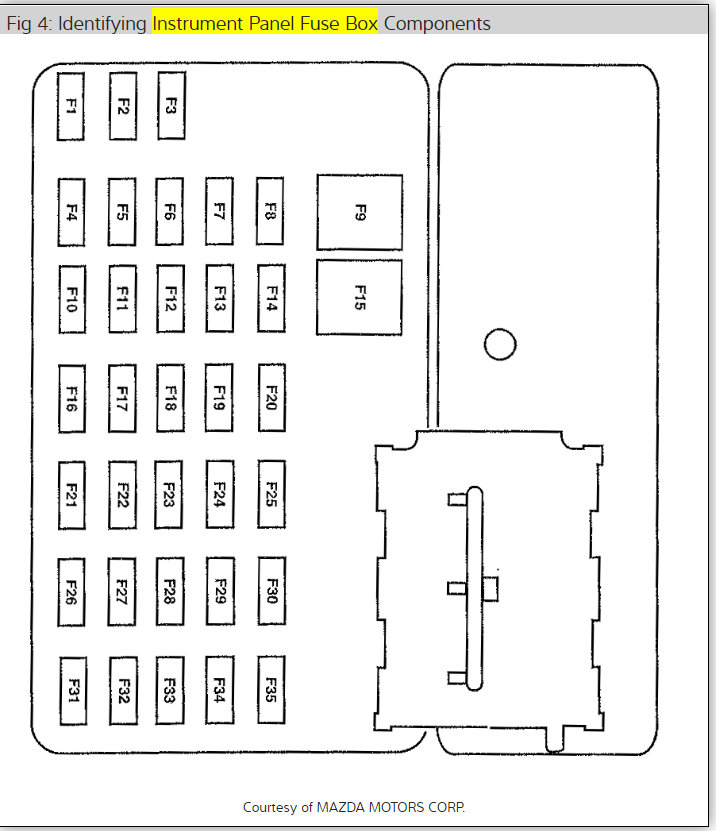

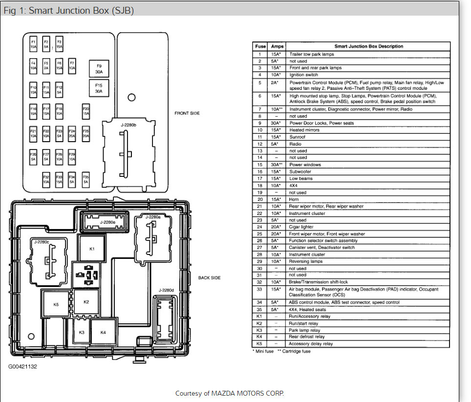

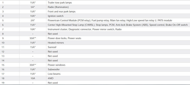

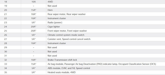

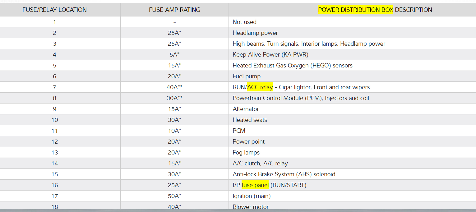

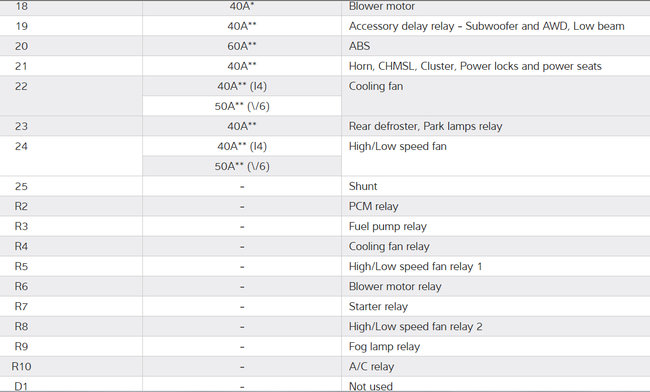

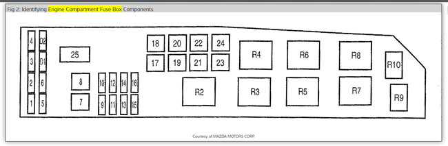

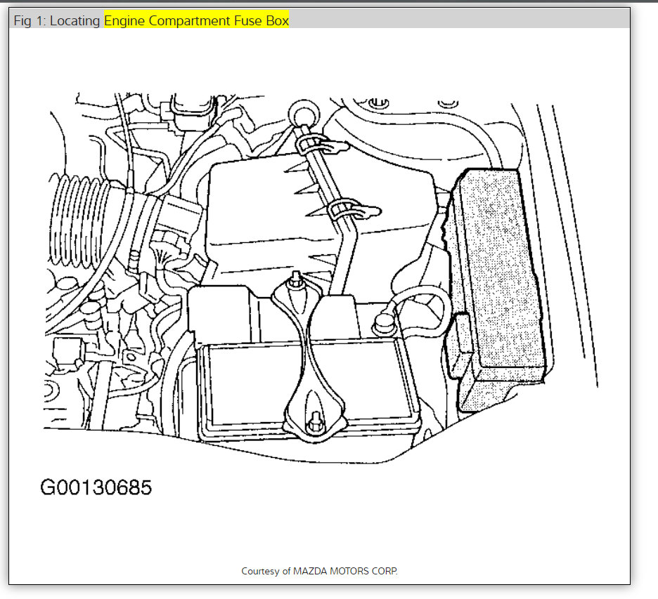

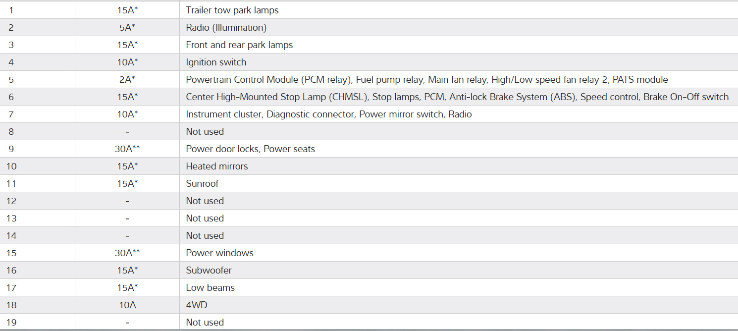

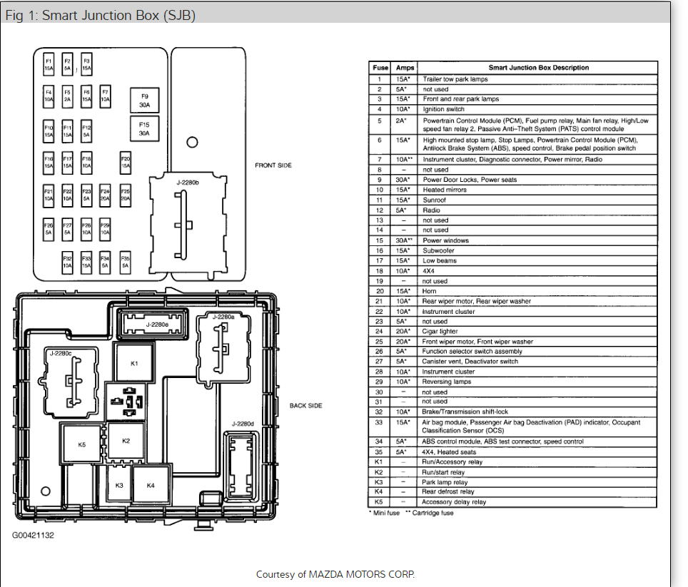

All you need is a test light. Lets check fuses #5, 22 and 24. Please make sure they are good. And get back yo me please. Also the relays.
and

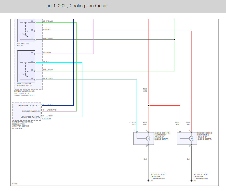

I should have had you do this first. Check out the diagrams (below). Please let us know what you find.
Friday, October 4th, 2019 AT 11:59 AM

Sorry, I don't have a test light. But I replaced all the fuses and relays that you mentioned and highlighted. I also notice that when I take out the connection on the A/C condenser fan I notice that the driver side fan seems to be running normally. But when both fans are connected, only the driver side fan is working fully when I turn on the A/C.

The dark blue wire is for the high speed fan which may not come on until high pressure (temperature) is present. does the system work correctly other than the fan not coming on?
Lets check the relays next use this guide:
