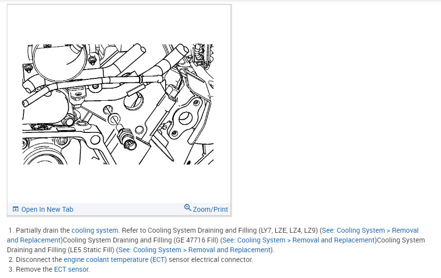

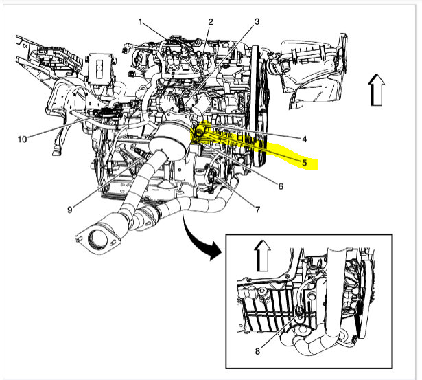

I cannot find the location of the coolant temperature sensor.

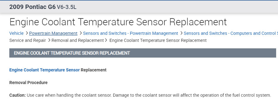

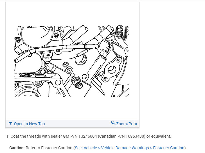

The engine coolant temperature sensor is located on the rear of the engine (near the firewall). If you look at pic 1 below, it shows the location.

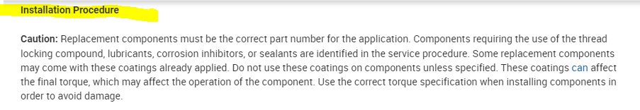

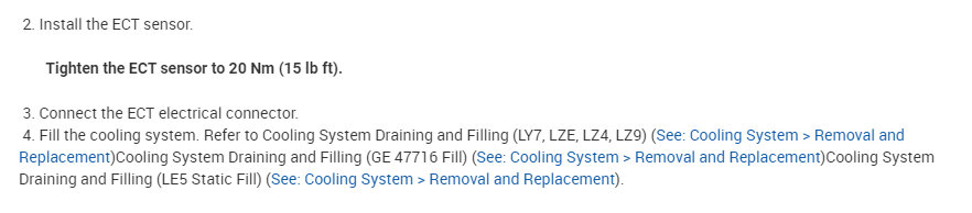

The remaining pics are the directions for replacing the sensor. I don't know if you need them, but I thought I would add them just in case.
