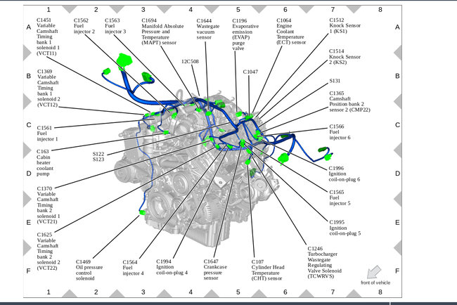

COY GNADE

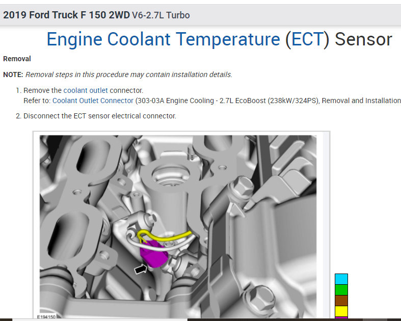

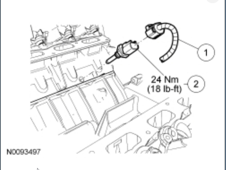

hi, i was wondering where it would be in the engine. i took it to O'reillys and they told me the code for it and all im seeing is for like a 5.0L. so i was wondering where it is on my engine and is it a easy to do fix?
Mar 7, 2021 at 2:08 AM
DANNY L
  • 5,648 POSTS
Hello, I'm Danny.

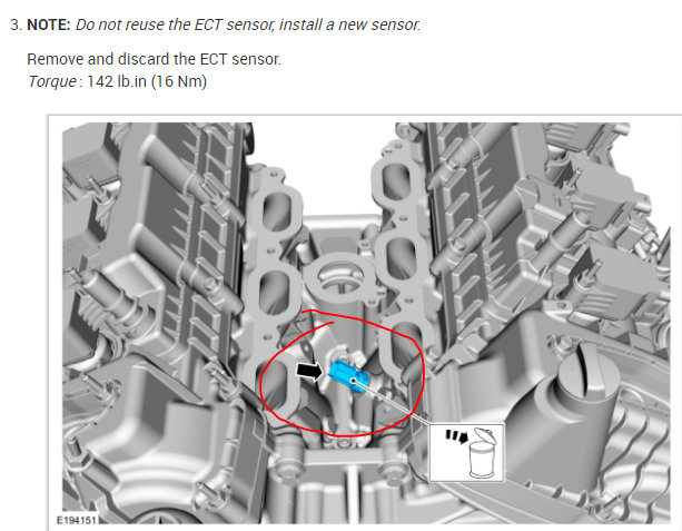

The coolant temperature sensor is located underneath the intake manifold in the lifter valley area. You will have to remove all the upper engine accessories and the intake manifold to gain access to the sensor. Being that your truck is a 2019 does the factory Ford warranty still apply? I would have them cover it first due to the fact that if you have to do this repair yourself out of pocket it will cost thousands of dollars. We can provide you with the repair guides if you choose to do this however I would check your warranty information first being this is a relatively new truck. I've attached a picture below of the coolant temperature sensor location. Let us know how you are going to proceed and we'll go from there. Hope this helps and thanks for using 2CarPros. Check out the images (below). Let us know how it goes

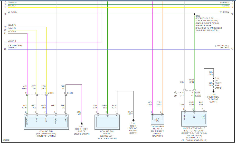

COY GNADE

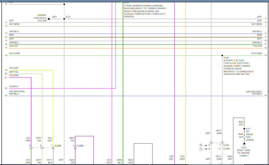

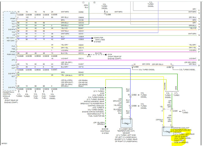

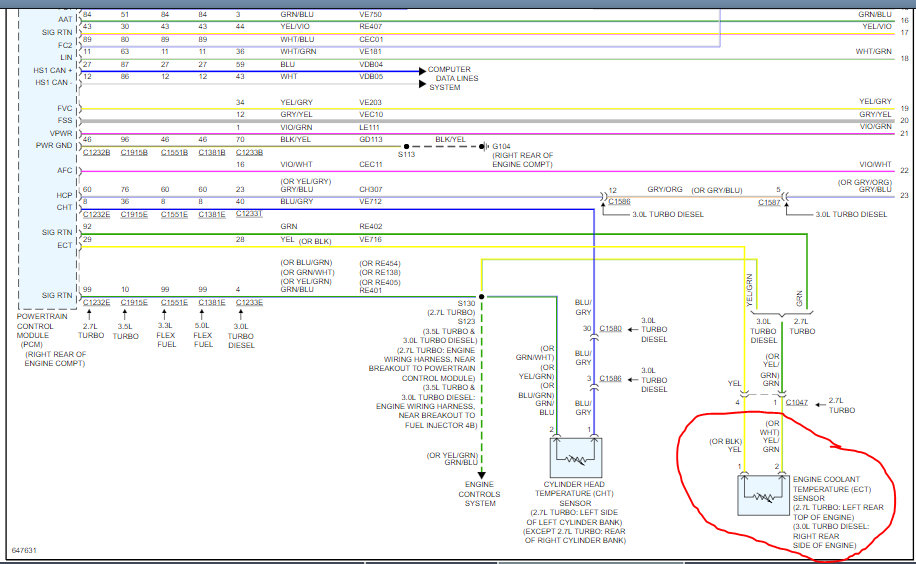

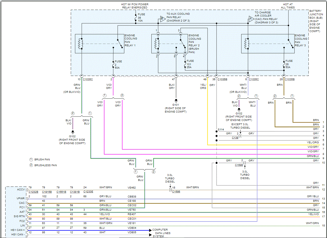

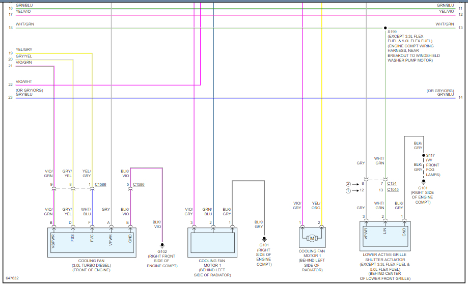

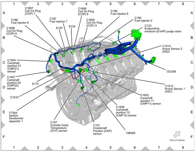

i'm going to do it myself could you send me a diagram of the wire sensors?
Mar 7, 2021 at 10:09 AM
  • 110,209 POSTS

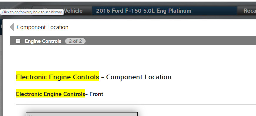

I attached two pics below which include the coolant temp sensor. I highlighted the sensor in pic 2.
Let me know if this helps.
Mar 9, 2021 at 9:53 AM
DANNY L
  • 5,648 POSTS

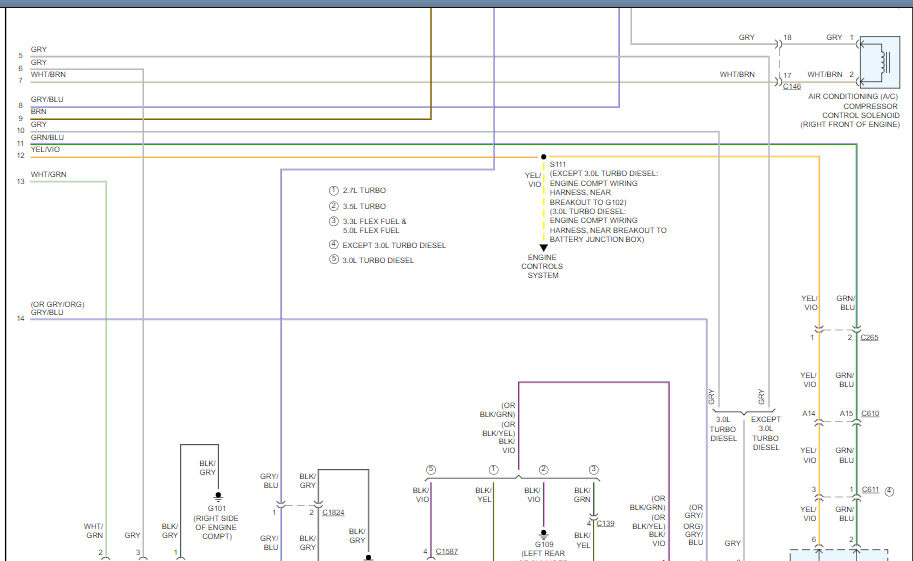

Hello again.

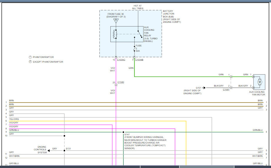

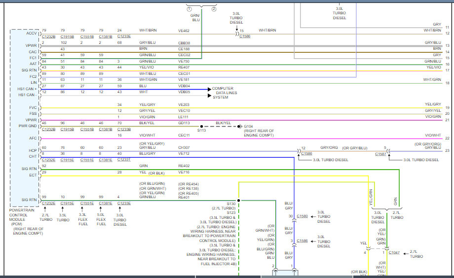

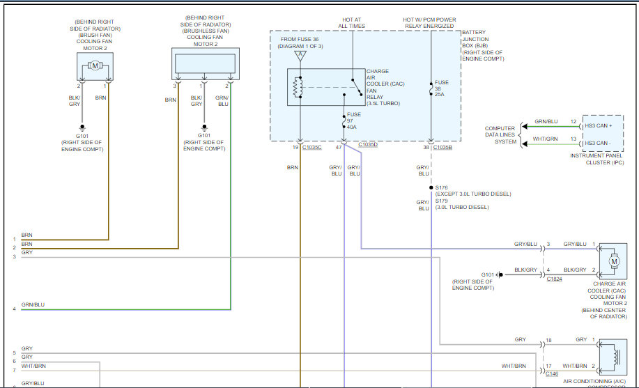

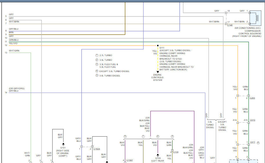

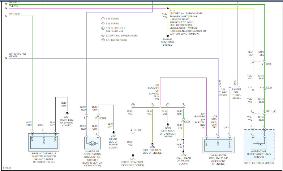

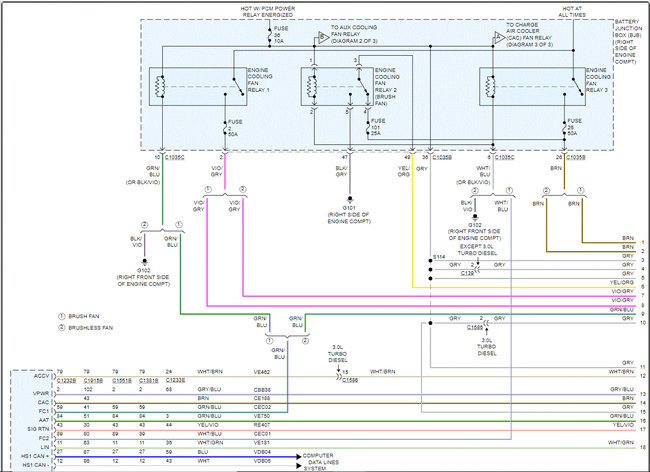

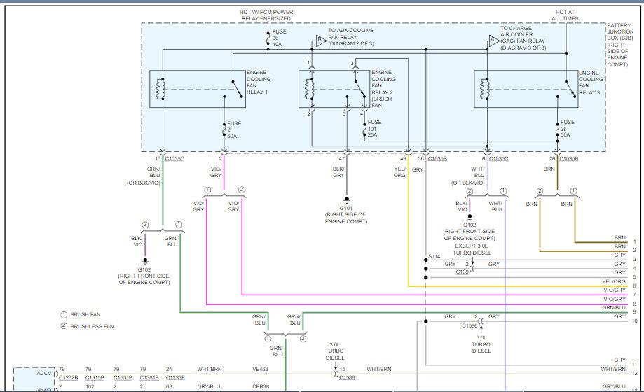

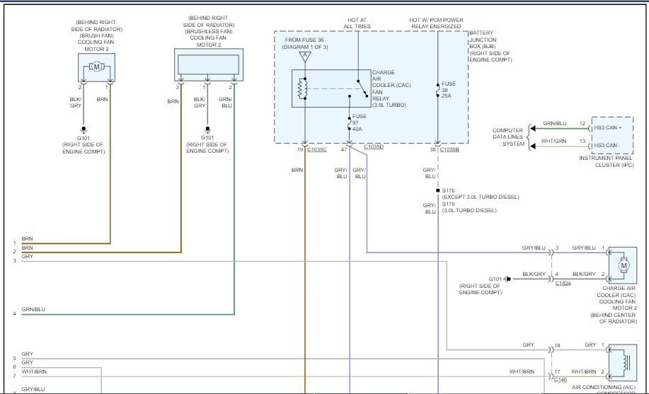

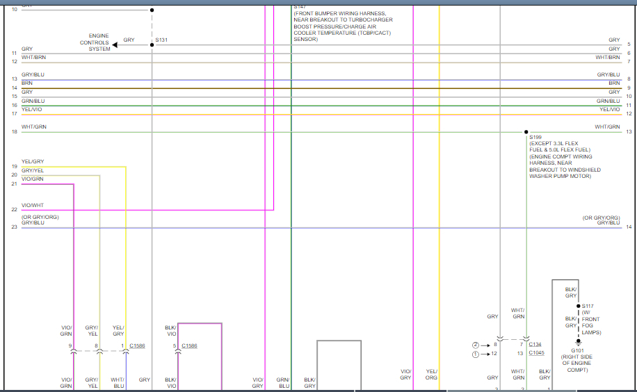

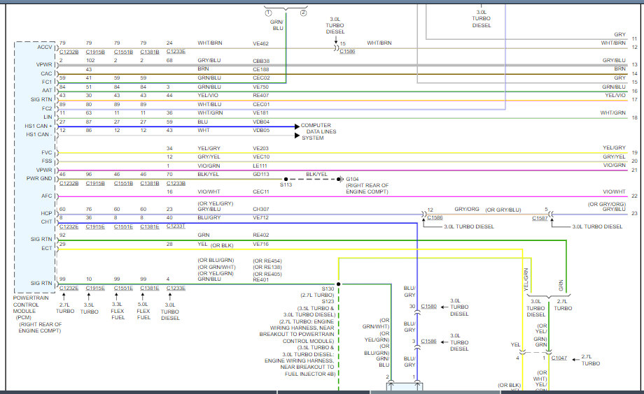

Here is the information you requested. We have had a bunch of people request wiring diagrams here due to rats chewing up the wiring so you are not the first. That is a bummer especially being a new truck. Here is a tutorial showing how to test electrical wiring:
I've attached the wiring diagrams below for the cooling system including the coolant temperature sensor. I've cut the diagrams into 3 pieces so you can view larger. I've circled the sensor in red. Let us know if you have any further questions on this issue or need any further diagrams-help. Hope this helps and thanks again for using 2CarPros.
Danny-
Mar 9, 2021 at 11:17 AM

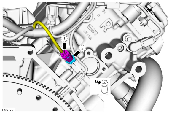

I have pulled the code, P1289 and got the replacement part but need to figure out where it is located.
May 7, 2021 at 4:18 AM (Merged)
JIS001
  • 3,412 POSTS

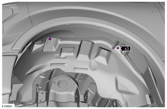

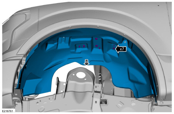

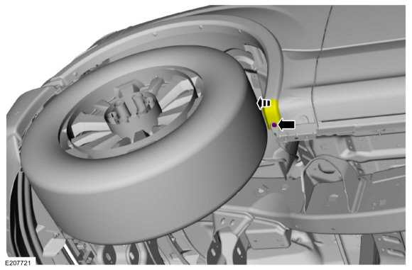

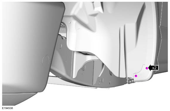

Removal
NOTE: Removal steps in this procedure may contain installation details.

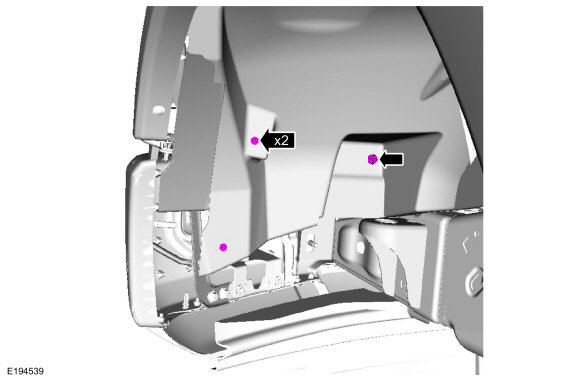

Remove the RH fender splash shield.
Refer to: Fender Splash Shield (501-02 Front End Body Panels, Removal and Installation) .
NOTE: Do not reuse the CHT sensor, install a new sensor.
Disconnect the CHT sensor electrical connector.
Remove and discard the CHT sensor.
Torque : 97 lb.in (11 Nm)

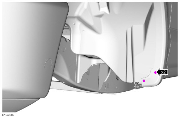

BCW19811
  • 5 POSTS
Can you post a link to the fender splash guard removal? I have searched the site and cannot find it. Thanks
JIS001
  • 3,412 POSTS
Here you go. Good luck with the repair.

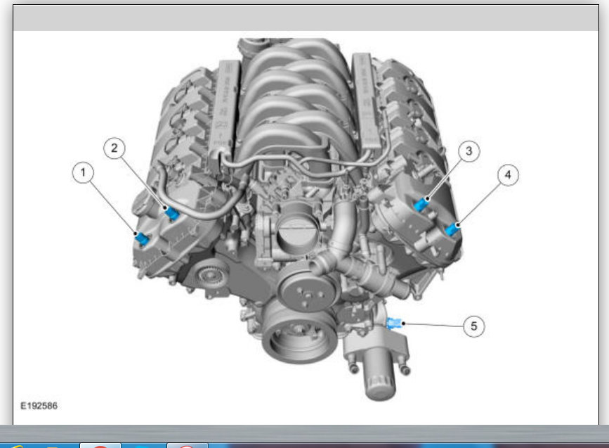

AAPACER

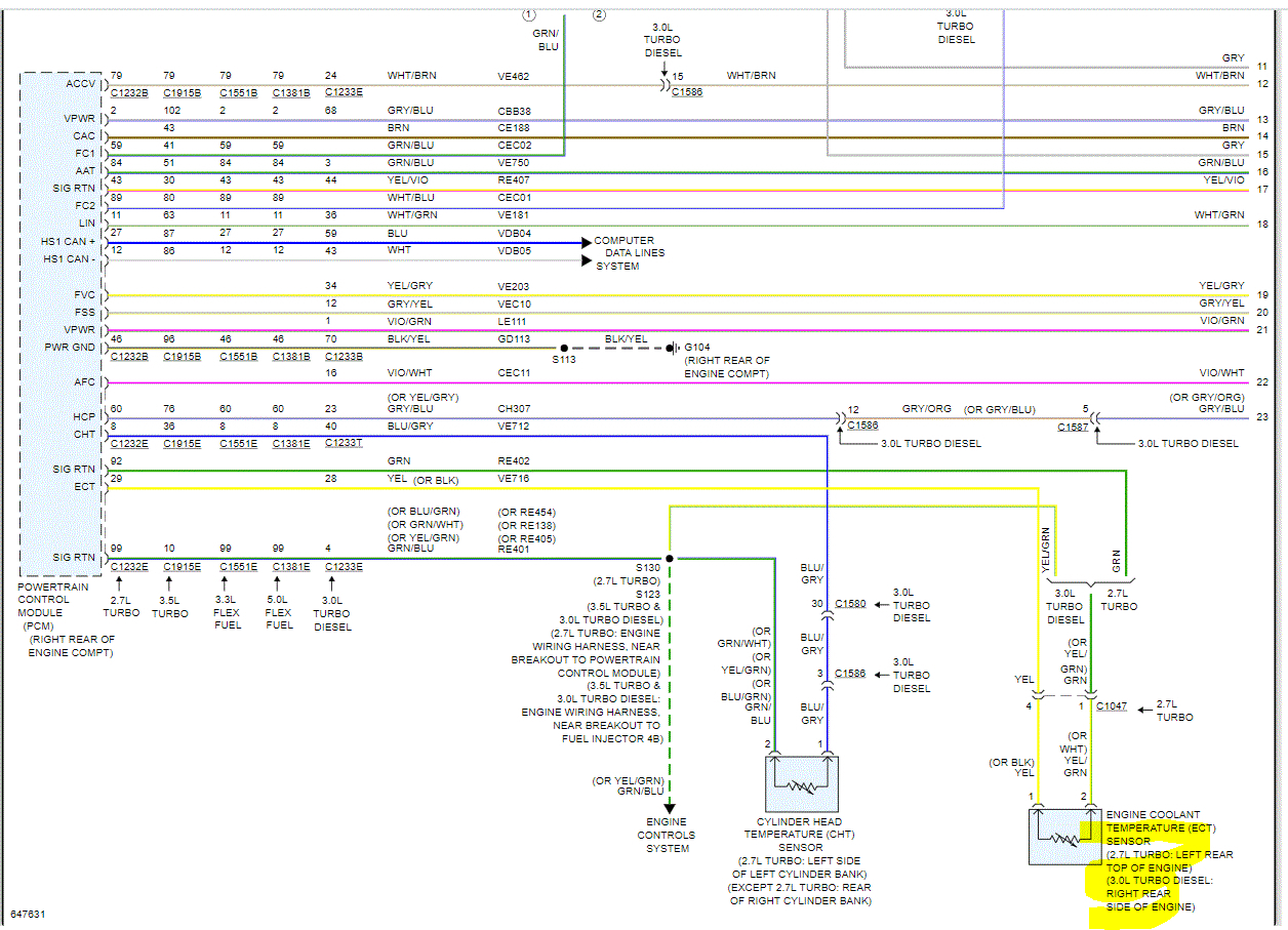

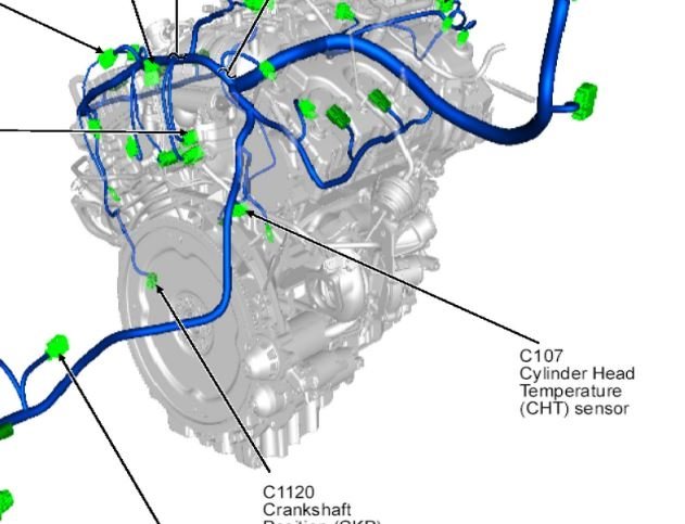

check engine light is on telling me to replace the engine coolant sensor
SCGRANTURISMO
  • 4,897 POSTS

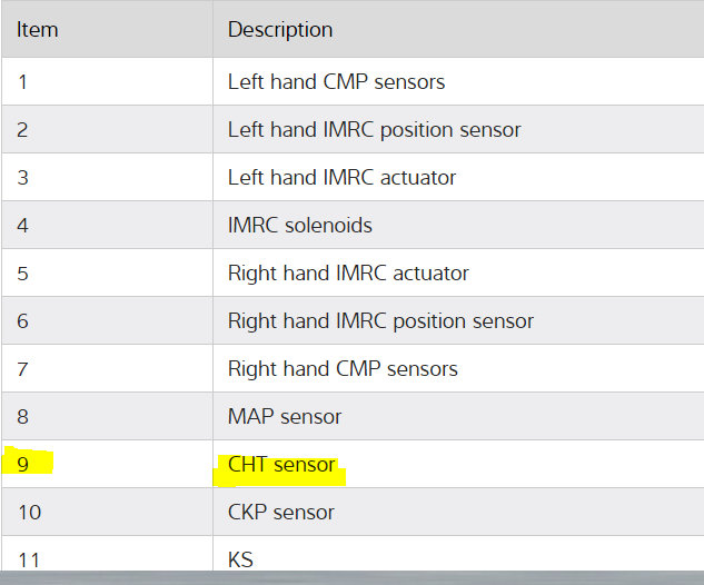

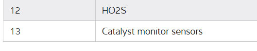

The Cylinder Head Temperature (CHT) sensor is located a left center of the rear of the engine. I have included a set of engine sensors in the diagrams down below for you vehicle. If you have any other vehicle related questions, please, feel free to ask. It's what we do and why we are here.

BCW19811
  • 5 POSTS

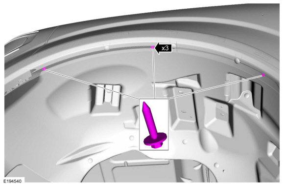

Do the clips in the first diagram unscrew or do they pop out? Also are they reusable or do I need replacements?
JIS001
  • 3,412 POSTS
All the plastic clips pop out.
BCW19811
  • 5 POSTS
Problem solved. The part was easy to swap out. Took about 30 minutes from start to finish. I think I wasted more time looking for my ratchet. Thanks for the help.

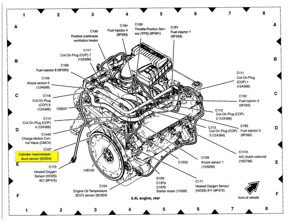

Where is the coolant temp sensor Located? Sorry the engine is a 5.0L.
DANNY L
  • 5,648 POSTS
Hello, I'm Danny.

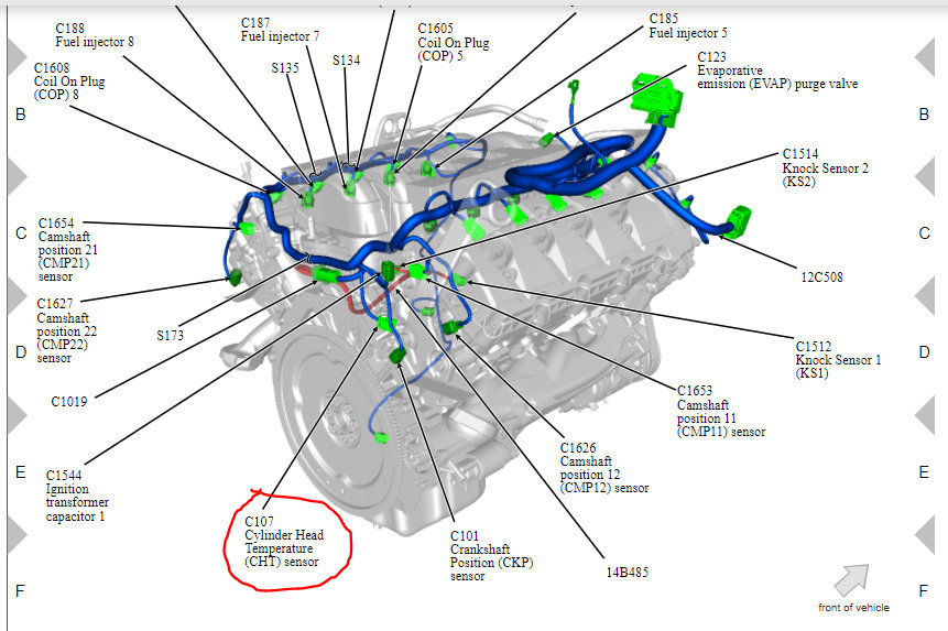

Here is the information you requested. The coolant-cylinder temperature sensor is located on the right rear of the engine. Here are a few coolant temperature sensor tutorials for you to view:
https://www.2carpros.com/articles/symptoms-of-a-bad-coolant-temperature-sensor
https://www.2carpros.com/articles/how-a-coolant-temperature-sensor-works
I've attached a picture below of its location and circled in red. Hope this helps and thanks for using 2CarPros.

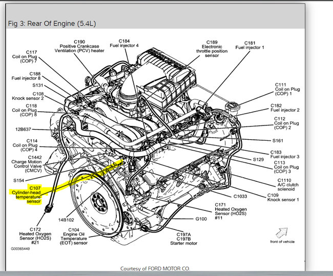

MICHAEL PARKER2

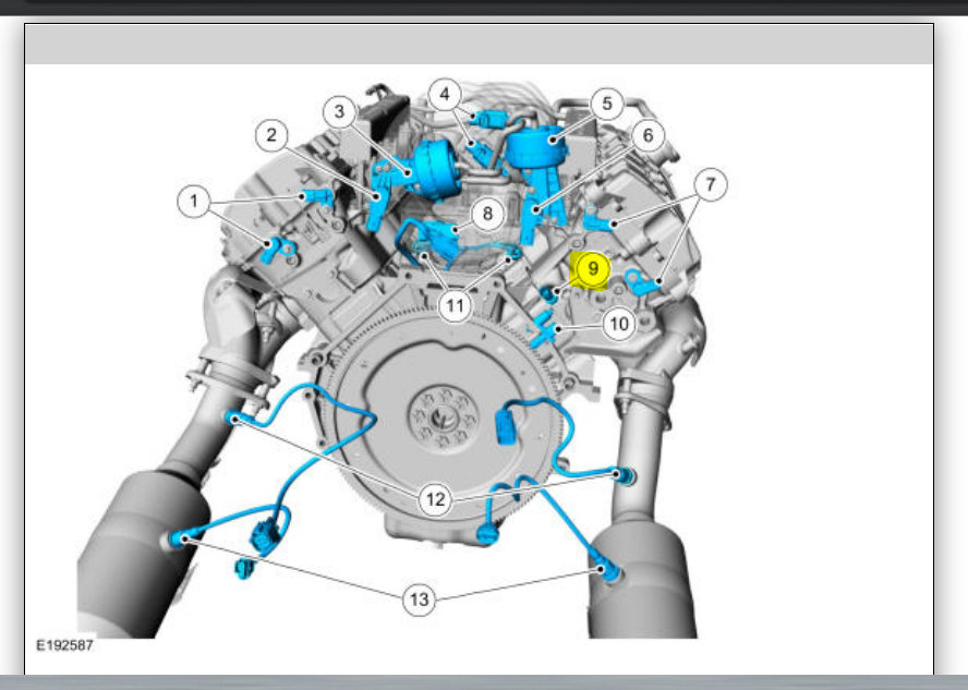

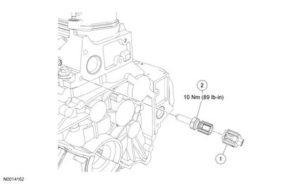

A rodent got into my engine bay and ate some of my insulation but also appears to have eaten through the wiring to the engine temperature sensor. I cannot find where it is located on my engine to check the wiring.

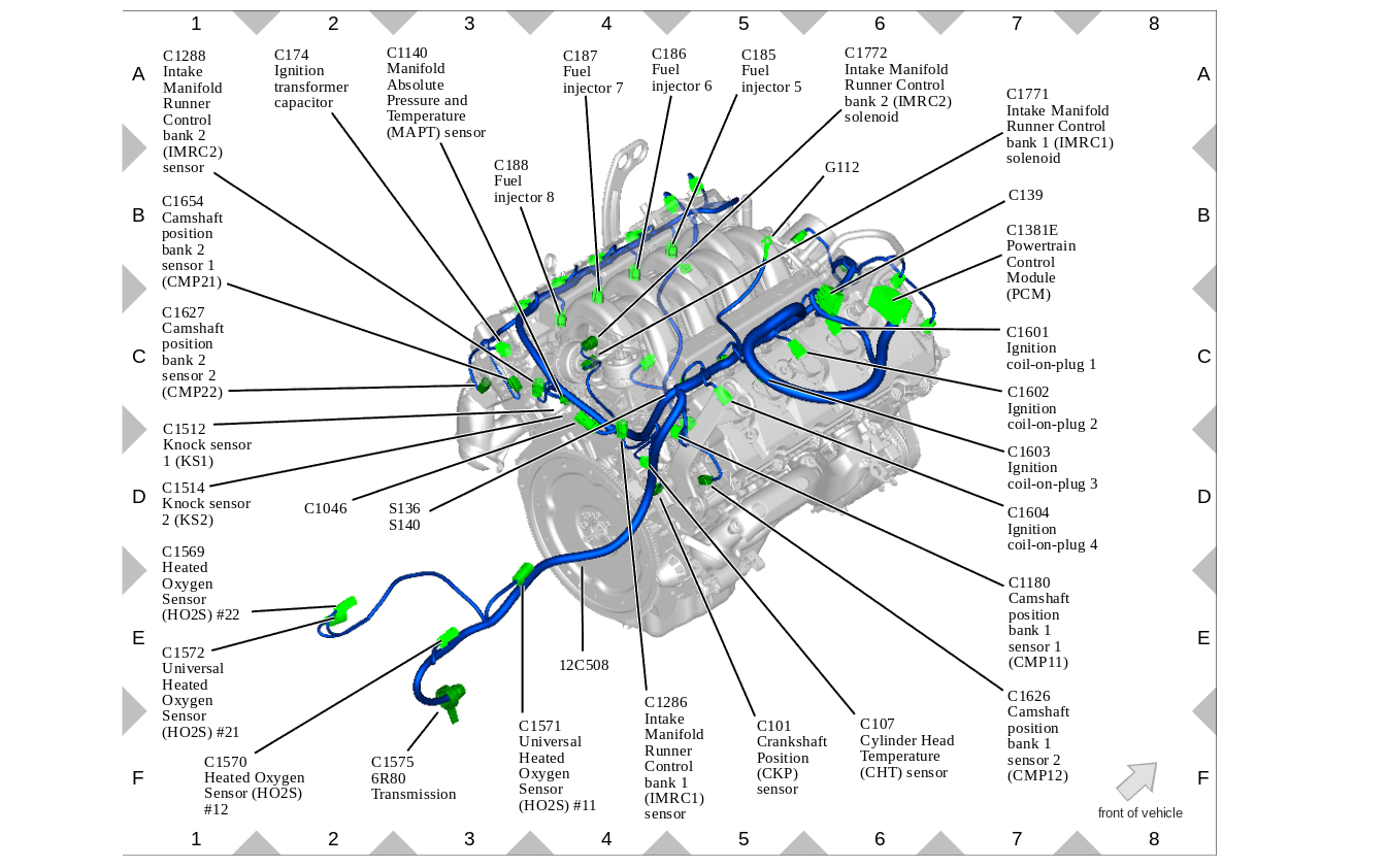

STEVE W.
  • 15,211 POSTS
The sensor is back at the engine/bell housing split. Mounted to the passenger side cylinder head on the inner rear of the head. Item C107 in the picture.

FAMILY68
Where is the engine coolant sensor located?
STEVE W.
  • 15,211 POSTS
Ford doesn't use a conventional style coolant temperature sensor, they use a cylinder head temperature sender. It is on the rear of the engine on the right side above the bell-housing flange on the 5.0 engine. What is the issue you are having?

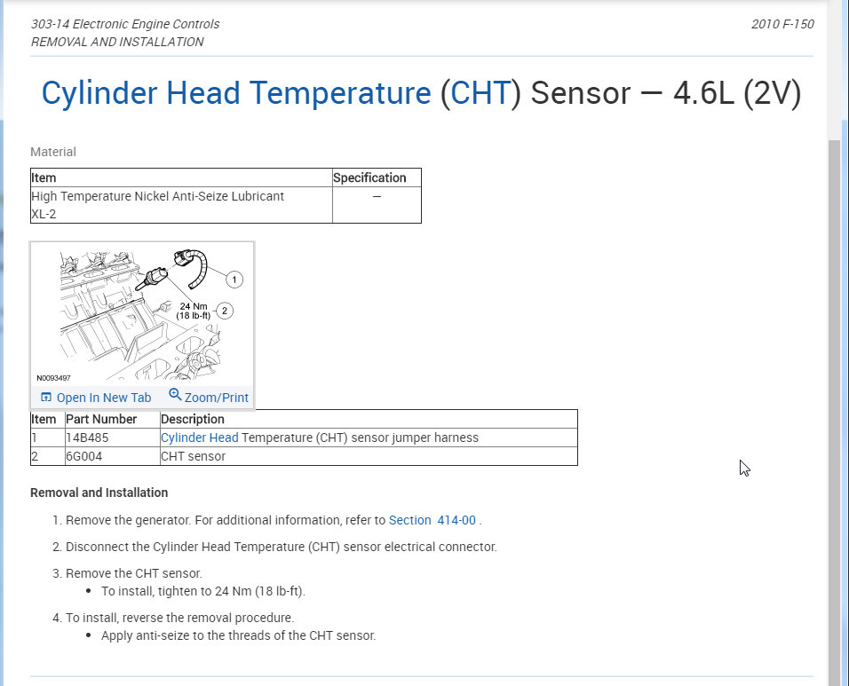

THEMIGHTYSORE
Looking for location of coolant temperature sensor..
This is a pretty common question for these engines. You have what is called a cylinder head temperature sensor. Exact same thing as an engine coolant temperature sensor, it is just in the cylinder head. Now the unfortunate part, it is under the intake manifold. If you take a look at the picture you will see the intake ports are exposed in order to access it.
Let me know if you need more info. Thanks
THEMIGHTYSORE
Very much appreciated. Unfortunately, this takes it right out of my comfort zone for executing at home. At least I have a general grasp of the labor involved, which helps when communicating with mechanics. Thanks again.

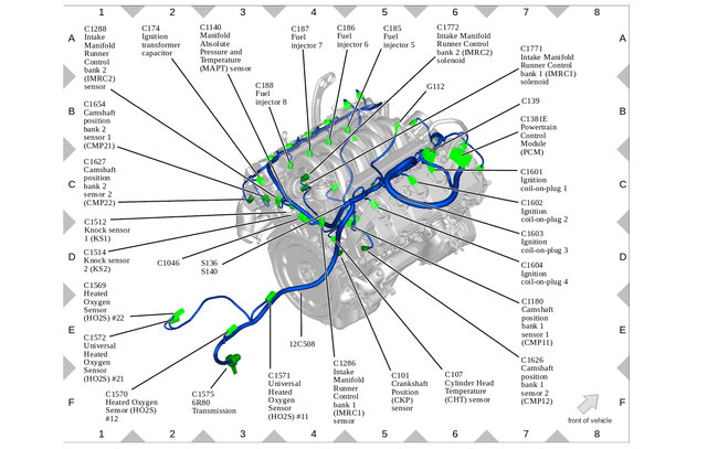

SCGRANTURISMO
  • 4,897 POSTS
The information that you requested is in the diagrams down below. It is located on the top rear of the engine.

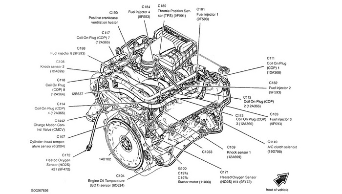

DOLPHUS
Where is a coolant temperature sensor located on a Ford F-150?
May 7, 2021 at 4:19 AM (Merged)
JDL
  • 16,098 POSTS
My info shows this for the 5.4L. cylinder head temp sensor, back side of cylinder head on the passenger's side. Check out the diagrams (Below). Please let us know if you need anything else to get the problem fixed.

DOMLAB

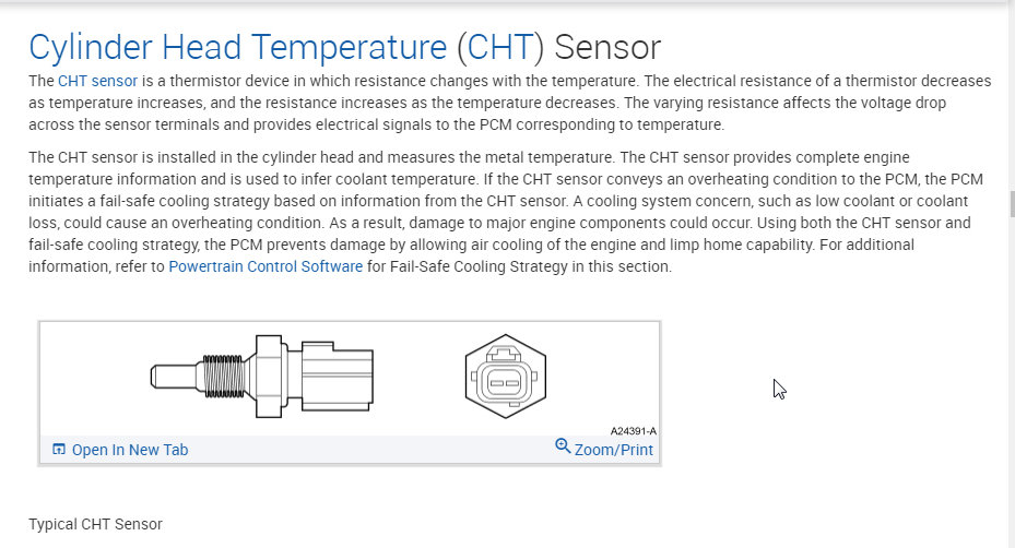

I located the cht sensor but can't find the temp sensor Ect thanks
OHYEA
  • 153 POSTS
Your engine doesnt have a traditional ECT(engine coolant temperature) sensor, instead it employs a cylinder head temperature(CHT) sensor.
HMAC300
  • 48,601 POSTS
that 's because it doesn't have one it uses a cht sensor instead.
