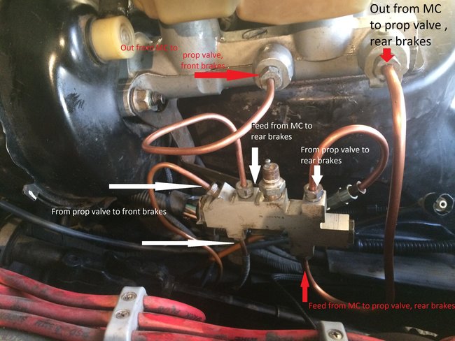

Hi again, now I have routed the lines from master cylinder to prop valve the way I believe it should be. I am bleeding the system now. Can you confirm that this is right, as you said last time? It is a 1987 Camaro with disks at front and drums at rear.
Thanks,
Knut Smilden
Monday, December 10th, 2018 AT 9:57 AM
  • 52,797 POSTS
Looks good.

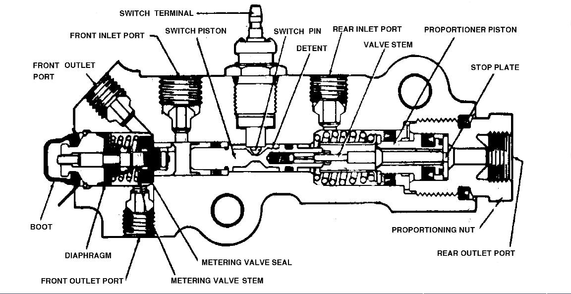

Found this diagram for you.
Monday, December 10th, 2018 AT 10:07 AM
KNUT SMILDEN
  • 22 POSTS
This is not the valve we have. We have the original GM third gen F body valve. What concerns me is if I got the rear brakes plumbing correct. I think that the feed from the master cylinder should go to the port on the underside of the valve, then it gives pressure to the seal on the small piston and spring inside the valve, forcing the piston to move and let the brake fluid pass to the out port on the top, and to the rear brakes. If the feed from master cylinder goes in on top, the pressure comes on the wrong side of the seal, and will not have any effect on the piston and spring.
How do you see it?

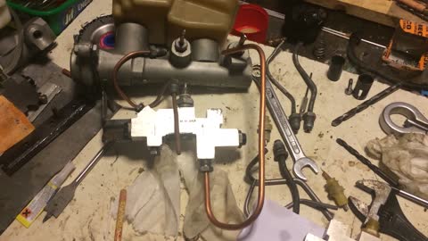

I am sending you a video I made. Prop valve plumbing.
Knut
+1
Monday, December 10th, 2018 AT 10:44 AM
KNUT SMILDEN
  • 22 POSTS
Here is a video I made: Brake lines from master cylinder to prop valve.
Monday, December 10th, 2018 AT 10:50 AM

Okay, I will be here for it. The picture I sent you was for the 1987 Camaro.
KNUT SMILDEN
  • 22 POSTS
Yes, the one on your picture fits our car, but EE use the original.
Monday, December 10th, 2018 AT 10:54 AM
  • 52,797 POSTS
The inlet for the front is at the top. The ones below are for each front side.
The inlet for the rears is on the top as well.
Monday, December 10th, 2018 AT 10:57 AM

I do not know if you see what I mean. I have got the front.
But I think the pressure to the rear brakes on the piston and seal should come from the correct side of the seal, where the lip is. And that is in the port on the underside.
Knut
Monday, December 10th, 2018 AT 11:07 AM
KNUT SMILDEN
  • 22 POSTS
On my video, the red piston, there is a black seal with the lip facing to the right. There is a small hole just under there from the brake line, and on top, the hole to the out port and brake line is to the left of the seal. So when applying pressure, the brake fluid will press the seal and piston to the left and let the fluid pass and go up to the outport and to the rear brakes.
That is the way I see it in my head.
Knut
Monday, December 10th, 2018 AT 11:16 AM
  • 52,797 POSTS
I understand what you are saying but I am not an engineer and take the word of the information systems that I work with.
