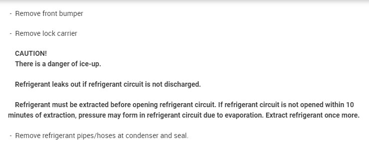

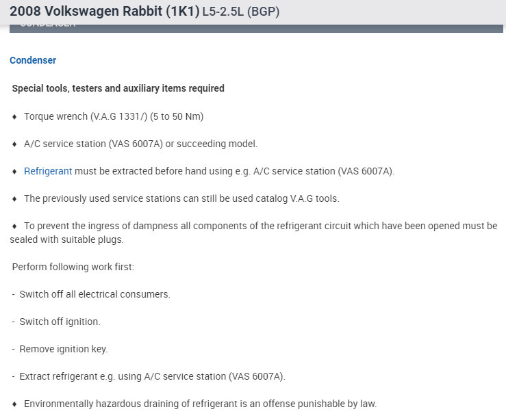

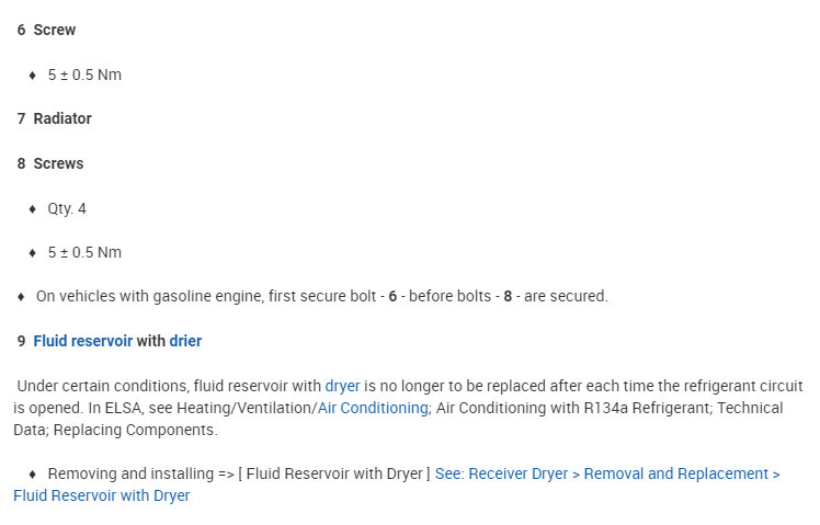

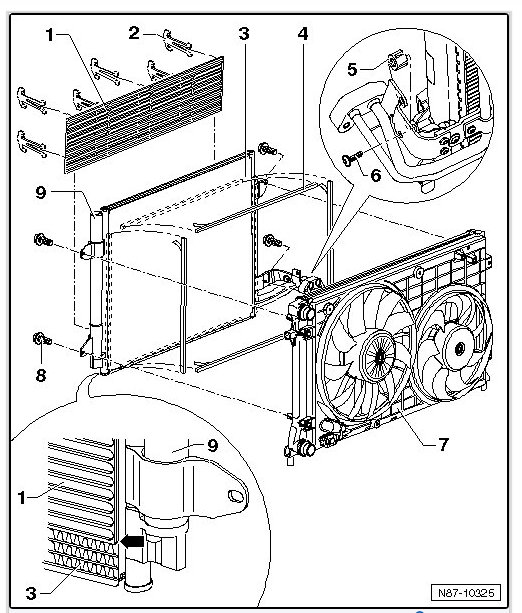

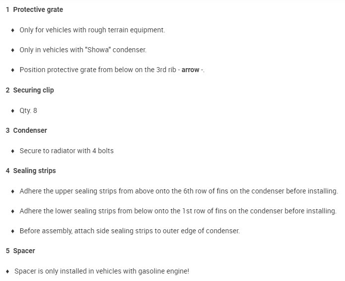

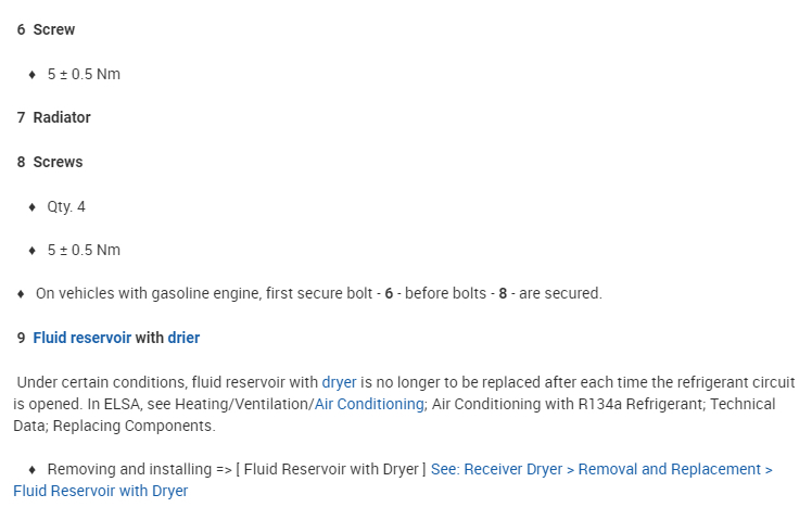

Hey, I am curious of how you get the condenser out.
Wednesday, September 11th, 2019 AT 10:15 AM
DANNY L
MECHANIC
5,648 POSTS
Hello, I'm Danny.
You are going to have to evac and recharge the system so here are some guides that will help with this:
https://www.2carpros.com/articles/air-conditioner-how-to-add-freon
I've attached step-by-step pictures below on how to remove your condenser. Hope this helps and thanks for using 2CarPros.
