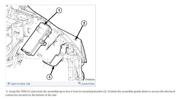

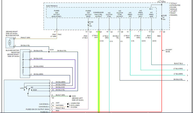

Where is the condenser fan relay location?
Tuesday, May 4th, 2021 AT 12:38 PM
3 Replies
MECHANIC
52,796 POSTS
Good afternoon,

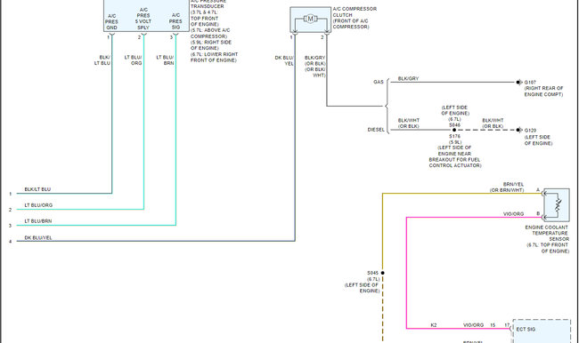

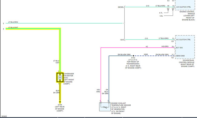

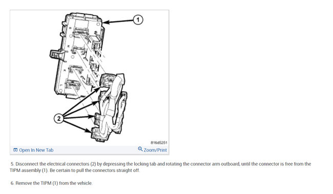

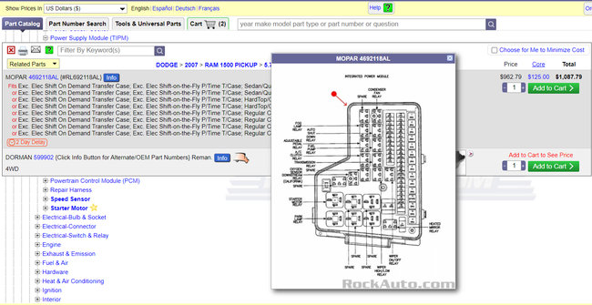

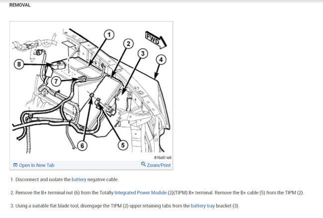

There is no relay for the fan motor. It is controlled by the integrated power module under the hood. The fan is activated by the module when it sees Freon pressure on the high side above 150 pounds.

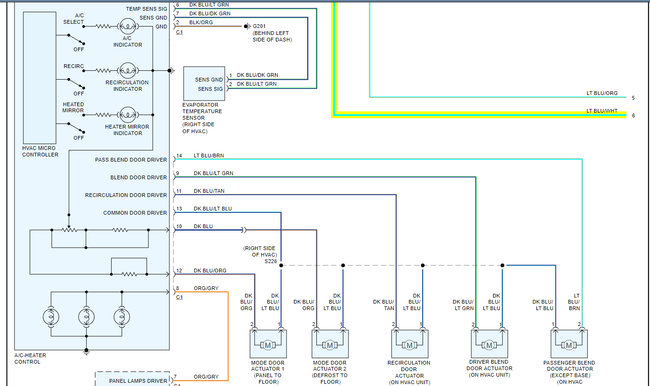

The module is a common failure. I attached a wiring diagram for you. I also attached the part from Rock Auto.

Thank you for the Information you sent me. To get that module replaced would you know a ballpark figure how much it will cost?
Wednesday, May 5th, 2021 AT 9:33 AM
MECHANIC
52,796 POSTS
From the parts, I found new, $1,200.00 to $1,400.00.
