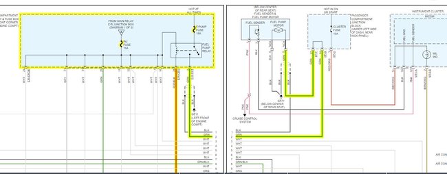

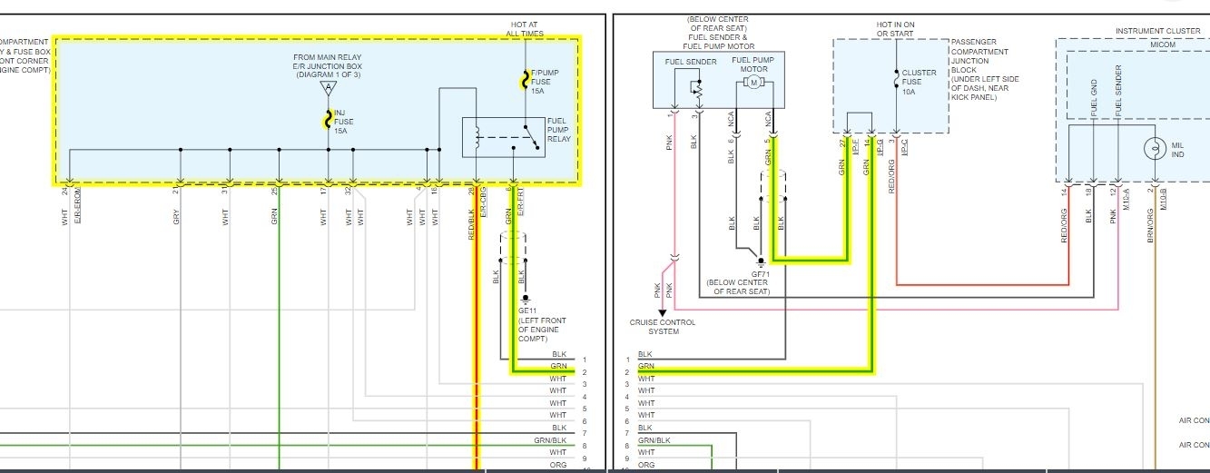

Hey Roy
With reference to the last issue discussed, car was still working until two days ago. Car won't start. Fuel pump seemed to have entirely ceased working. I thought replacing fuel pump would solve the problem. New fuel pump didn't work either as car won't start. Tested new fuel pump in another car and it worked fine so I concluded that fuel pump might not really be the issue here. Any idea what could be wrong? Thanks.
Robin.
Friday, July 26th, 2019 AT 3:54 AM
  • 52,797 POSTS
OK, you will need to check to see if there is voltage to the pump. Make sure all the fuses are working by using a test light to be sure power is on both sides of the fuses.
Check the 2 fuses listed in the diagram I attached.
Friday, July 26th, 2019 AT 4:27 AM
ROBINAFOR
  • 34 POSTS
I can't say I can make out anything from the diagram, I'm sorry about this. Where exactly would the fuse you are talking about be? If you could be a bit simpler in your explanation, I would really appreciate it. Thanks.
Robin.
Friday, July 26th, 2019 AT 6:19 AM
  • 52,797 POSTS
Under the hood, there is the fuse box. The 2 fuses I listed are marked injector and fuel pump. You need to test for power on both sides of the fuse to be sure power is going to the relay.
That is as simple as it gets.
