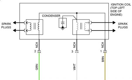

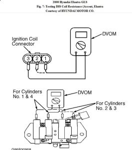

After the motor is up to temp. it shuts off and there is no spark out of coil pack. So I changed coil pack and same problem. When engine cools off we have spark and runs well. So I need to find what powers coil pack.

Hi Jgar, Thank you for the donation. Ignition Coil Power Circuit (Elantra & Tiburon) Turn ignition off. Disconnect ignition coil 3 -pin connector. Turn ignition on. Measure voltage between connector terminal No. 1 and ground.
https://images.2carpros.com/forum/automotive_pictures/192750_CoilTest00ElantraFig07_1.jpg
Battery voltage should exist. If battery voltage does not exist, repair circuit between coil and ignition switch.
https://images.2carpros.com/forum/automotive_pictures/192750_CoilTest00ElantraFig07a_1.jpg
Green and White wire are from PCM. Brown wire is power source from ignition switch.

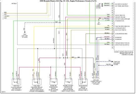

I need the curcit that powers coil. I thought thats what I ask for cause I changed the coil. I thought it had something to do with a timing senser like crank or cam.

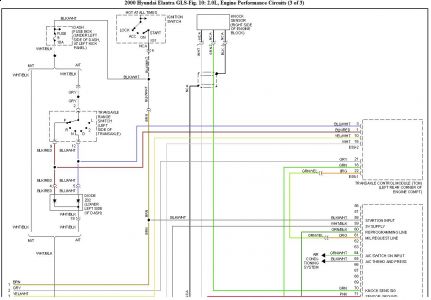

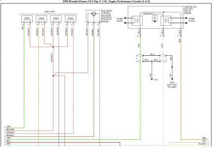

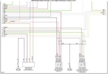

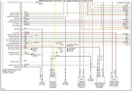

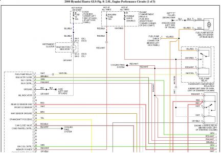

Sorry if the information provided does not meet your requirements. The PCM grounds the Green and White wire to induce sparks to the ignition coils with power from the ignition switch. Ignition Coil Ground Circuit Test Turn ignition off. Disconnect ECM 88 -pin connector and ignition coil 3 -pin connector. Check for an open or short between ECM connector terminal No. 25 and coil connector terminal No. 2, and between ECM connector terminal No. 52 and coil connector terminal No. 3. Repair circuits as necessary. Here are the complete schematics of the PCM controls.
https://images.2carpros.com/forum/automotive_pictures/192750_EngPerformance00ElentraFig08a_1.jpg
https://images.2carpros.com/forum/automotive_pictures/192750_EngPerformance00ElentraFig08b_1.jpg
https://images.2carpros.com/forum/automotive_pictures/192750_EngPerformance00ElentraFig09a_1.jpg
https://images.2carpros.com/forum/automotive_pictures/192750_EngPerformance00ElentraFig09b_1.jpg
https://images.2carpros.com/forum/automotive_pictures/192750_EngPerformance00ElentraFig10a_1.jpg
https://images.2carpros.com/forum/automotive_pictures/192750_EngPerformance00ElentraFig10b_1.jpg
The crankshaft position sensor is the main sensor for signalling the PCM to induce sparking and injector pulses. Othere sensors that might cause no starting are : Intake Air Temperature ( IAT) sensor. Throttle Position ( TP ) sensor. Engine Coolant Temperature ( ECT ) sensor Mass Air Flow ( MAF ) sensor .
