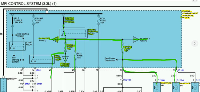

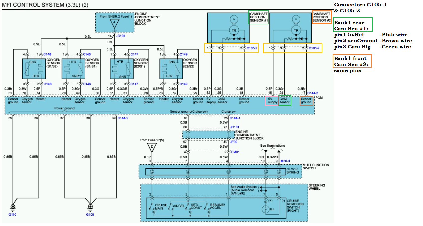

If the last Oxygen sensor (4th) caused the fuse to stop blowing, you should check the resistance of the heater circuit internal to that sensor. I'm not sure which one you mean by 4th, but if the heater internal to the sensor shorted out, it will blow that fuse. Have you replaced the fuse with leaving that oxygen sensor unplugged and it still will not start? I know the chance of the Oxygen sensor heater being shorted out after all this does sound like a fair chance, but I have seen stranger things happen.
As for the power feeds to the coils and injectors, that shouldn't matter, but the control wires will matter. If the plugs are wet and fouled out with fuel, the injectors are working, the question is do you have spark.
So, we can have you check that oxygen sensor that you unplugged for a short, either in the sensor or in the harness with a test light. If you want to do that let me know,
But if you're going to test for spark at each coil, I think you should unplug the Injectors, so the cylinders don't get washed out with any more fuel. You can pull the SNSR 3 fuse 10amp which powers the injectors or unplug each one.
And then check for spark at each coil, I know this vehicle is very difficult to work on because they colored all the wires the same, that's makes this whole thing much harder. If the cylinders got washer out with a lot of fuel, that also lowers compression because the oil get washed off the cylinder walls, and I'm sure your oil is diluted with gas now as well.
So, you check for spark, and we can concentrate on getting the vehicle started first or, we can check the oxygen sensor and try to find that short, if that fuse is not blowing, you can leave the sensor unplugged for now. Just let me know what you want to do first.

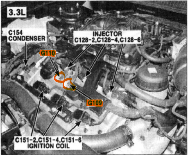

The fuse is not blowing since I unplugged the 4th or last one. I tried to start the car after I unplugged each one and the fuse blew until I unplugged the last one. I was going to plug them all back in except the last one and check the fuse again just to make sure and leave the last one isolated. Does that make sense? I do want to check for spark. Some of the coils might be damaged since I was hardheaded and tried to fix the wiring issues without checking with you or looking at a schematic. I have a couple extra coils but I'm not sure they work since they came from junkyard. I guess I need to know the correct way to check for spark. Do I pull one coil at a time and ground it to see if it arcs? Do I leave the spark plug in it to see if fire comes from that? I will pull the fuse to the injectors first and you are right, the oil is contaminated with gas. Thanks for your time and help.

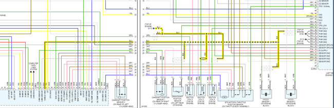

To check for spark, pull the coil out, keep it plugged into the harness. And put either a spark plug or spark tester into the coil. I have a bad feeling that if the wiring was wired backwards to any of the coils or to the injectors, meaning that power was put directly to the control side on the component, it might have burned up the ECM driver for those coils or injectors. It's the same as a short circuit directly to the ECM driver if they were wired backwards.
Here's a guide for checking spark. If you have no spark on some coils, we'll check for any drivers that are shorted out.
The ignition coils and injectors are driven by a 3-pin device called a power mosfet or transistor. It switches the ground side of the component off and on to fire the coil or injector. When they get shorted out, what usually happens is the mosfet will get fried and be shorted directly to ground permanently. If the coils feel hot to the touch and there is no spark, that's not a good sign, but check for spark first. I'll draw a little diagram to show how the ECM drivers work and can burn out.
https://www.2carpros.com/articles/how-to-check-for-ignition-spark

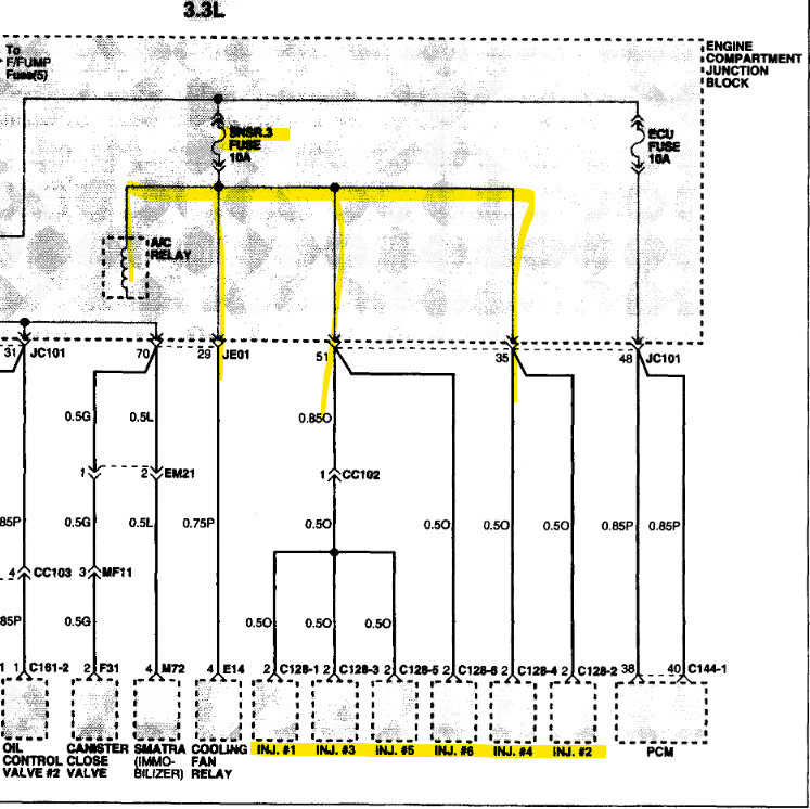

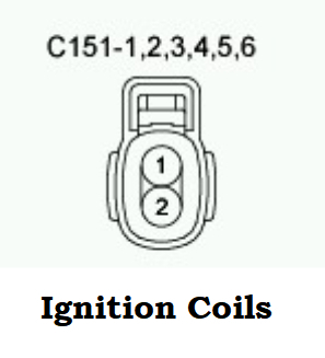

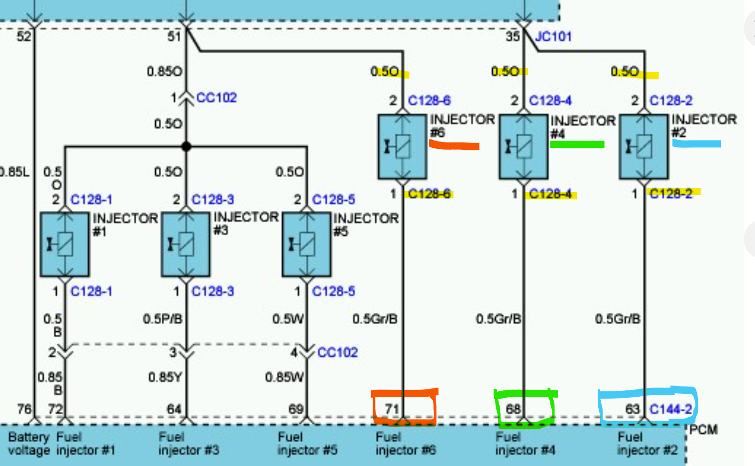

Well, each coil has 2 wires on each connector, looking at the engine from the front of the vehicle cylinder 2 is on your left and cylinder 6 on your right, 4 in the middle. And you should be able to identify the power wire by just turning the key on and check it with a multimeter with the other meter lead on battery negative. Only 1 wire on each coil will have 12volts, the other wire is the control wire. Pin 1 is the power feed; the original wires would have been pink.
Same with the Injectors, one wire should have 12 volts with the key On. Pin 2, orange wire was the original power feed color for the injectors. But verify them with a multimeter to be sure they are correct. You may have not fried the ECM drivers since you still had a load in the electrical circuit. The coil or injector would be a load in the circuit. How the Oxygen sensor shorted out, that is to be seen yet.

So, if you had a blinking check engine light, that's a Catalytic Converter damaging misfire alert. Do you know if a code was set for the reduced power mode? If you were resetting the ECM for it, then there was a code setting every certain number of drive cycles. Are you not able to reach the back 3 coils to check spark with pulling the intake plenum off? You can check for the ECMs control of injectors by hooking a test light to battery positive and probing the connectors control wire. And you should get a dim flashing test light, that's the ECM turning on and off the injectors ground side.

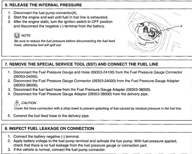

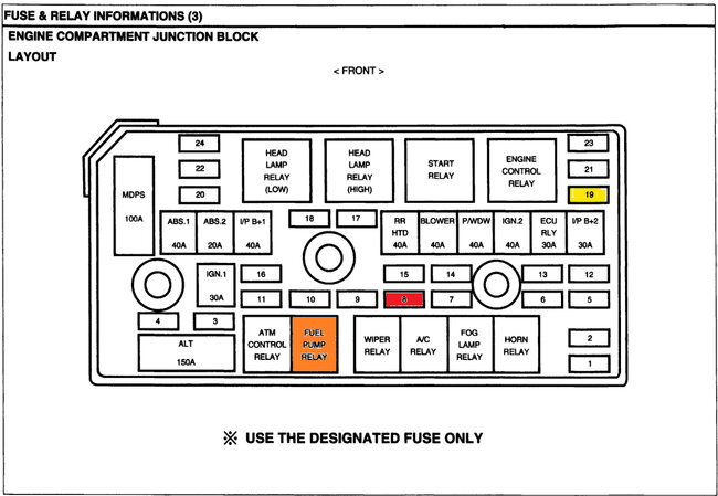

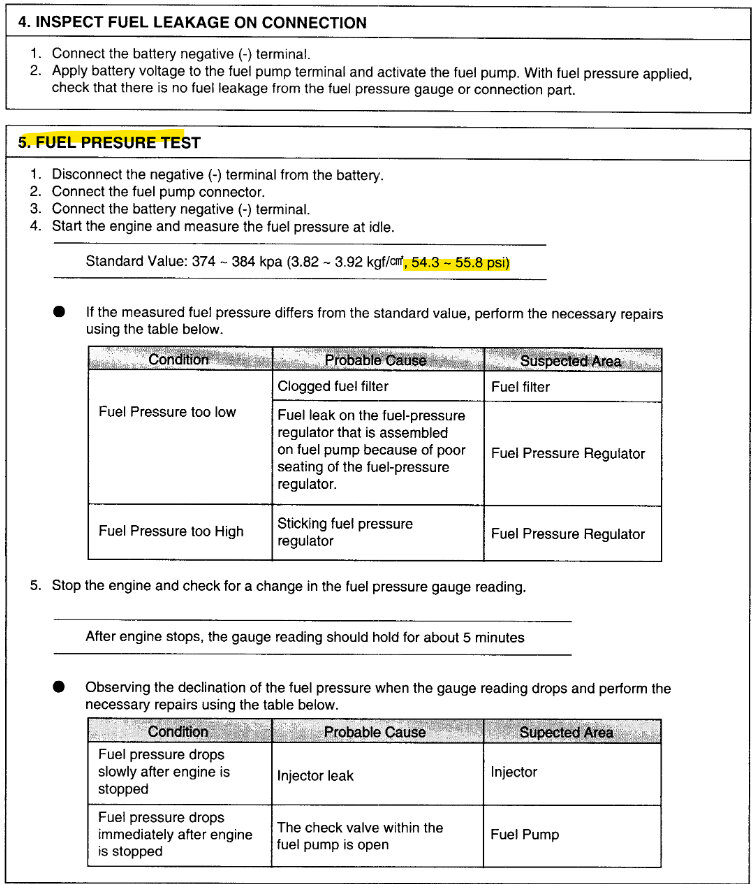

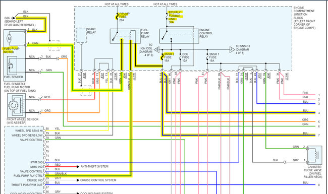

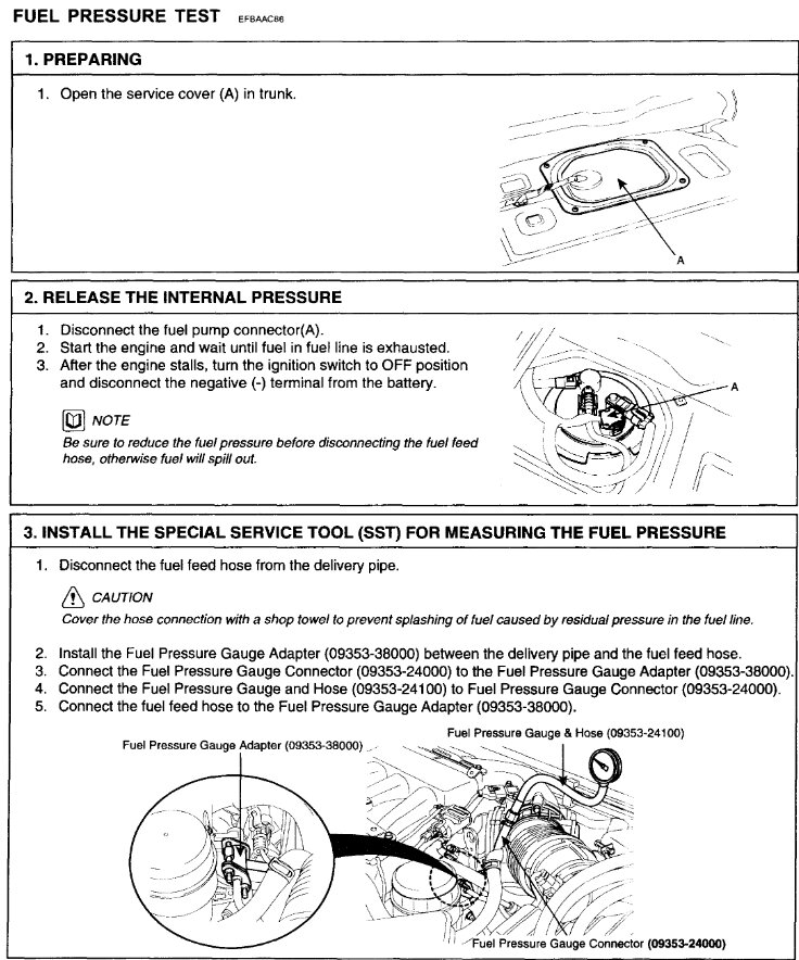

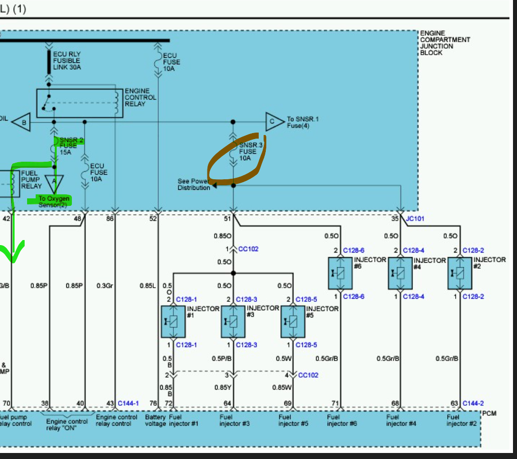

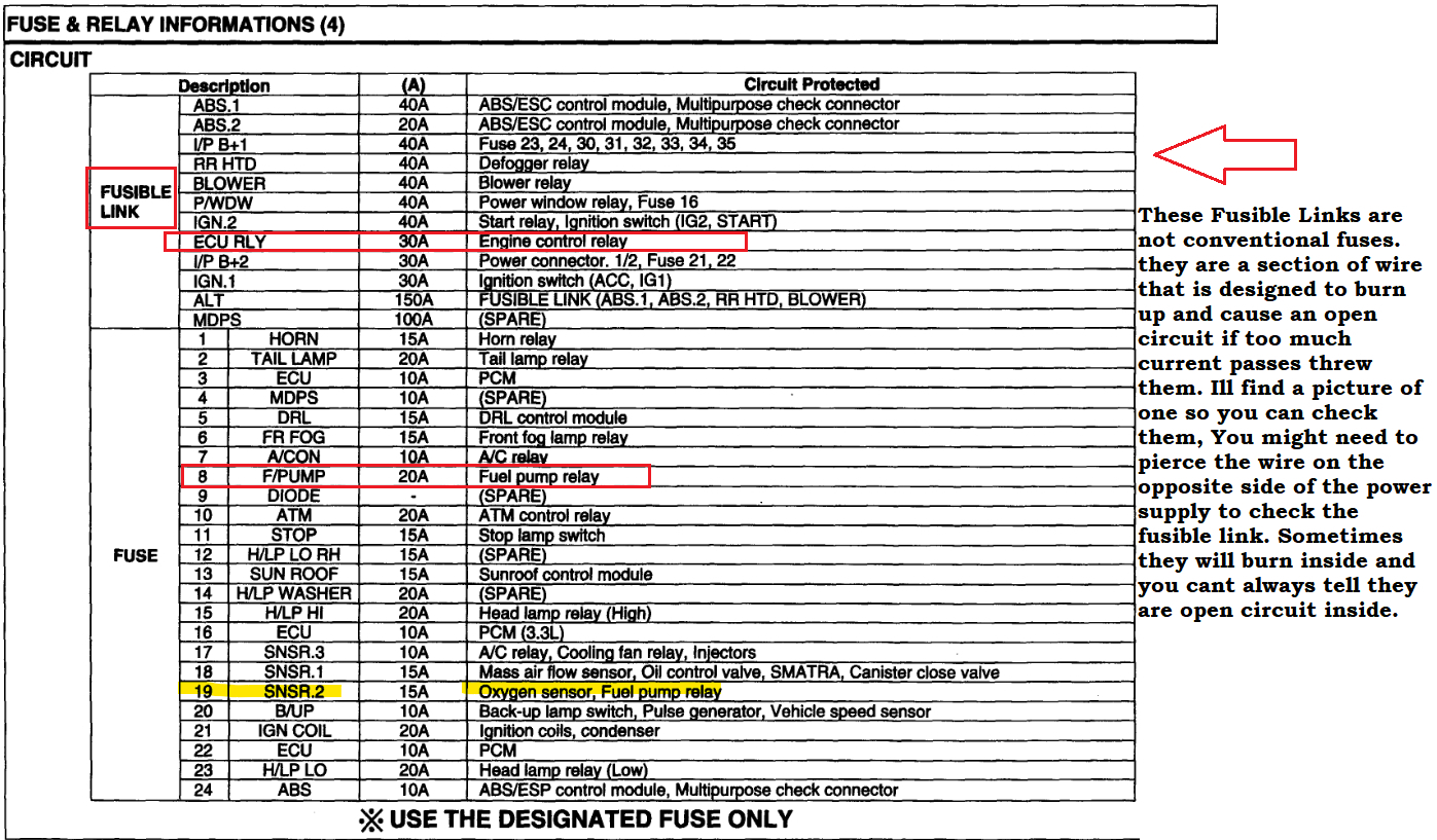

As for fuel pressure it looks like there is an access panel in the trunk, I'll put the instructions for a fuel pressure test, although with this fuel pump relay being on the same circuit that was blowing the oxygen sensor fuse, you should check the rest of the fuses in the engine compartment fuse block, since we don't know yet what is causing that fuse to pop. To do this fuel pressure test you have to T into the line, but when you turn the key to just the on position you should hear the fuel pump run for a couple of seconds to prime the system. Maybe have the trunk open and get to the access panel and have someone else turn the key On and see if you hear the pump, from the top of the access panel you should hear the pump with no problem, they are pretty loud. It looks to be under the carpet in the trunk area. I will see if I can locate what number this F/PUMP fuse 20amp is in the fuse block. I'm wondering if there are more chewed wires, it sounds like the rodent really went to town on the wiring harness.
Fuse #8 is the Fuel pump fuse that feeds the load side of the Fuel pump relay
Ok in diagram 7 are the fusible links, I'm not sure why they call them fusible links because this is not the conventional style fusible link at all. But I also don't know why they colored all the wires the same color either, seems like anything goes with Hyundai in this case.

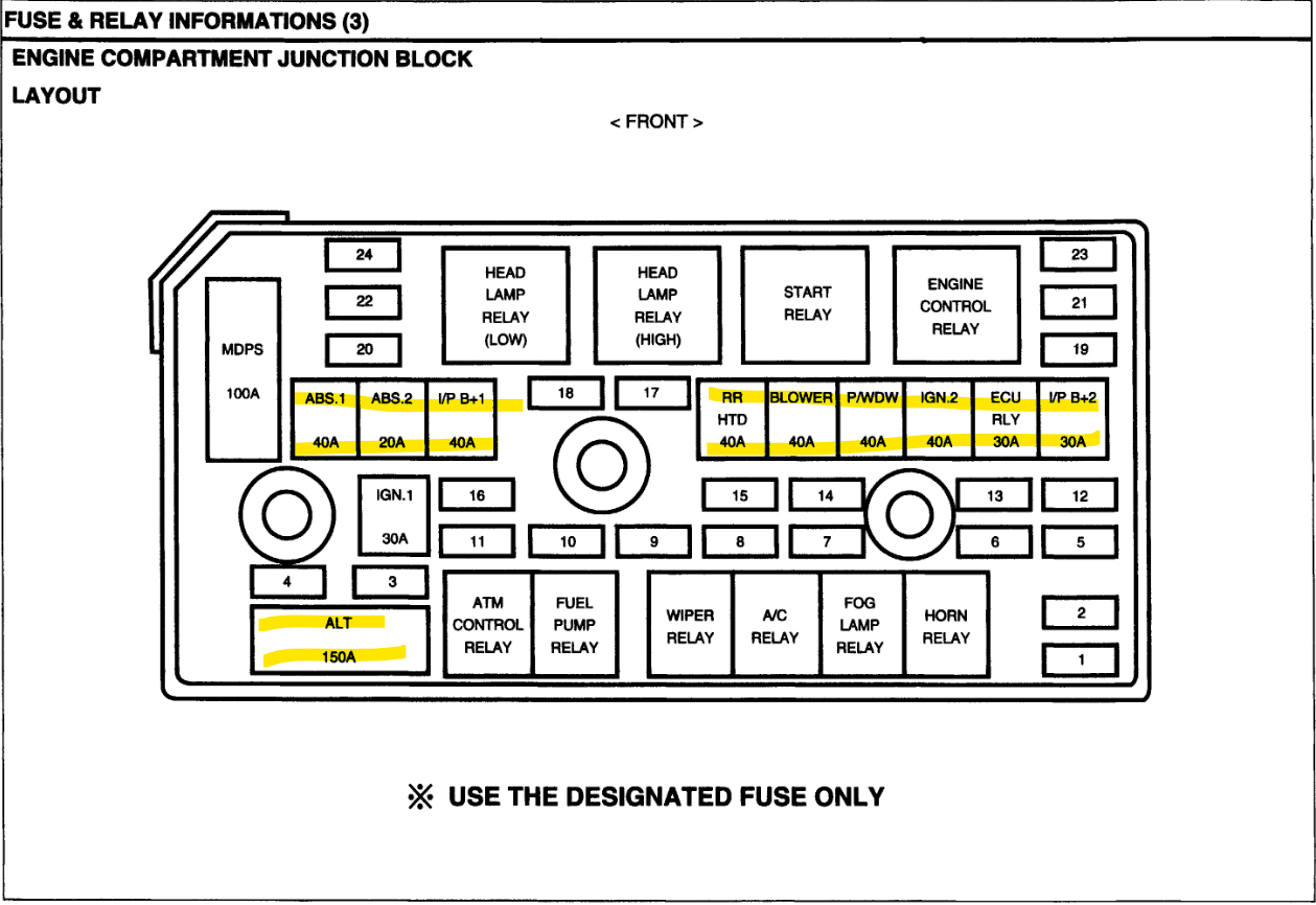

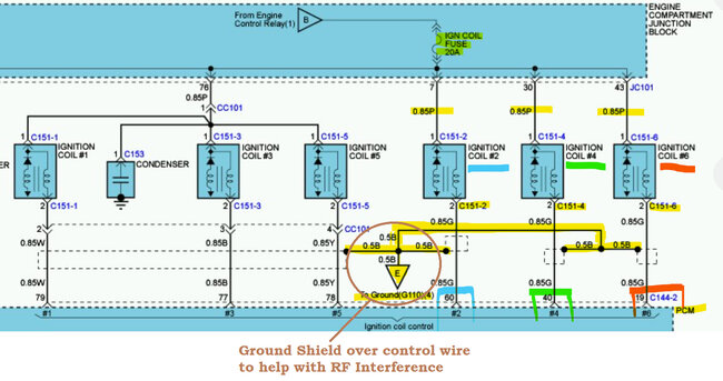

Are you missing spark at the back 3 coils and also the front 3 at the same time? Unfortunately, the power feed for the coils, the injectors, oxygen sensor heaters, and fuel pump relay all come through the ECU RLY Fusible Link 30amp. Then through the Engine Control Relay, and then branch off from there. So, you might want to check more around that fuse panel, If the harness is wrapped up in conduit and taped up, I don't think you'll find chewed wires inside there, I guess depending on the rodent size, but they will usually chew up the entire thing. I need to restart my page here, having some technical issues.
So, depending on if you're missing power on the back coils or control, it will direct where you look next, being that the PCM is located next to the Air intake tube and air filter box, you might want to just pull all that out of the way. Looks like the PCM harness runs under the air tube, and since you have no spark back there, I'd be concerned with hydro locking those back cylinders and having to pull that intake off so many times, you probably just want to go through the entire engine harness. Checking the engine and chassis grounds. These Grounds in the 2nd diagram 109, 110 all go to the PCM, there is 5 there, all Black wires. If the rear coils wires are still there, then there is most likely going to be issues from that engine Junction Block (fuse block) to the PCM. The wiring in this vehicle is so different from the rear to the front of the engine.

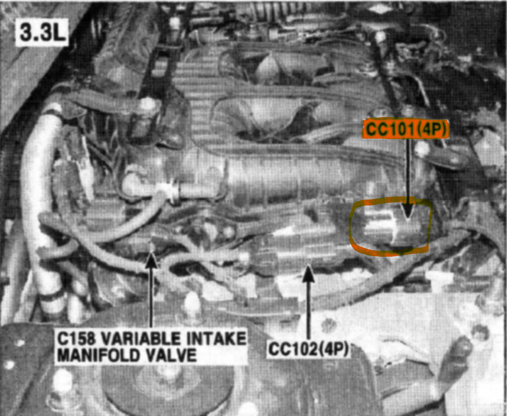

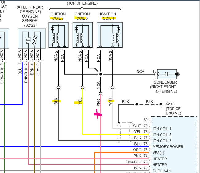

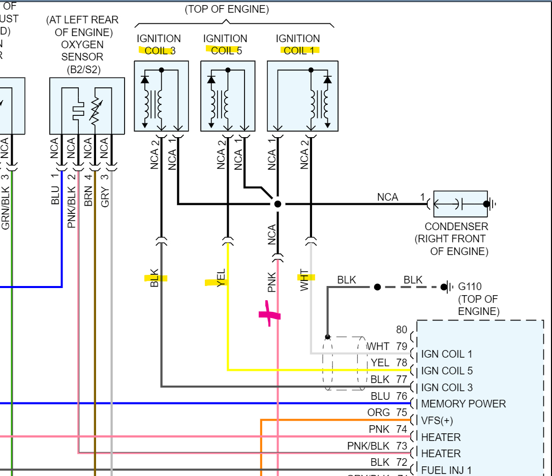

The back 3 coils run through a bulk connector CC101 for the control wires and a single power wire. Whereas the front coils have no connectors at all in series.

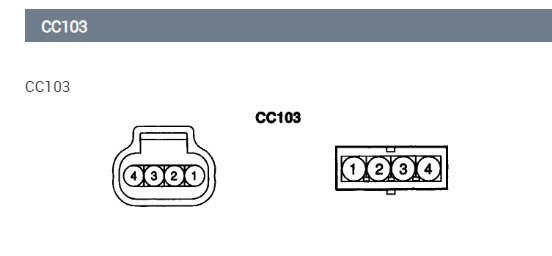

The CC101 is supposed to be a 4pin connector that feeds power to the rear coils on Pin 1 Pink Wire and the other 3 pins are the control wires for those coils. Should be White, Black and Yellow wires.
The CC102 bulk connector feeds the rear injectors. So, you could even just unplug that CC101 and check for resistance from the pink wire, to each of the other 3 wires one at a time, and you should be measuring the resistance of each rear coil, instead of having to pull the intake, then if anything is missing, you'll know what wires you're chasing.

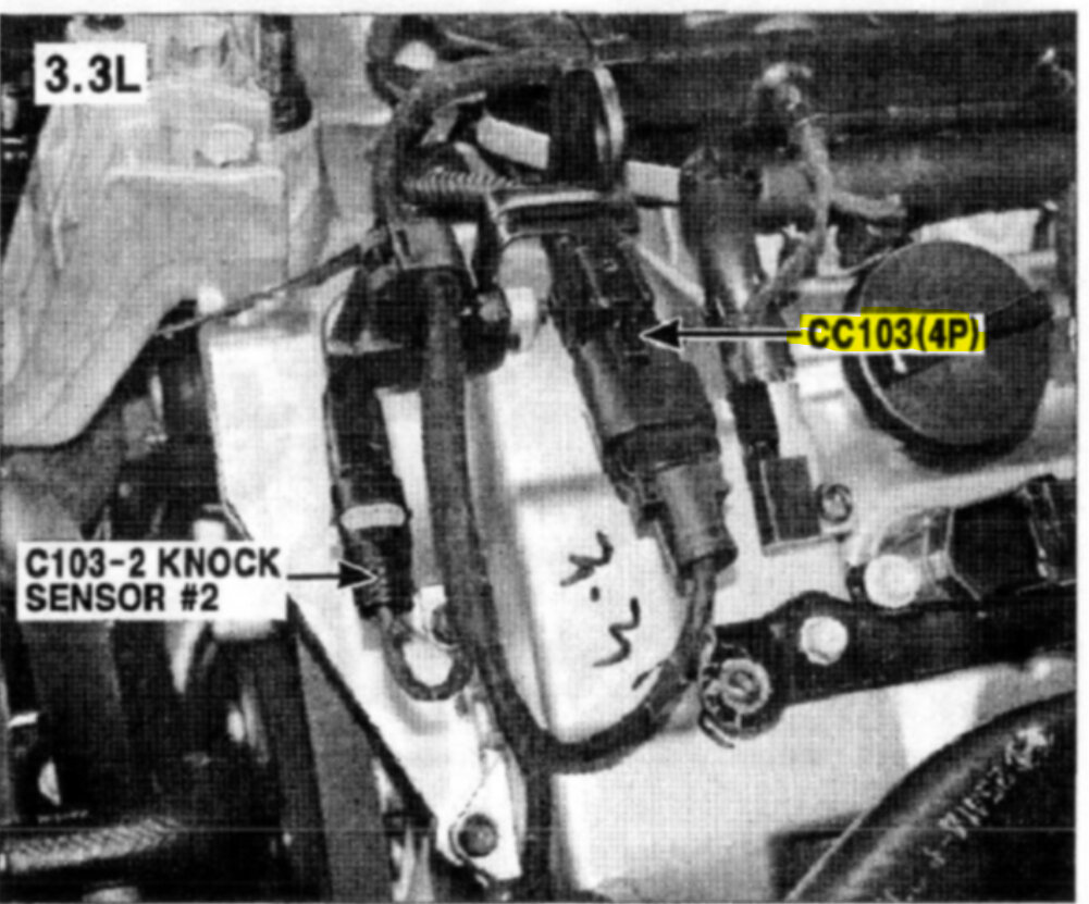

Sorry it to so long to reply. My dad is in the hospital again and I've been staying busy with him. He's 86 and he's in pretty bad shape. So sorry but I haven't had a lot of time. I did get the back coils firing it was C-101 causing problems I'm going to try and find another plug to replace it with. I went back through every wire that I had spliced. I put new connectors and shrink wrap on them. I broke a bolt off that goes through the plenum. I stopped there I'm going to fix the broken bolt today and I should be able to start it. Will let you know how it goes. Thanks

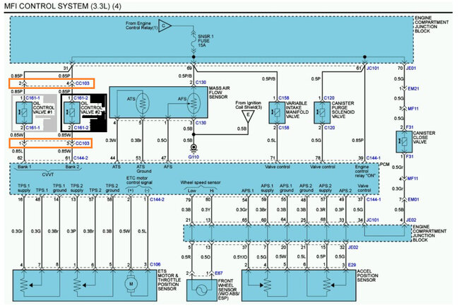

C101 and the other I guess it would be C102 need to be replaced. They were both involved with the rat she built her nest right those connections. She did chew them up completely but she damaged ctt101. That it wouldn't snap together and lock like it's supposed to. That is the long way to say it's a fitment issue. However, it's working now that I taped it. I'm going to check all the coils again in the morning. The only other thing that could be causing a problem is the 2 camshaft positioning sensors. They were involved also in rat damage. I'm not going to say I'm positive that the wires are going to the right sensor but I'm pretty darn sure they are. I'm going to look at it again, but I think the wires are the same color on both. Thanks again sorry to be long winded I'm just trying to tell you everything that I know even if it's not important Thanks again.

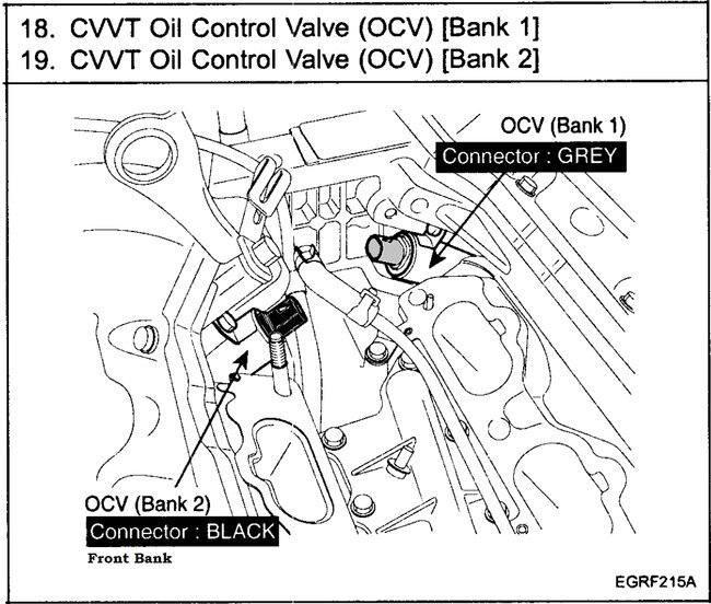

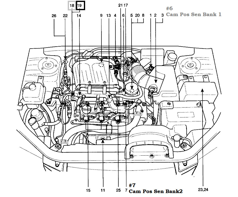

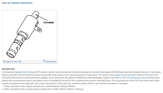

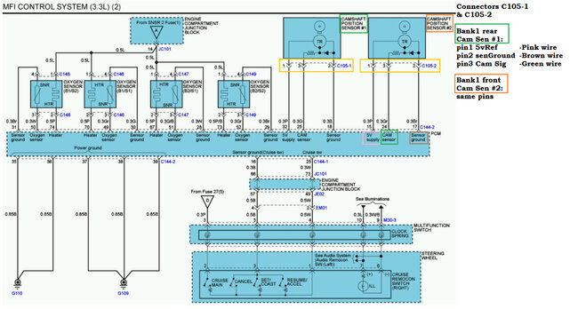

There are also wires going to the oil control valves on each cylinder head that are for controlling the variable valve timing, and of course on both cylinder heads they are a pink wire and a white wire, on the left cylinder head, which I believe is the front head, the white wire changes over to blue at Connector CC103, all 4 wires for the VVT control valves run through the CC103, I found CC103, the C105-1, 2 connectors are right at each cam sensor.

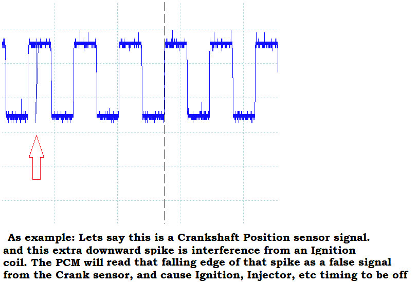

Now if the black shield wire is in any way spliced into anything, any coils, or injectors, that will cause and issue with the crank and cam sensors, those sensors use the same black shield wire over them to prevent interference from the ignition coils or injectors. Mostly the coils, if the coils are firing and any high voltage spikes are running through that shielded wire, it will absolutely interfere with the crankshaft or camshaft position signal. The 2nd diagram is my crude illustration of interference on a crankshaft position sensor signal from an ignition coil. Again, sorry for the long post.
