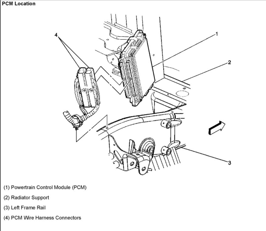

I good way to approach this problem is to clean all codes then without starting the engine turn the ignition key on and read the codes. If all codes are present then it sounds like the PCM has gone out. You in Texas by any chance?
Here is a guide to help you read the codes, codes readers are cheap nowadays:
If the engine computer is bad (PCM) I would try to find a used one that way it will be plug and play.
(Location below)
