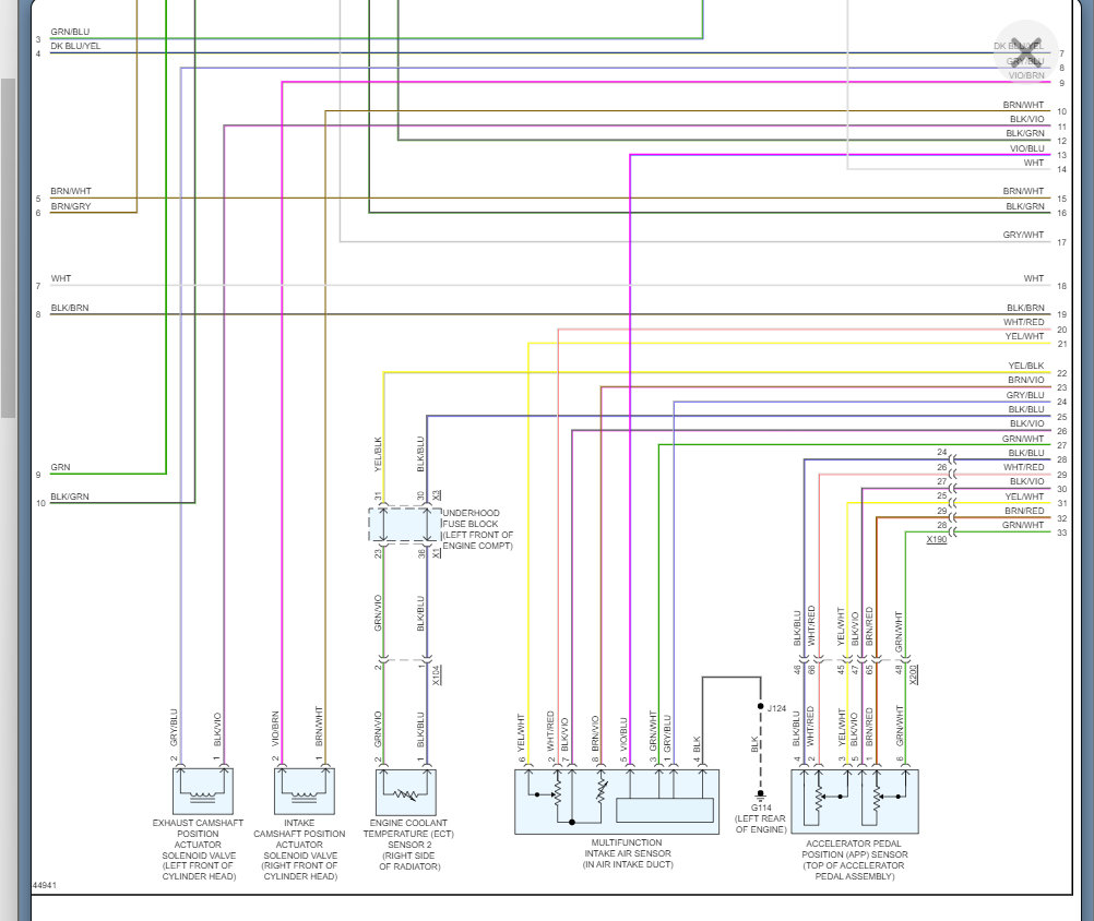

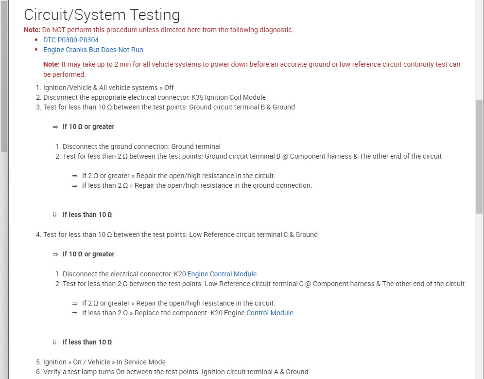

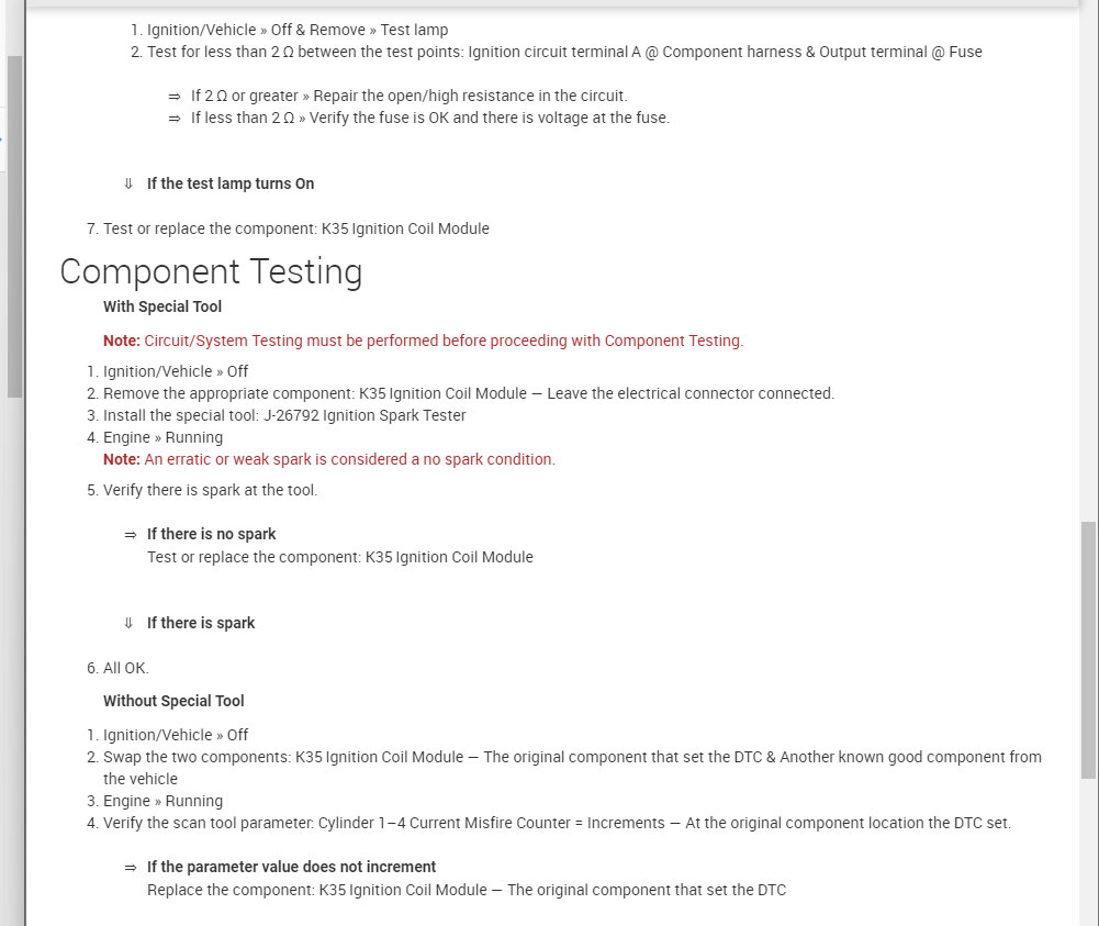

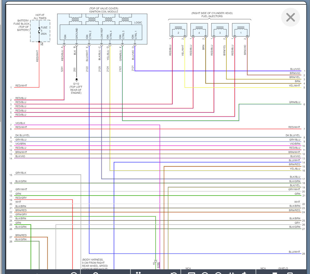

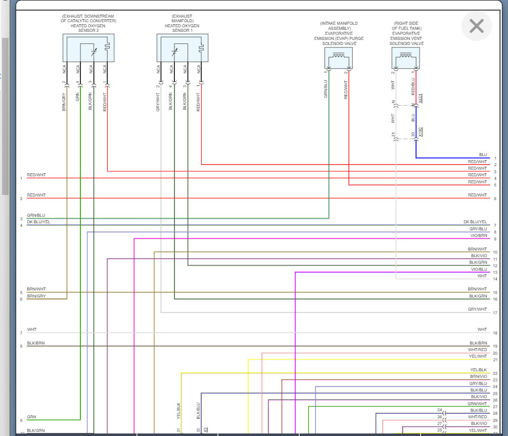

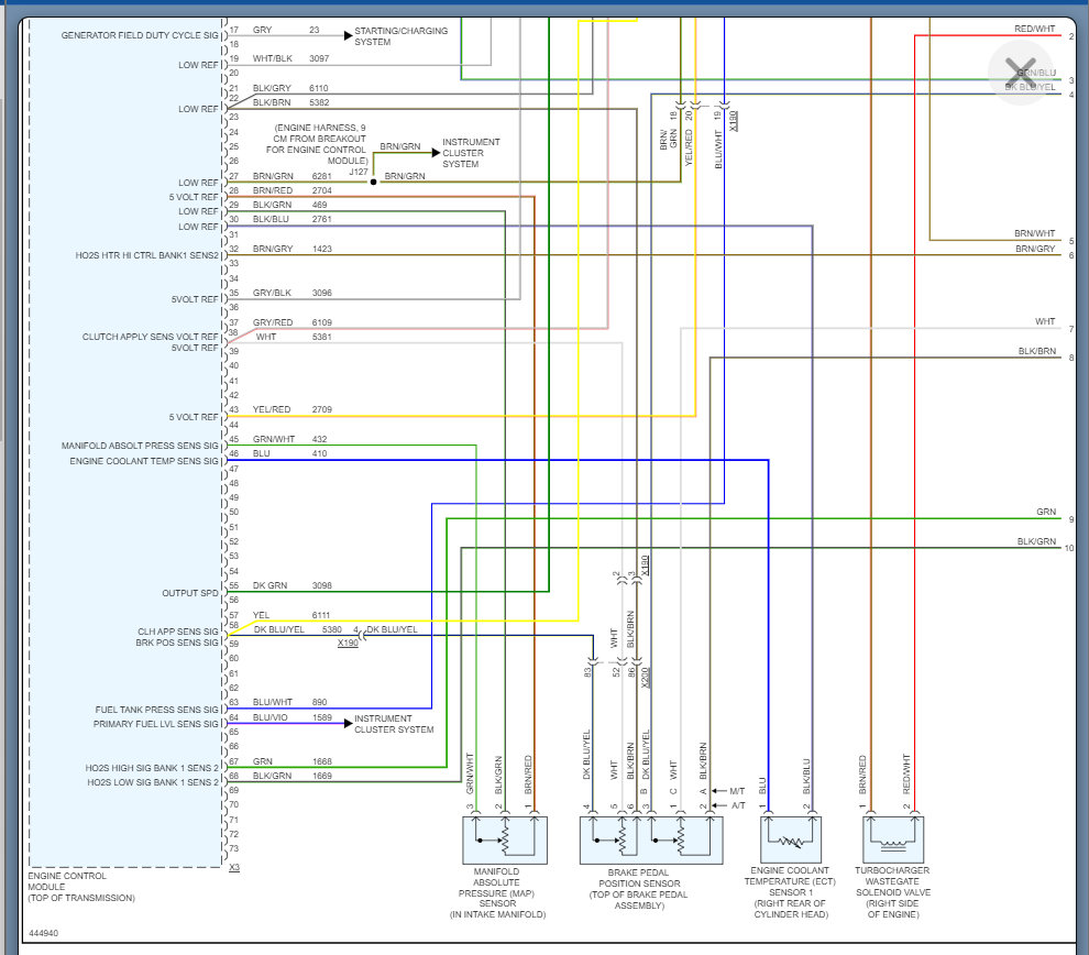

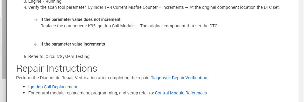

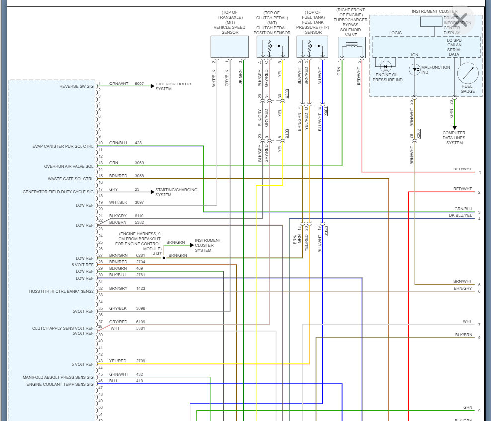

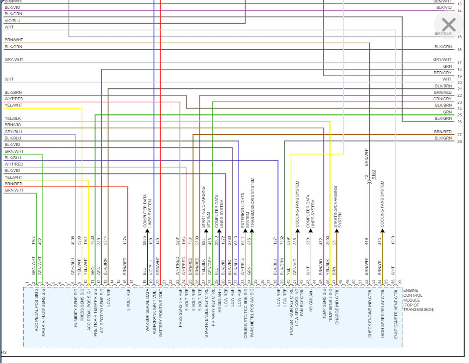

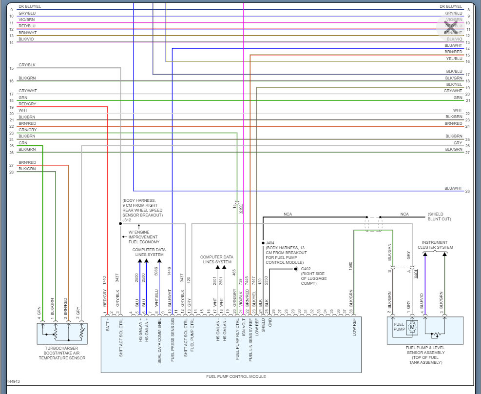

My brother came in with an engine check light on, engine was misfiring at idle, put the scanner on got a code "P0301 cylinder 1 misfiring". Swapped the spark plugs from cylinder 1 and 2 no fix, but found cylinder 1 plug to be a bit wet a small smell of fuel, check the wiring all looks good. Guessing the coil pack is faulty, cannot swap the coil around since it's a pack. Is there a continuity test or resistance check that can be done with a multimeter to confirm the coil pack is faulty? Try to listen for any vacuum leaks didn't hear anything. Should a cylinder 1 compression test be done? Should I be swapping fuel injectors 1 and 2 also?
Jun 11, 2022 at 9:02 AM
  • CAR REPAIR CONTRIBUTOR

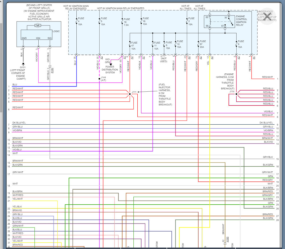

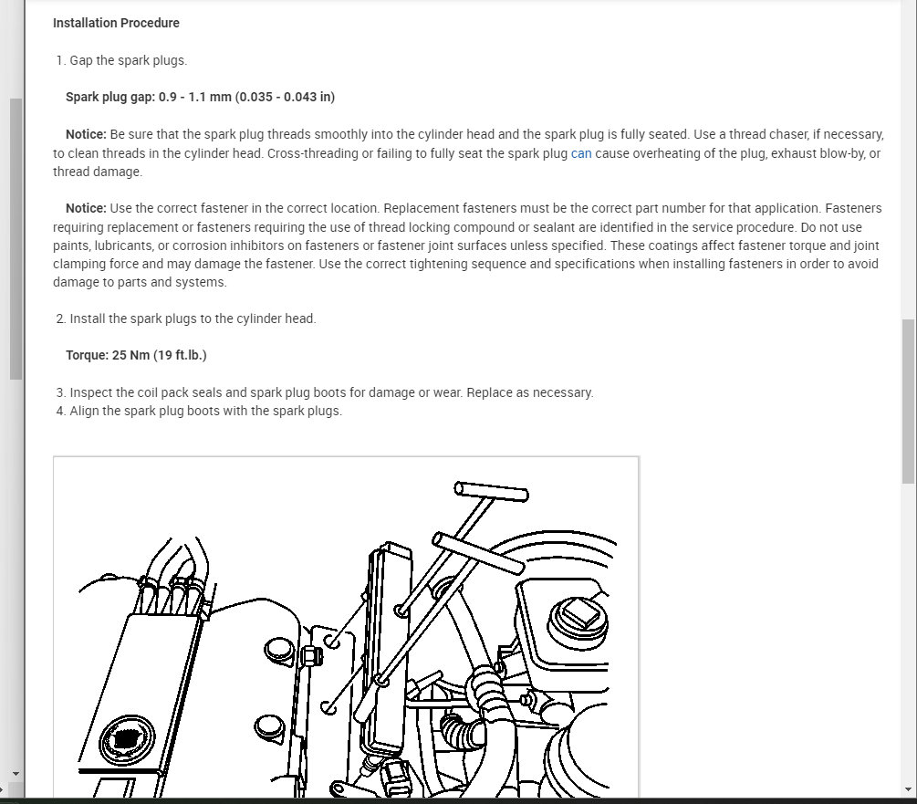

In short, yes, we have testing for this coil module.
I will attach it below, but here are a couple guides that will help with this testing:
Please see the attached testing and wiring diagrams and let us know what you find.
Please let me know what questions you have.
Thanks

I replaced the ignition coil, the misfire is gone engine running smooth. Can an ignition coil drain a battery?
Jun 23, 2022 at 3:09 AM
That is great that the misfire is gone.
As for the coil draining the battery, it can if it is shorted and causing constant power to flow through it to ground.
Which could cause the locking issue that you were seeing. Basically, when the battery is draining the control modules start load shedding and a lot of functions stop working just to try and save as much current to start the engine or the more important systems.
Great find and thanks for updating us.
