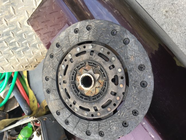

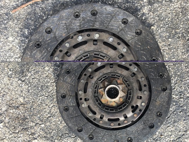

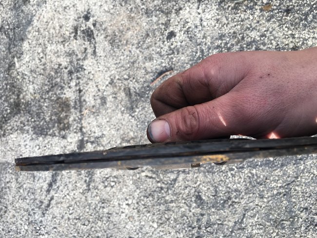

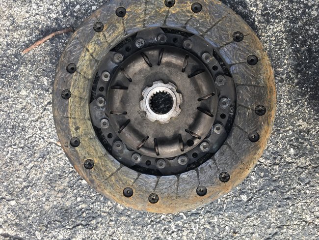

I changed the clutch in my car and after I got done I used a vacuum pump to bleed the clutch off the slave cylinder that’s on the transmission. Started it up it shifted gears good while stationary, but when I put it in gear it budges like an inch then slips makes the same sound it did before I changed it. Here is the picture of the old clutch. I didn’t think it was all that worn, it’s rough and has hot spots but I don’t think it was time to fail.

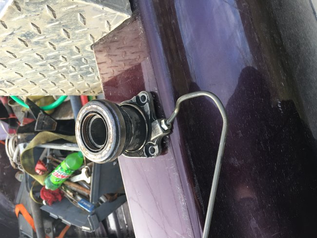

Can you see if the release bearing is fully releasing? I am concerned about the throw-out bearing?

It has a concentric slave for. The throw-out bearing the pedal feels right, but I have no sea how to tell if it is working. I’m working on rearing it apart to see if I may have accidentally put the clutch on backwards or got the torque wrong.

I assume you did replace the throw-out bearing as it is the slave as well?
+1
Saturday, February 16th, 2019 AT 1:45 PM
BTEC2012
  • 6 POSTS
Yea, I did replace the throw-out bearing but I didn’t replace the slave on the outside of the transmission where you bleed the clutch. I am a GM tech I seen at the eye doc told me it could be that.
Saturday, February 16th, 2019 AT 2:11 PM
Most definitely. It is not allowing the bearing to release.

I took it all apart and found the culprit the dual mass flywheel seems. Broke the part the pressure plate bolts to is spinning freely and the new DMFlywheel I ordered (which is the wrong size unfortunately, they sent the first design 8.5 inch I need the second design 9”). It does not spin freely there seems to be springs or something in it to keep it with the flywheel. A least I found the problem.
