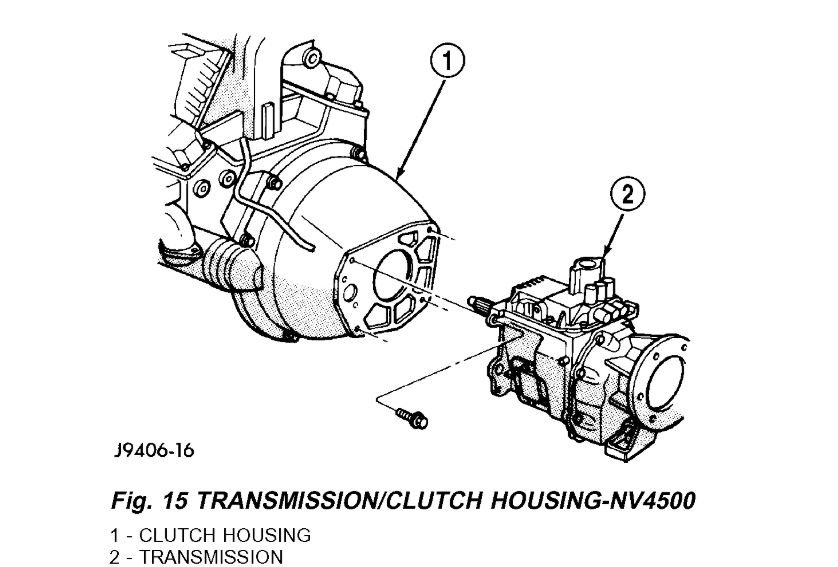

When I push the clutch pedal about halfway down it makes a grinding or rubbing sound it will not shift.

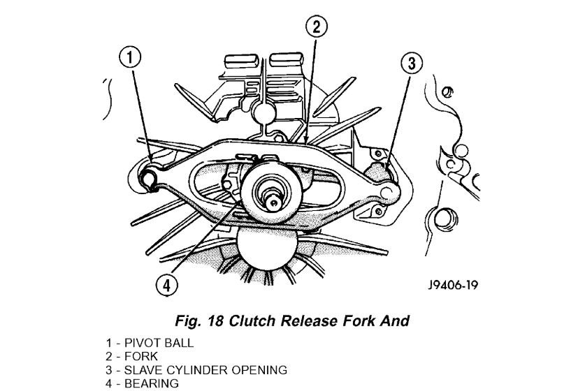

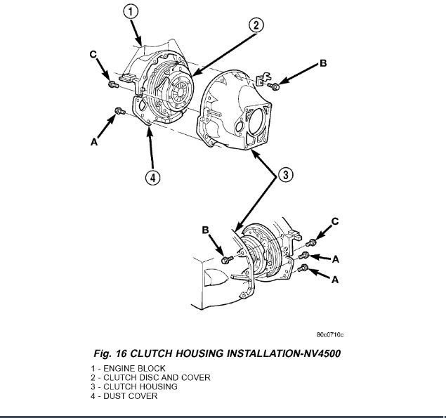

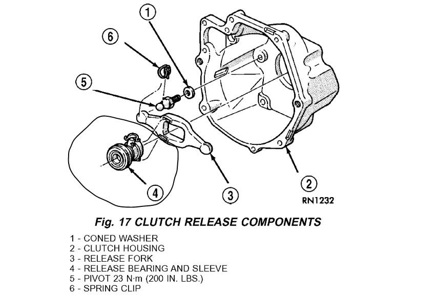

Sounds like the throw-out bearing in the clutch has failed.
You will need to remove the transmission and inspect the bearing, pressure plate and disc.
