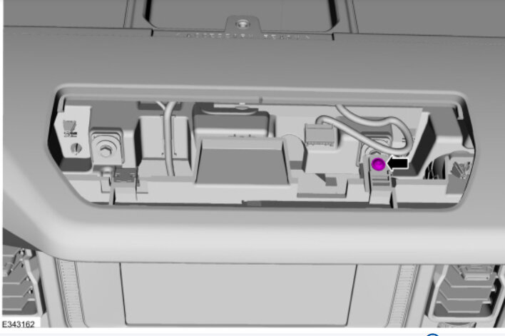

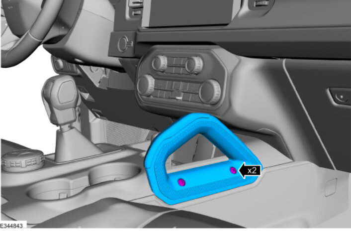

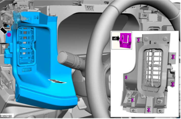

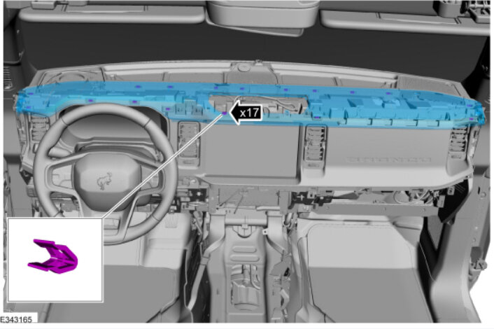

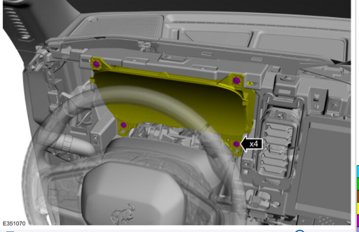

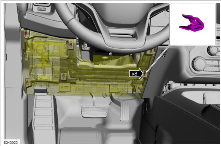

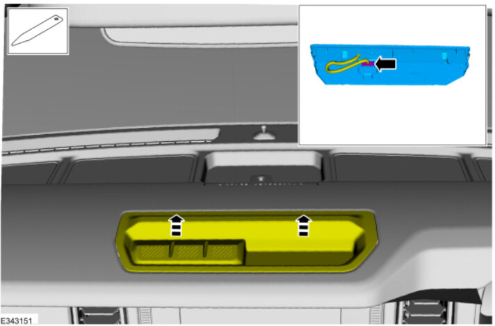

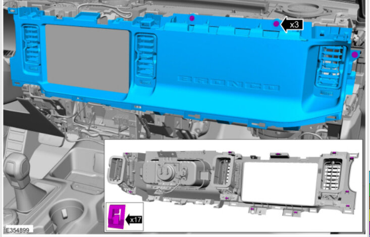

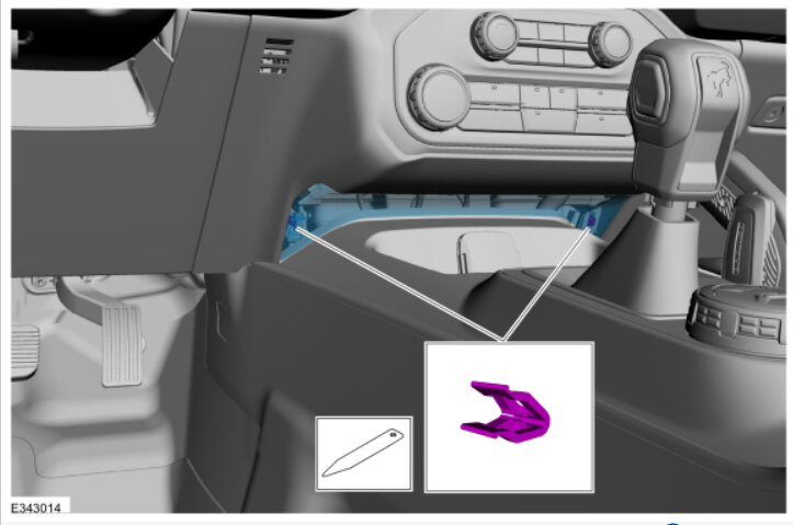

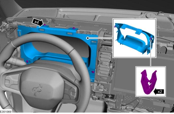

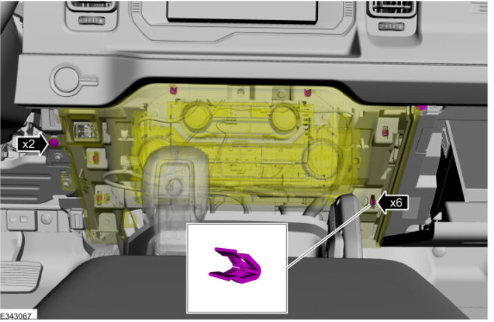

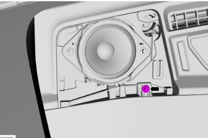

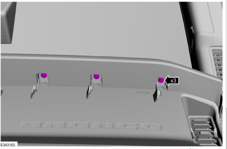

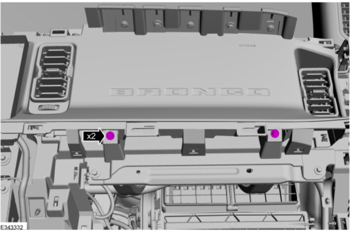

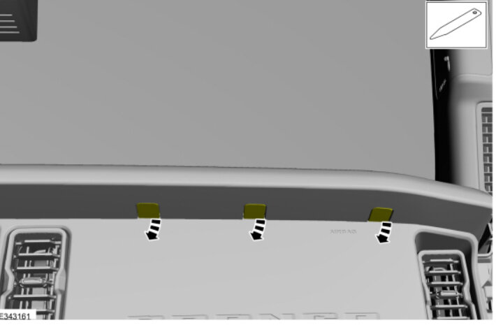

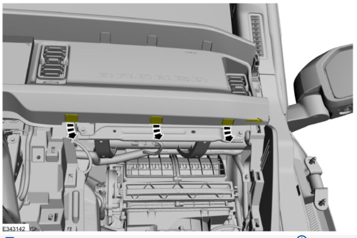

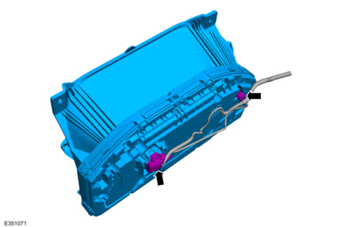

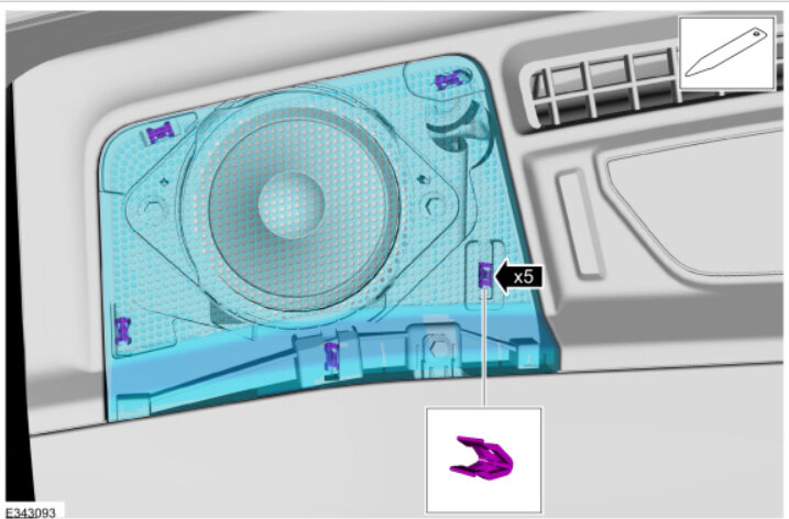

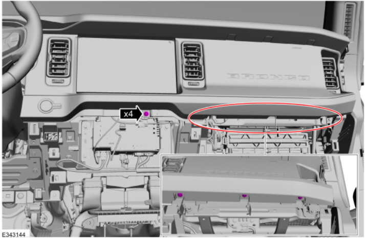

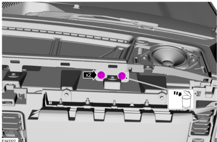

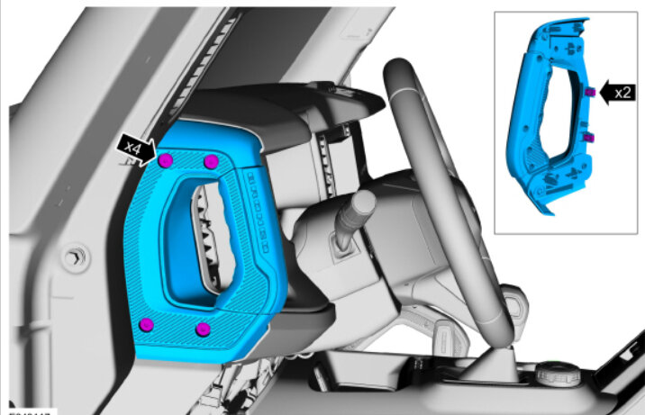

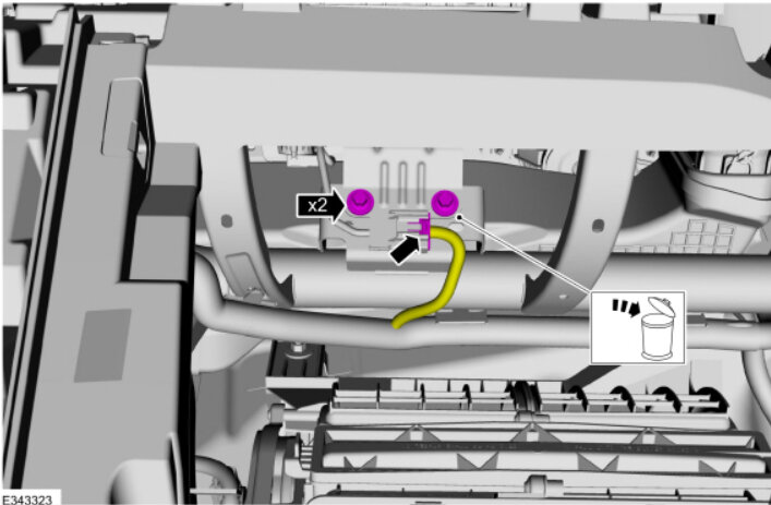

How to remove new 2025 full digital display cluster in ford Bronco
Monday, July 14th, 2025 AT 6:49 PM
KEN L
  • MASTER CERTIFIED MECHANIC
  • 55,450 POSTS
This is a job, the book gets 2.4 hours to do it, I would start by disconnecting the battery. Most of the dash needs to come apart. Here are the instructions on how to remove the instrument cluster. Check out the images (below). Let us know if you need anything else.
