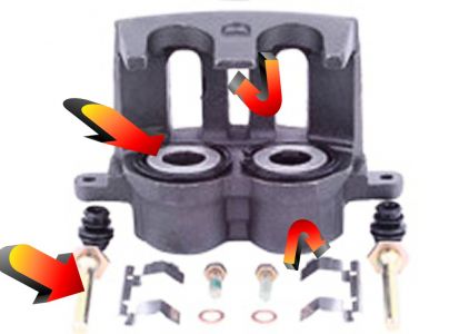

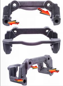

I would pull the wheel and get a look in the event they are thin. Otherwise I would pull the caliper and service the caliper, bracket and pads in these ares:
https://www.2carpros.com/forum/automotive_pictures/30961_caliper_lubeareas_7.jpg
https://www.2carpros.com/forum/automotive_pictures/30961_caliper_lubeareasbrack_7.jpg

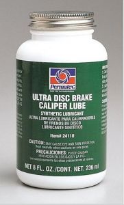

I prefer this product myself:
https://www.2carpros.com/forum/automotive_pictures/30961_caliper_lube_8.jpg
