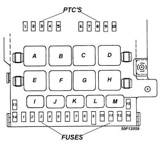

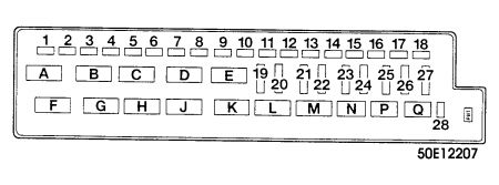

BMRFIXIT
  • 19,053 POSTS
The fuse block is behind the end cover at the left side of the instrument panel. Pull the cover straight away from the instrument panel for access to fuses. A Power Distribution center, for circuits that operate only under the hood, is located in the engine compartment. An identification label is located on the underside of the cover.
https://www.2carpros.com/forum/automotive_pictures/99387_chry_2.jpg
https://www.2carpros.com/forum/automotive_pictures/99387_chry1_1.jpg
