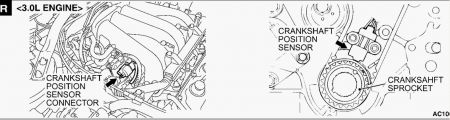

2004 Chrysler Sebring P0301 code
2004 CHRYSLER SEBRING
I was thinking about getting both the crankshaft position sensor and the camshaft sensor?? What is the tooth?
Before I actually look up a picture for you, what size engine and body style, coupe or sedan?
Apr 26, 2009 at 11:22 AM
[quote:5632bf7e5e="merlin2021"]Before I actually look up a picture for you, what size engine and body style, coupe or sedan?[/quote:5632bf7e5e]
I have a 2004 Chrysler Sebring sedan (not convertable), engine size V-6, 2.7
Apr 26, 2009 at 11:26 AM

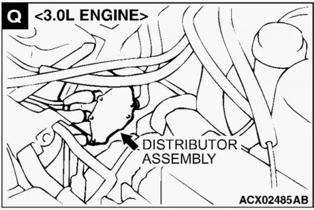

I show two locations for the crank sensor, on sedan it's on the left front side of the engine, on convert, it's on top right tranny bell housing. Cam sensor is on front of the cylinder head. The gear is the timing gear, not usually the problem, can be a problem if the magnetic ring gear is on the harmonic balance.
More research shows a higher probability it's the cam sensor or the target magnet that may have a chipped tooth. I will send the info to you. check the email! Target magnet may have been damaged!

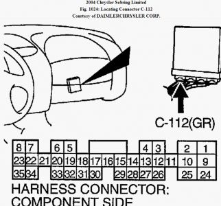

Apr 27, 2009 at 3:52 PM
Changed the crank sensor yesterday, cleared code yesterday, same code came back on this morning..
Should I even bother changing the cam sensor?
