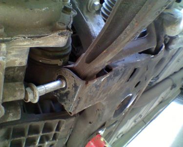

I am trying to remove the lower control arm (drivers) side and I am running into clearance problems with on one of the control bolts hitting the bottom end of the engine. I have pulled the front engine mount bolt and tried jacking the engine up but I am still need a 1/2 clearance to get the bolt out.
Suggestions?

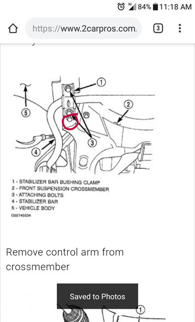

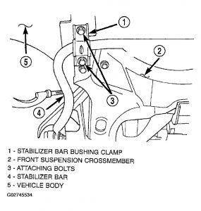

Have you removed stablizer
https://www.2carpros.com/forum/automotive_pictures/198357_Graphic_608.jpg

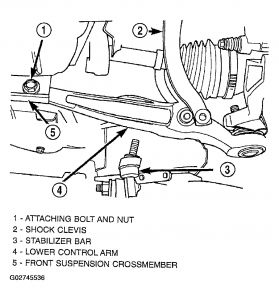

Remove control arm from crossmember
https://www.2carpros.com/forum/automotive_pictures/198357_Grafic_3_151.jpg

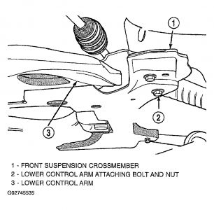

Then unbolt rear
https://www.2carpros.com/forum/automotive_pictures/198357_Grafic_4_36.jpg
is bolt 5 the one causing trouble? droping cross member will allow bolt to miss engine

LRDAYE
Yes, bolt 5 is the problem. It is hitting the bottom of the transmission
+1
Wednesday, September 8th, 2010 AT 11:28 AM
LRDAYE
Here is a picture of the bolt.....drop the cross member...this has turned into a big job !
https://www.2carpros.com/forum/automotive_pictures/570571_0908101134a_2.jpg

DOCFIXIT
  • 18,828 POSTS
Remove jack stand from crossmember remove bolt #2 in PIC 2 this will let crossmember to drop clearing trans.
Also may need to jack up trans use block of wood on jack saddle

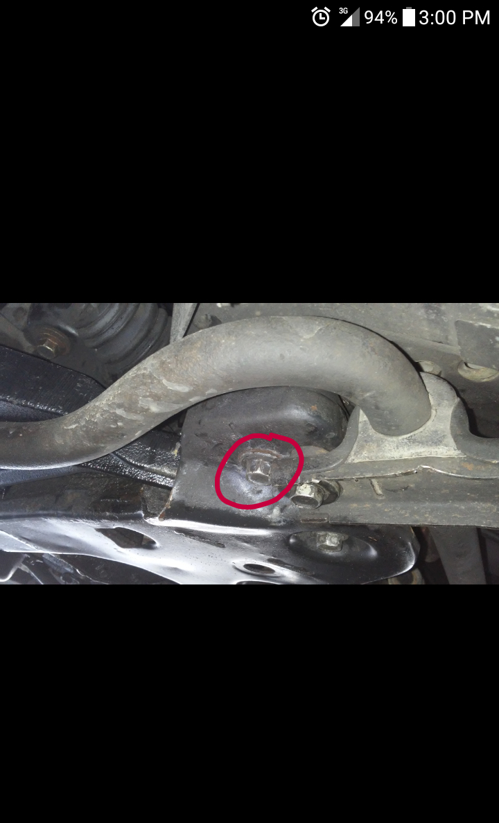

In the process of changing the driver's side lower control arm I ended up braking a bolt (to the body mount I think). I have looked everywhere and cannot find a way to the top of the bolt.
Tuesday, August 11th, 2020 AT 5:26 PM (Merged)
Good morning.
Can you post a picture of the broken bolt so I can see what you see?
Are you sure it is not a cradle bolt?

I am at work right now, but I will send a picture in a couple hours. We broke the bolt loose but it just spins in the hole and when I try to tighten it down it tightens about half a turn and breaks loose again so I can only assume it is broken since I cannot see the top. Also, lately I have been hearing a small popping sound. Could just be a loose nut, but I do not think so
It sounds like the nut is spinning at the other end.
Yes, please send me a picture.
FERLINM
  • 5 POSTS
From what I have seen I am going to have to cut a hole in the floor board and possibly the sub-frame.
The nut is tac welded on top. The weld broke.
Yes, you need to open the floor to access the nut to remove the bolt. Make sure you cover the hole back up when you are done.
Also, replace the nut and bolt.
