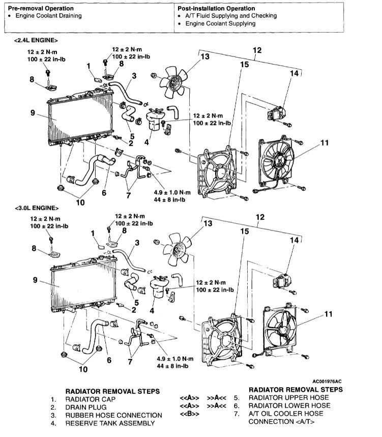

Several months ago I noticed when driving low speeds my car heater would just blow out cold air.I added coolant and the problem was corrected for about a month then the coolant level went down again.I had a mechanic check it for any leaks. He found no visible leaks-he checked the exhaust and the oil for signs of coolant and there was none. It's a big mystery where this coolant is going any help would be appreciated. Thanks Andrew

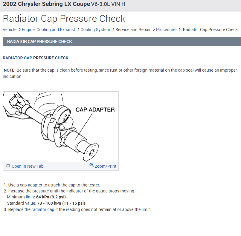

You might want to check your radiator cap.
Get it pressure tested and make sure it is performing at the correct pressure.
If the cap is not performing correctly it can release coolant thru the overflow. Which will typically drain to the ground and might not be noticeable as it will do that while you are driving.
The cap should be at 14 PSI.
