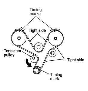

Need help on why my car will not start after changeing water pump. Have no spark to the plugs when I pulled them out what could be the problem

Check fuses
check relays (ASD) relay
check crank sensor
check timing marks
https://www.2carpros.com/forum/automotive_pictures/99387_chrys_1.jpg
