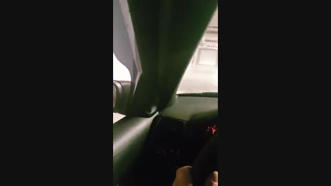

I have this strange noise when I let the gas go, from 2,000 RPMs to 1,000 RPMs, it only occures on this rpm range and mostly when the engine is warm, sometimes cold too. I cannot figure out what it could be. New DISA valve has been installed, I've sprayed belts and pulleys when the noise was present, and it didn't seem to change much. see video for sound.
https://streamable.com/8suh03

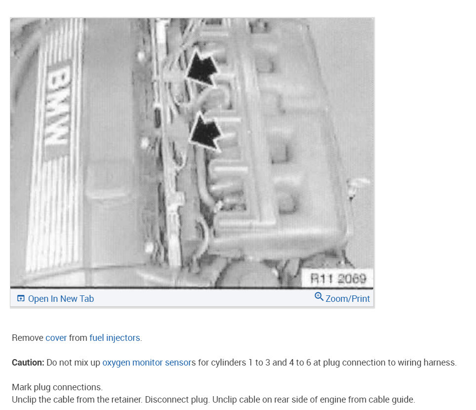

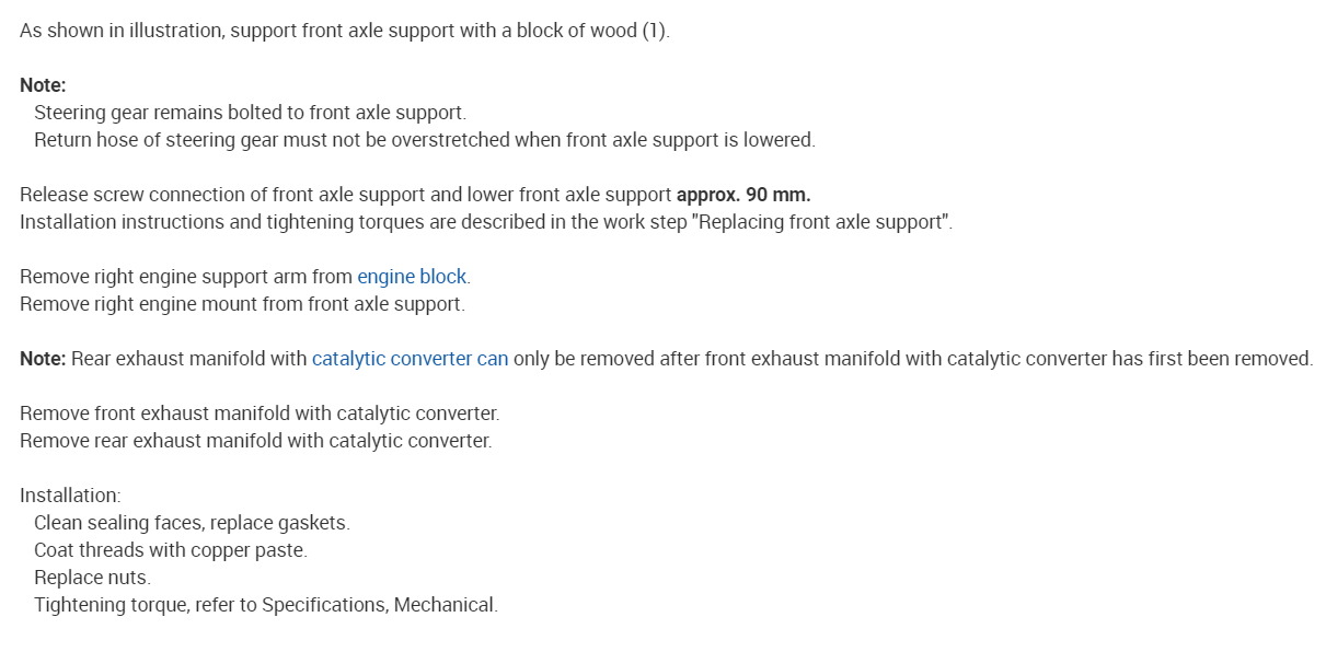

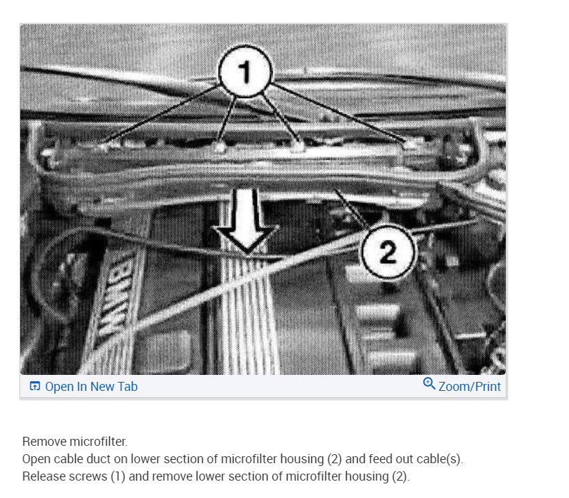

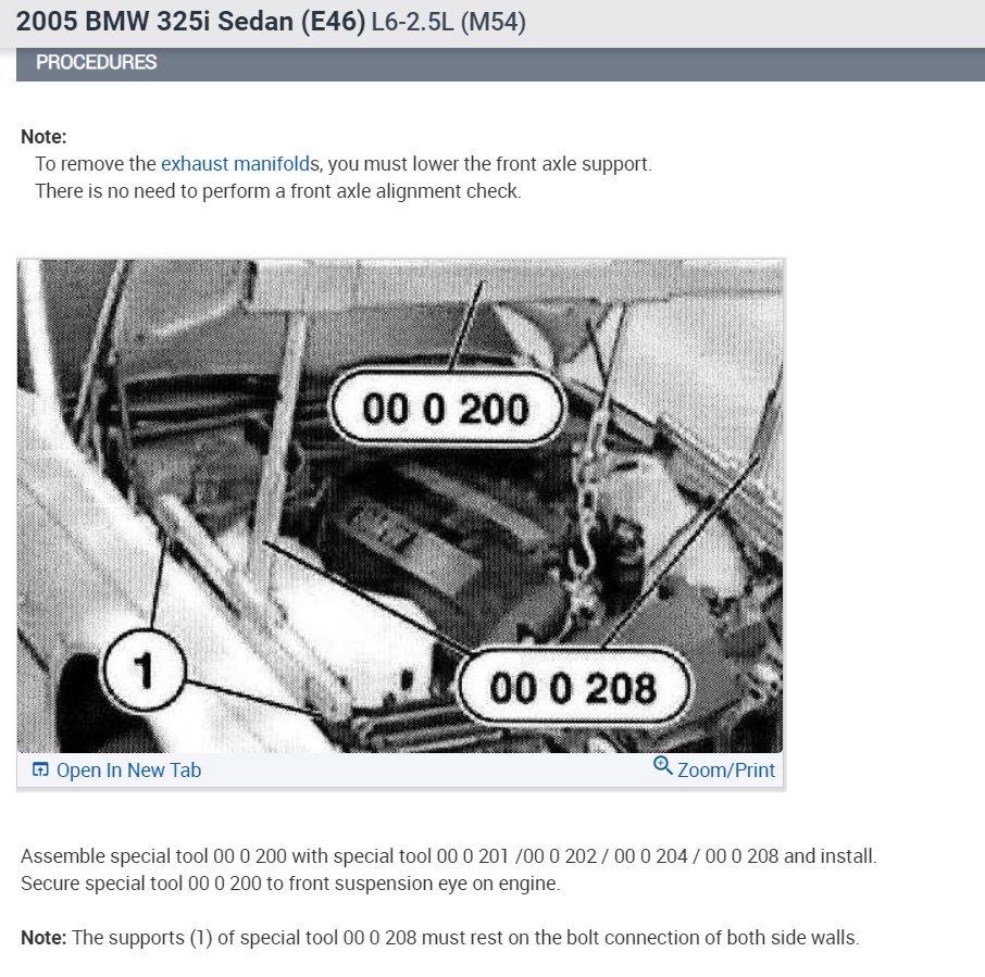

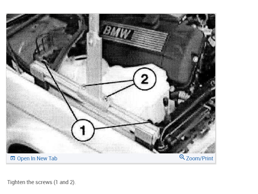

Does it seem like the noise is coming from under the car? It sounds like you have a catalytic converter that has fallen apart, jack the car up this guide can help:
Take a rubber mallet and gently strike the catalytic converter and mufflers to see if you can hear anything loose in there. If so, here is how to replace the catalytic converters in the diagrams below.

Okay, so, today I had some time to oil flush the engine, no metal shavings in the oil at all, the oil only had 4,000 kms but I was planning on changing it soon anyway because the car has been sitting a few years before becoming my property (prior to that the oil was 4 years old for 2,000 kms old).
Anyway, I tried to listen with a screwdriver mostly from the cover and the water pump, but it seemed normal to me (but I'm far from being an expert).
What I noticed better now is that the noise is coming from under the car. I made another video in my garage where the noise reverbs on the walls.
