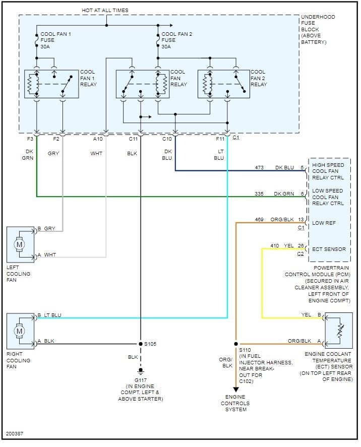

My cooling fans are not working. They do work when the A/C is on. I checked all fuses, they are ok. I changed the relay's and changed the coolant temp. sensor. What else could the problem be?

Thanks for answering my question. That's exactly what I just finished up with, changing the thermostat. No luck though. The fans still not working. There's not much left to check besides the PCM. Is there a way I can test that myself, or is that something I should have a garage check? Thanks again.

so the fans still won't come on, even when the temp gauge reaches the red area? if this is the case then yeah have a garage check the pcm.
Read these guides, they will help you figure this out
The wiring diagram for your cooling fans is attached below
