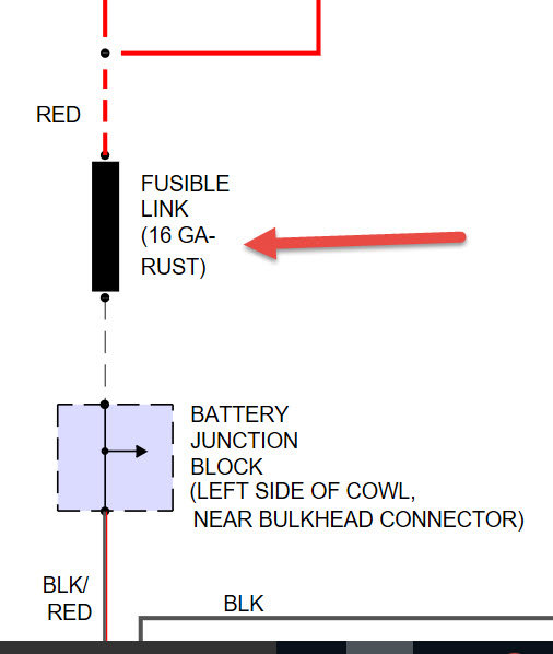

PAUL MOSLEY
  • 1995 CHEVROLET VAN
  • 5.7L
  • 161,000 MILES
Lights radio works. Put new solenoid turn key nothing happens.
Friday, July 24th, 2020 AT 12:33 PM (Merged)
HMAC300
  • 48,601 POSTS
Check for a burnt fusible link. See picture. Should have battery voltage on both sides. Assuming battery is in good shape and been load tested as well as clean terminal ends.
