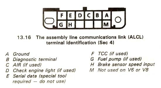

My wiring shows the Oil Pressure Sender having 3 connectors. With Tan: Orange: Gray wires going to the OPS. The tan goes to the gauges. The Orange and gray are part of the fuel pump switch. If there is pressure the switch is closed and you should read 0 ohms (use a volt/ohm meter) across the orange and gray. The ALDL connector (the plastic connector under the dash near the fuses. You normally short Connectors A and B pins and it flashes the engine error code. Pin G is Fuel pump relay bypass. Use a fused wire from 12V to it and try to start the engine.
Ping G is the lower left.
If it runs with fused +12V into pin G (assuming pin G is connected) I feel the oil pressure sender is bad or the wiring. You stated the engine runs for 2 seconds, hence the fuel pump relay works.

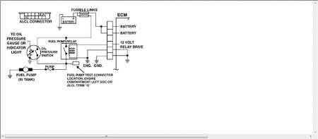

4psi of oil pressure and the FP/OPSU powers the fuel pump from there? If you temove the fuel pump relay and it dies out, replace FP/OPSU when south-Is this what you trying to explain?

Dunno how many psi needed to activate the OPS/FP switch. Around 4 would be at the low end I guess.
By putting 12V to pin G of the ALDL it powers the fuel pump directly. Which tells you everything is OK except how the fuel pump is powered, (if the engine runs)
Look at it this way. The fuel pump is normally energized in two different ways. 1) Start circuit. 2) Run Circuit
To start an engine GM uses a 2 second only circuit from the ECM to power the fuel pump. This circuit energizes the fuel pump relay. It is just wired differently, than the run circuit (ie not using the oil press sw).
The run circuit passes power through the oil pressure/Fuel pump switch. The Oil Pressure switch is just a switch between the 12V power source and the Fuel Pump relay. Bad switch and the relay does not work, and no fuel pressure.
If the switch tests good, connectors and wires have a habit of going bad for no particular reason.
