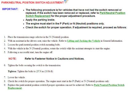

THE GEARS SHIFTER MOVES BUT THE AUTOMOBILE WILL NOT GO INTO GEAR WHEN I MOVETHE GEAR SHIFTER THE LETTERS ON DASH BOARD ARROW DOES NOT MOVE ETHIER.

Sounds like a bad transmission range switch.
