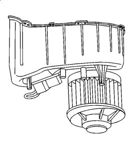

Are you able to tell me how to correct a load noise when I turn the front a/c to high. It makes a loud humming noise like something like a leaf or stick has lodged itself in the blower. I do not know where the intake is for this a/c or how to dis-assemble to correct this problem?

OK some info first. Does this noise only happen when you turn on the a/c or does the noise happen in heat modes too? Basicly does the noise come when the blower motor is running in any setting or only when you put it on A/C?

Yes, the noise comes from blower motor.A/c and heat alike. Considering the noise it seems to only hummmm when the blower is on high speed.

I belive the intake of motor has either sucked in some forein object (stick, leaf etc.) I don't know how to get to the intakes or disassembly to the motor?

Ok so have you pulled the blower motor to see if anything was in there? Once the blower motor is out then you can inspect it and even hook it up to a battery to see if makes noise then and if it does then you need to replace it.

Not sure how to get to motor

Ok first question blower motor is located under the hood it is on passenger side here is a pic of what you are looking for. Just unplug it and unbolt it and remove it check inside for any debri and then check the motor for noise.
