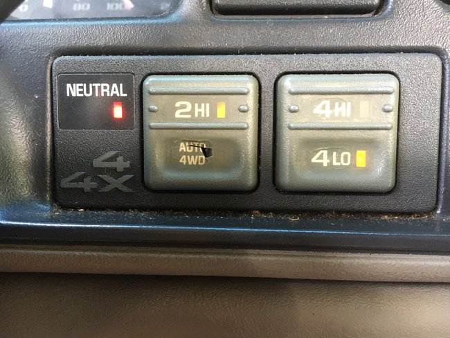

Feb 10, 2019 at 4:48 PM
Also,
When the fuse blows the lights on the rocker switches display an odd lighting scheme - image. Three lights are lit. The 4x4 low, the 2x4 and a red neutral light is indicating! This is when the truck is now in 2x4 and the fuse is blown.
Help.
Thanks.
Help.
Thanks.
Feb 11, 2019 at 3:21 AM
It sounds like the rocker switch is shorting out, lets try a new one to see what happens.
Feb 11, 2019 at 10:05 AM
Hi. Sorry for long delay. Takes two weeks to get parts out here in the middle of the Pacific.
So, replaced the rocker switch. Nice to see 4x4 and 2x4 actualy light up, but unfortunately still popping fuses. That is, when I switch from 4x4 back to 2x4 it switches but then the fuse (number 2 pops).
To date I’ve tried unplugging the actuator and rocking the switch (pops fuse) and replacing the rocker switches (still pops fuse).
As above, when the fuse pops, three lights are lit. The 4x4 low, the 2x4 and a red neutral light are all indicating.
When I replace the fuse, it immediately pops a new one (20 amp). I have then placed a 25 amp fuse and sometimes it holds and I can switch back into 4x4 where it will hold for weeks - until I switch back into 2x4 and the pop! All the fun starts again.
Any further suggestions of what I can test?
Thanks for your patience.
