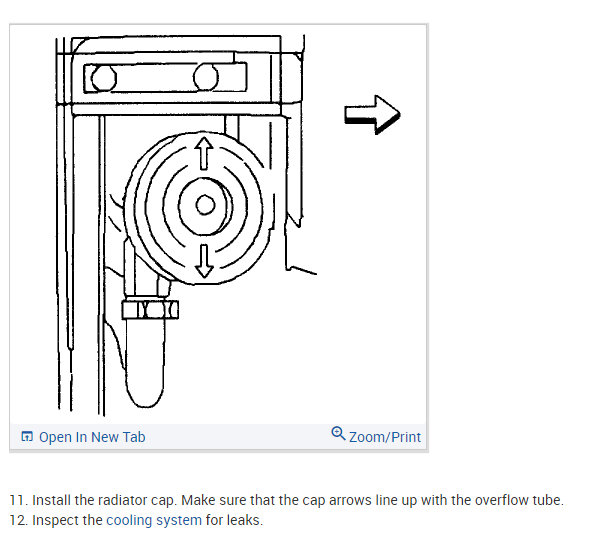

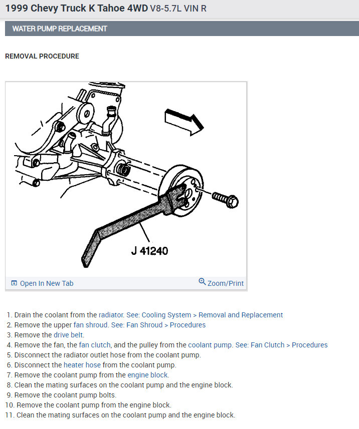

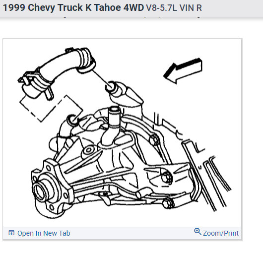

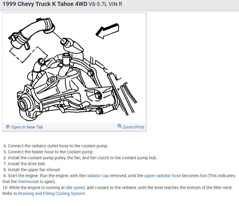

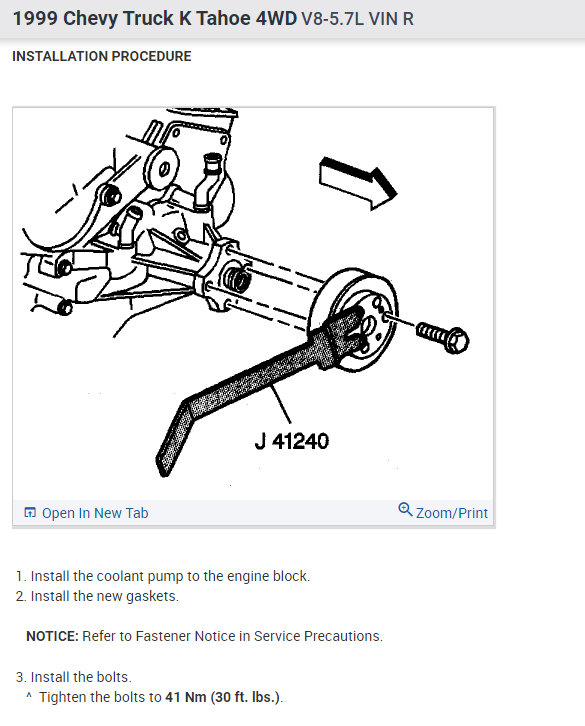

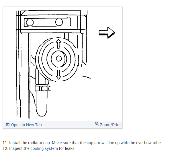

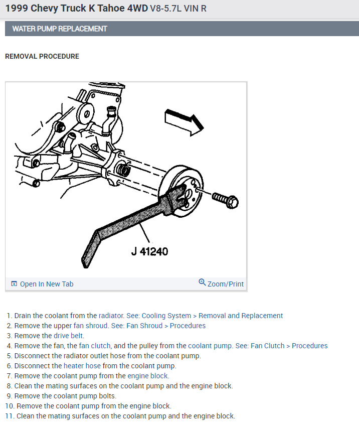

Can you help me replace the water pump?
Friday, November 28th, 2008 AT 11:50 PM
SQM
  • 6,383 POSTS
The water pump can be replaced in just a couple of hours depending on your comfort level.
Be sure to only work on the coolant system when the engine is cold.
Also drain the coolant before getting started.
You might find these articles helpful:
https://www.2carpros.com/articles/water-pump
https://www.2carpros.com/articles/water-pump-replacement
