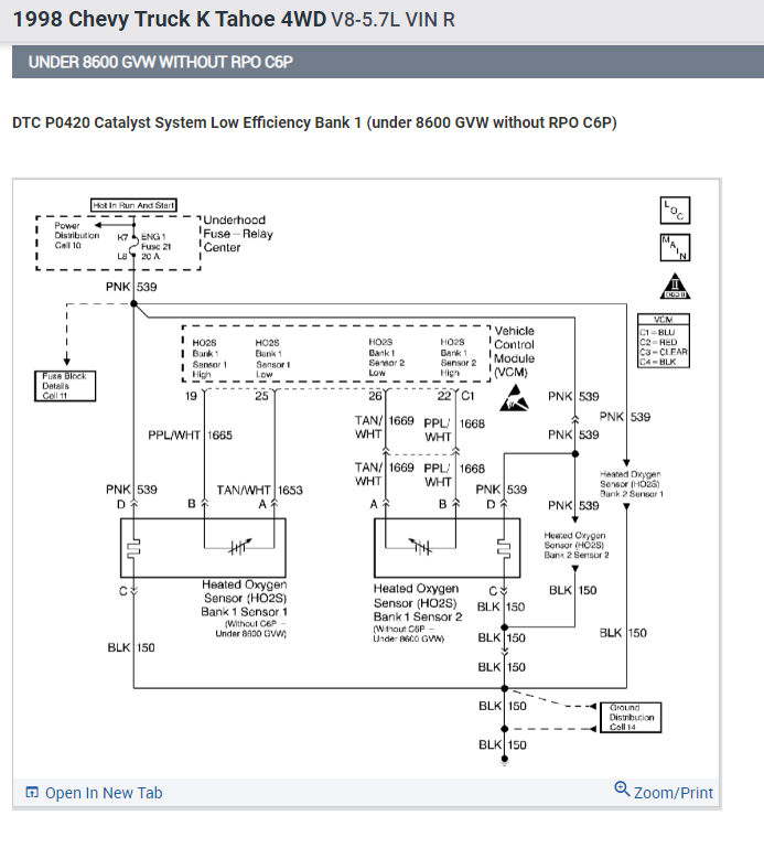

My 1998 Chevy Tahoe have the Check engine Light on. I used my Global OBD 2 code Scanner. The lecture said: Catalyst efficiency Low, Below threshold.
The Tahoe runs good. What the problem? Do I have to replace the catalyst comverter?

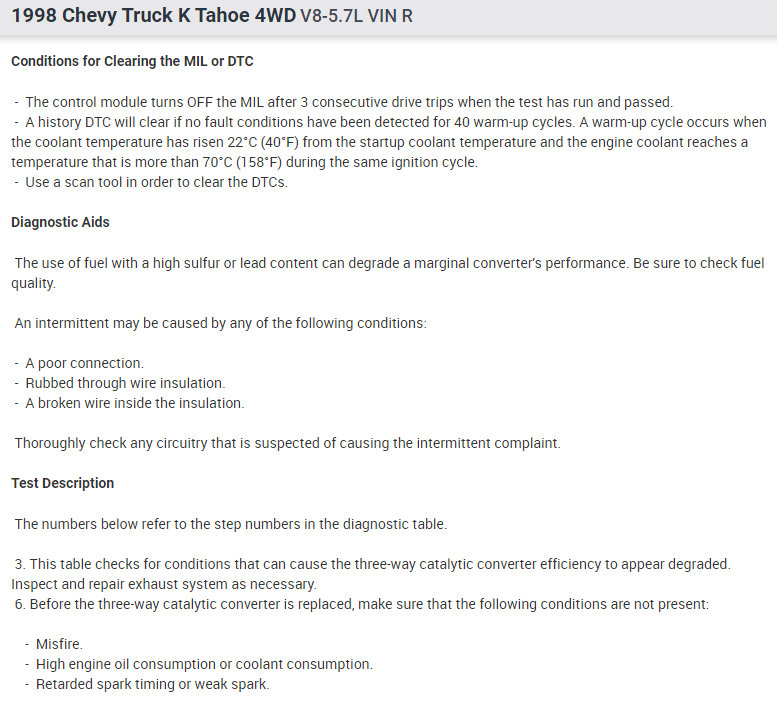

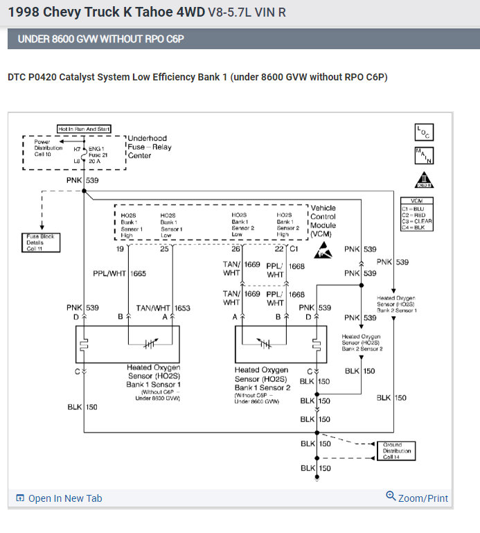

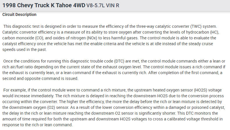

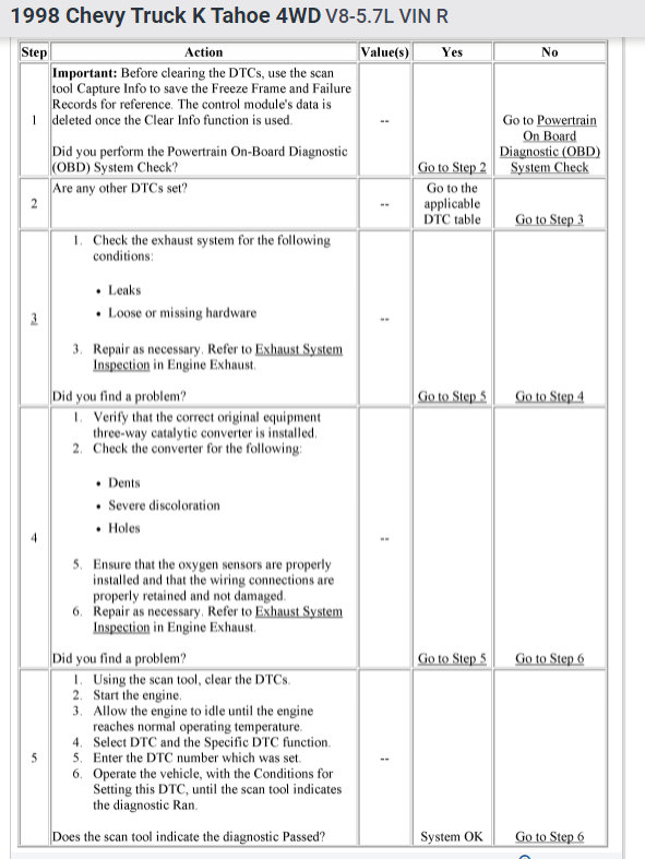

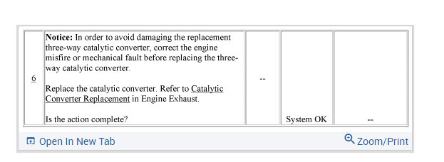

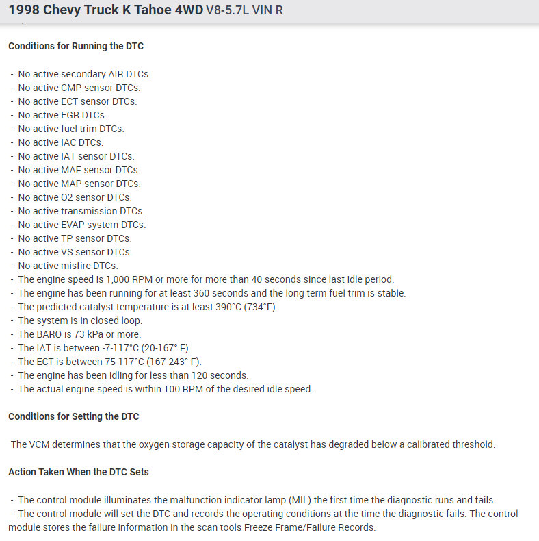

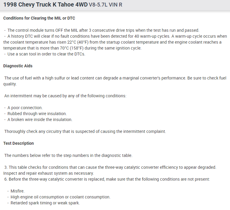

The code:
P0420 Catalyst System Low Efficiency Bank 1
This could be triggered due to few factors. It can be due to a bad catalytic converter. It can also be for a leak in the system, also can be a bad oxygen sensor.
https://www.2carpros.com/articles/how-to-test-an-oxygen-sensor-02-sensor
https://www.2carpros.com/articles/how-to-replace-an-oxygen-sensor
https://www.2carpros.com/articles/catalytic-converter-replacement
I have attached the step by step diagnostics, it can help determine the cause.
