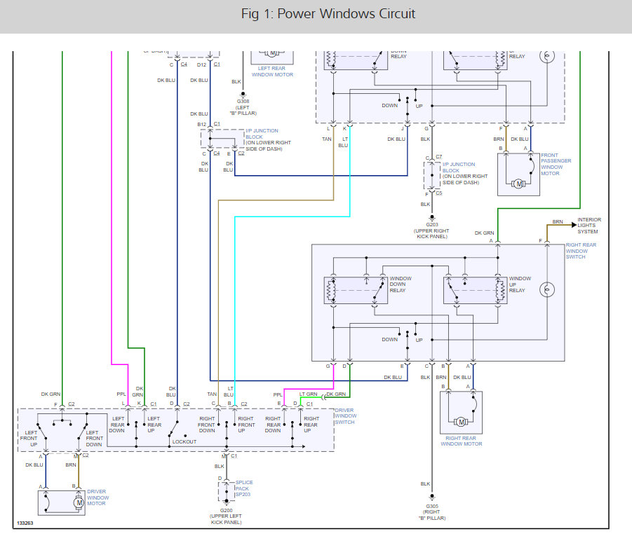

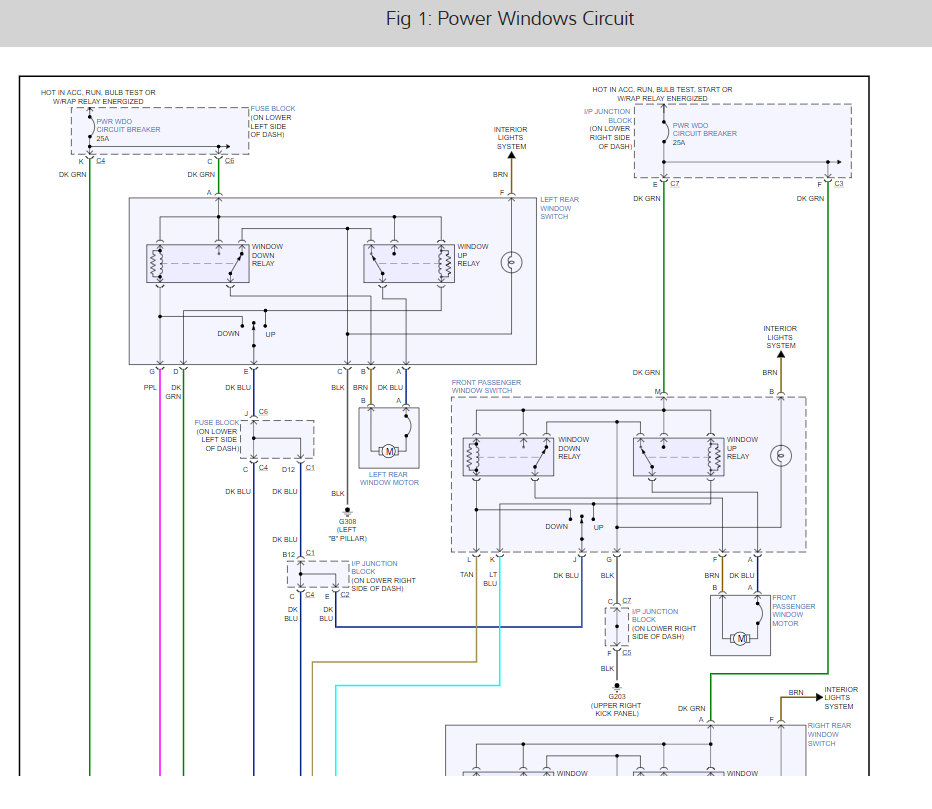

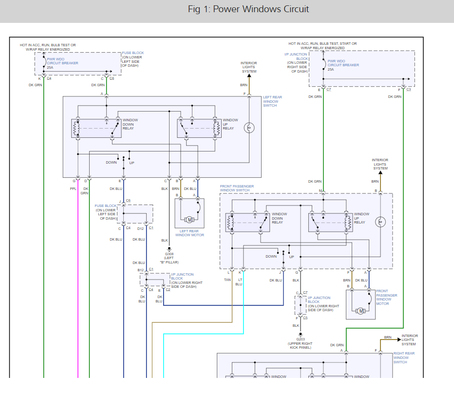

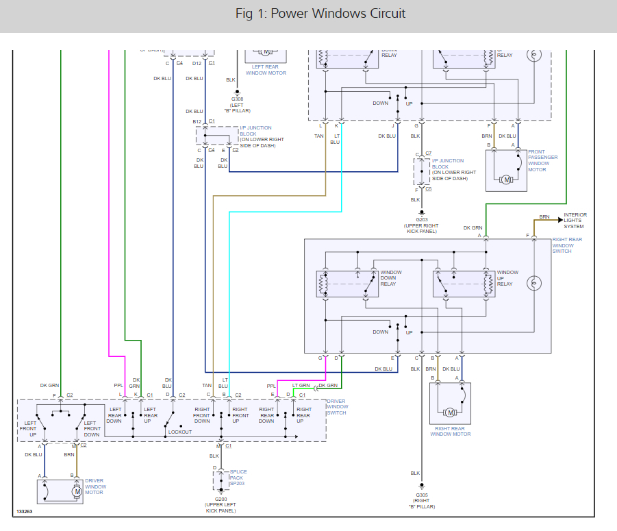

Great news! I found a Mitchel manual that didn't sell at a swap meet last year.
I looked at a Dodge Intrepid manual to verify they switch the passenger windows in the power feed circuit, but my guess was right about yours. GM switches them on the ground circuit. That really changes things.
There are relays for each passenger window, up and down, but they are built into the switches. Now I understand why their switches are so expensive. What you will find is the right windows will not work if the driver's switch is unplugged or if the master switch is turned off. Unlike most cars, there ARE separate 12 volt feed wires going into each door that do not originate in the driver's door.
Getting back to the driver's door, double-check the ground circuits. Unplug the motor, the measure between the dark blue wire and ground, and the brown wire and ground. Each of them should be no moe than one or two ohms. This will test one half of each of the two contacts. Be sure to ground your meter to the car body, not the door.
If both circuits test ok, switch to voltage and measure on each motor wire. On the dark blue wire, 12 volts must appear when you press the "Up" botton. 12 volts must appear on the brown wire when the "Down" button is pressed.
I don't see any orange wires anywhere on this diagram. If voltage is not present on the dak blue and brown wires, measure on the dark green wire. That is the feed for the, .... AHA! That's the feed for the two left side switches. There is a 25 amp circuit breaker for the right side switches. There is a DIFFERENT 25 amp circuit breaker for the left side and it feeds both of them. Here's the weird thing. There is a second dark green wire on the driver's switch that comes from the rear switch. Voltage can read through the "Up" relay coil to the left switch. A test light would be dim, but a voltmeter will read full battery voltage. I can't tell you how to tell if you're measuring on the right wire, but if you have 12 volts on both of 'em, they should be good.
If 12 volts is missing on the dark green wires on both left switches, look for the circuit breaker. You can switch it with the right one. If the right side still works, and the left side doesn't, the circuit breaker is tripping for a reason. It will feel warm too.

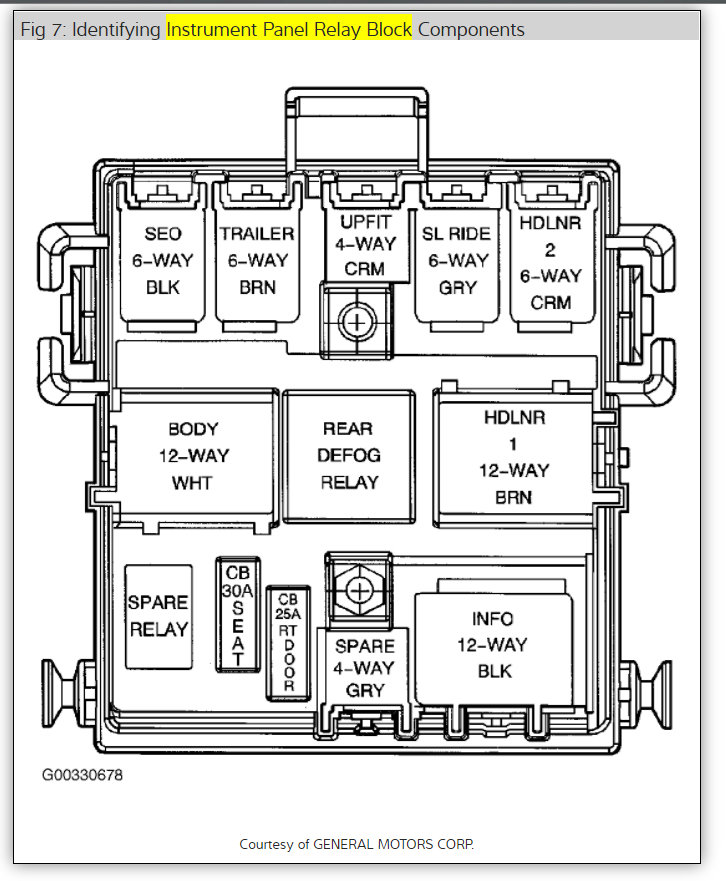

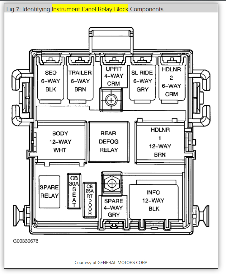

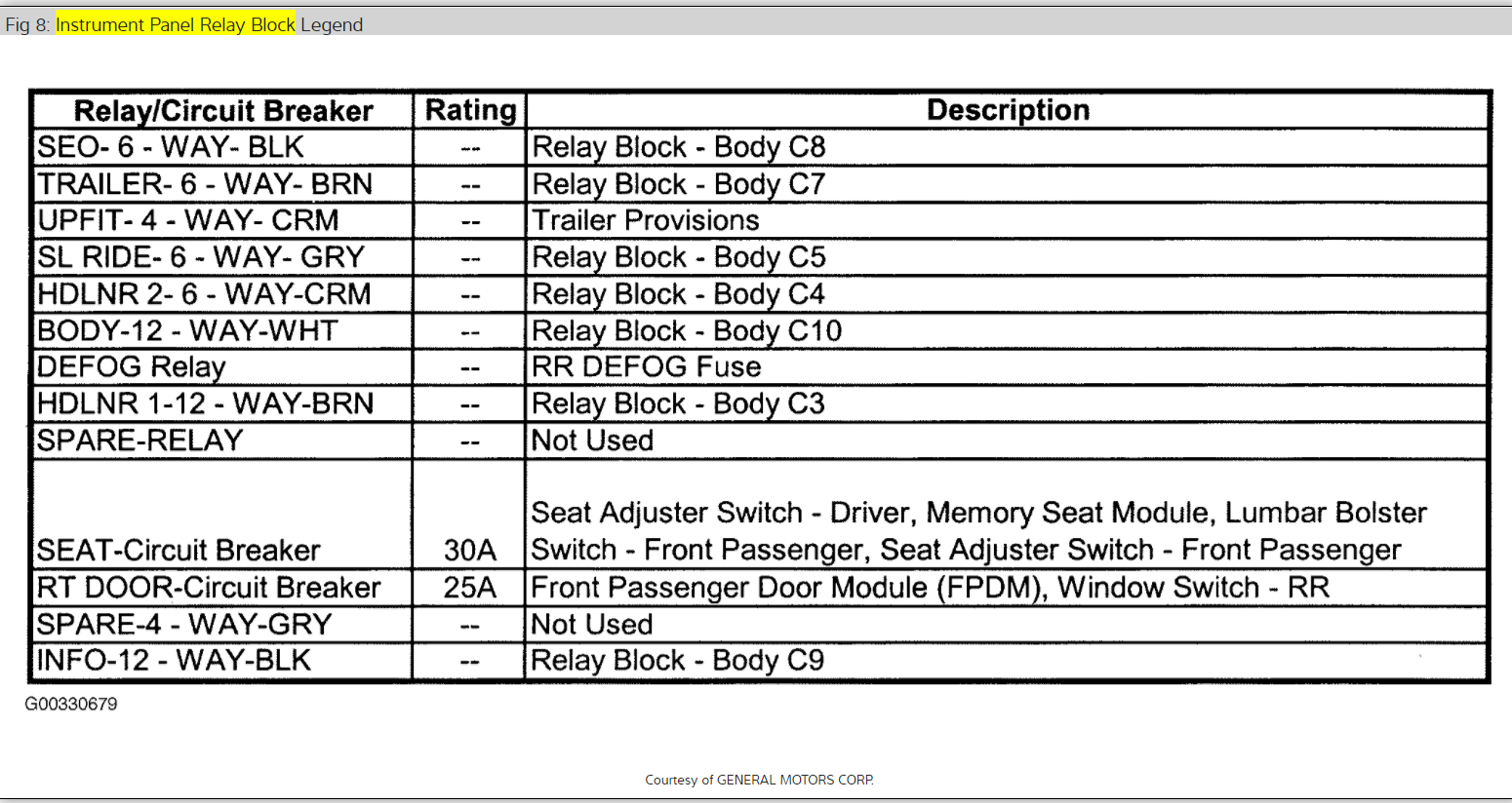

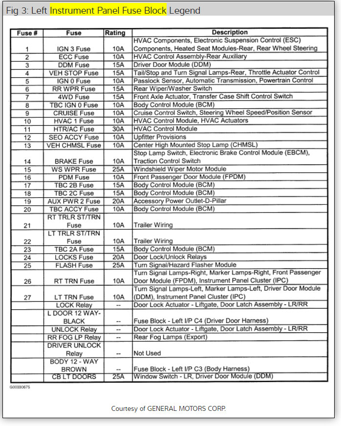

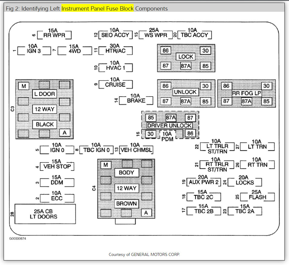

I hear you. Now the problem is I only saw 2 25 amp circuit breakers in the fuse panel and it didn't matter if I had them in or out, switched around - same right side windows work and left don't. So my deduction is I'm not looking at the correct circut breakers. Any idea where they are? Is is possible they are in the BCM?

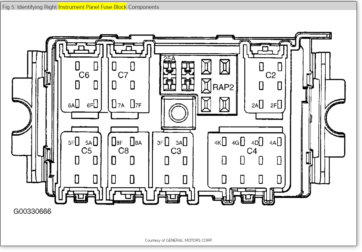

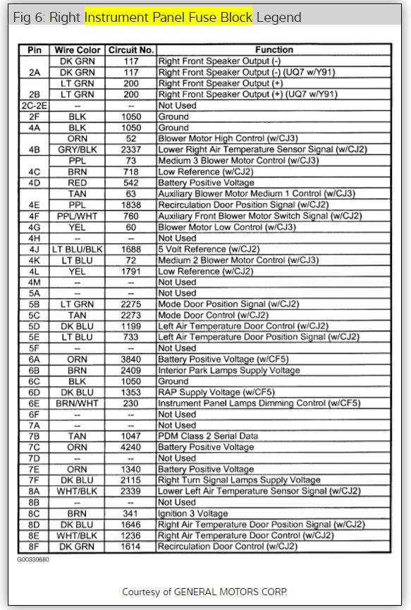

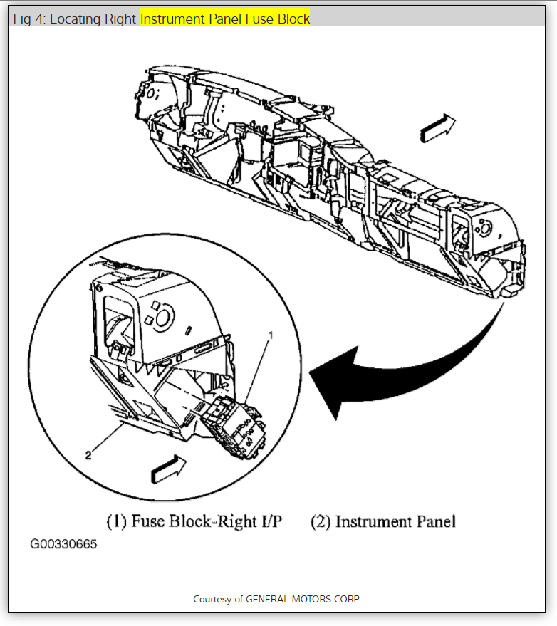

The left circuit breaker is listed as being in the fuse box on the lower left side of the dash. The right one is listed in the junction block on the lower right side of the dash. There's no reference to the Body Computer.
Caradiodoc
Tuesday, March 30th, 2010 AT 11:51 AM
BARRETTGR
  • 7 POSTS
Yes I found that one on the left. I took the right and swapped it to verify the cb was okay and it did let me operate the left side. I also verfied 12 volts at the power side of the left side cb. Very hot, like there is a short. Had to use pliers to hold it.

If either circuit breaker gets hot when it's in the left side, there is something shorted on that line. Start by unplugging the two left switches to eliminate a problem with them. There should be 12 volts on one of the dark green wires. There should be no current flow with the switches unplugged. A fast way to check is to replace the circuit breaker with a small 12 volt light bulb. The bulb should be off. If it is bright, there is a short on the dark green wire to ground. Look for frayed wires between the door hinges or pinched wires under the sill plates, or screws run through the harness under the sill plates.

Ok we got it. It was the left rear window switch. I kind of fell into it. Before today, I was testing for power at the LR switch, didn't find any so left the switch plugged in and moved to the left front. No power. You know the thread.
This time I took the LR switch out and trouble shooted the LF. Guess what. Everything worked in the LF. Then I took the RR switch since same part number and plugged it in. Now my LR window works too.
I can not see any physical or obvious damage to the LR switch but it does have a "relay looking" type box on it.
So I'll buy a new switch. Thanks for all your patience and advice.

Usually the switch does not heat up when bad it will be the motor. Can you unplug the window motors and see if the switch gets hot can you see if the relays are hot as well? Here are the wiring diagrams so you can see how the system works. Check out the diagrams (below). Please let us know what happens.
