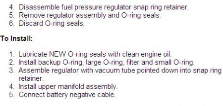

How do replace a fuel pressure regulator

Welcome to the forum.
