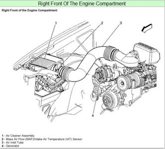

Where is the ATS Sensor located under the hood?
I have a 4.3 Lit v6

Are you looking for the Intake Air Temperature Sensor (IAT).If so see diagram below:
