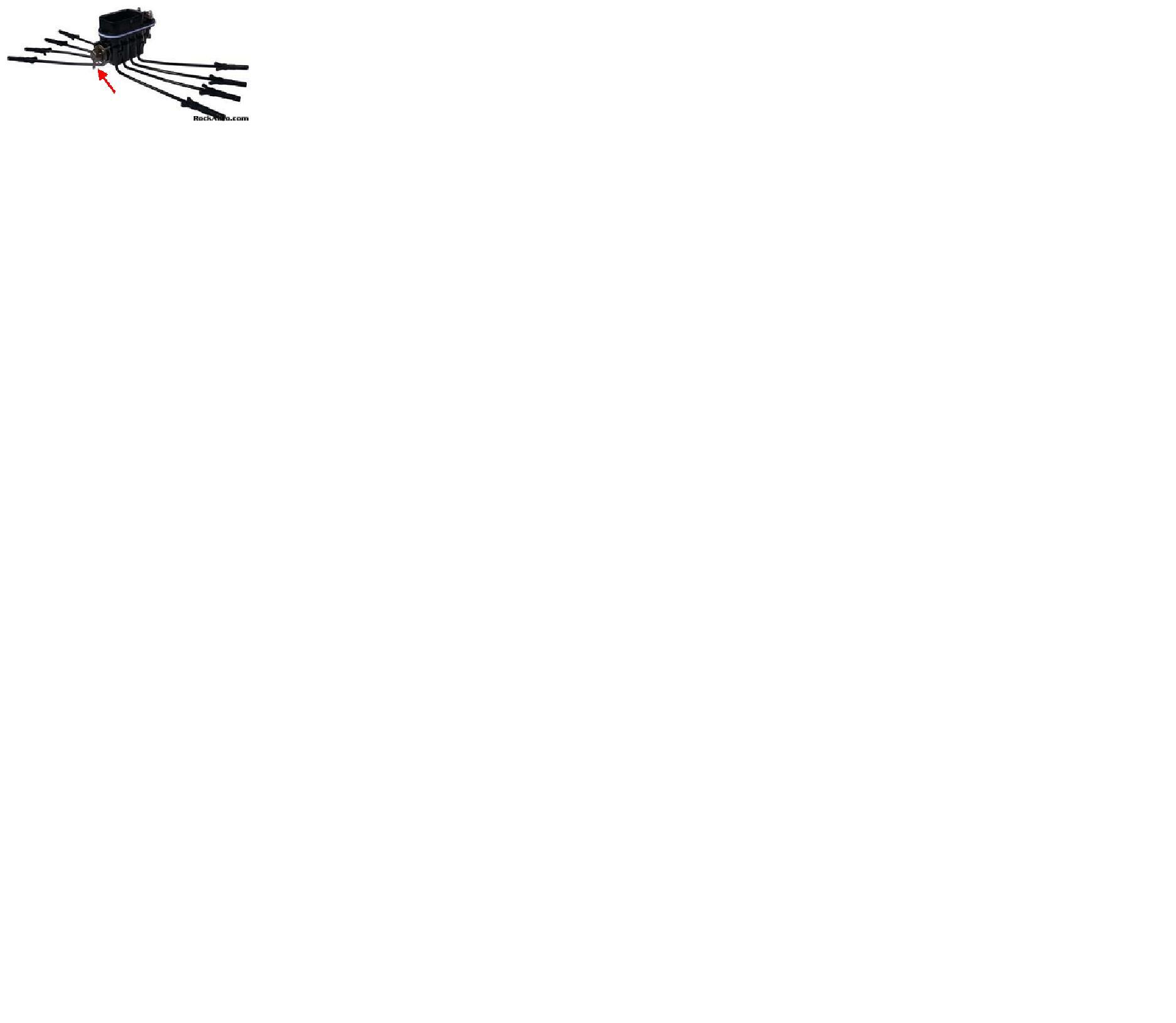

I replaced the junkie stock spider injectors and now it won't start. It's filling cylinder 7 with to much gas it hydro locks. Also had a lot of gas in the oil what is causing it. Can it be fixed of is it finally time to replace the engine?
Friday, August 21st, 2020 AT 9:41 AM (Merged)
CARADIODOC
  • 34,468 POSTS
Pull the vacuum hose off the fuel pressure regulator and check if it's wet inside. If it is, the regulator is leaking fuel into the intake manifold and needs to be replaced.
COREYLEO
  • 9 POSTS
One problem the fuel pressure regulator is attached to the spider injector unit under the upper intake manifold and when it was replaced there was no hose connected to it!
CARADIODOC
  • 34,468 POSTS
Here's a photo from Rock Auto. The red arrow is pointing to the hose connection on the regulator.
